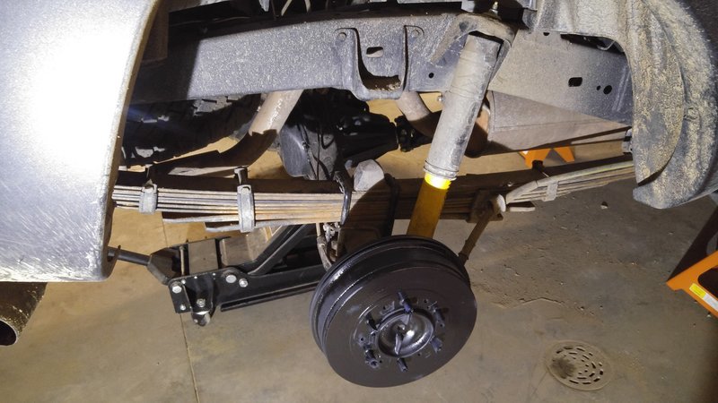

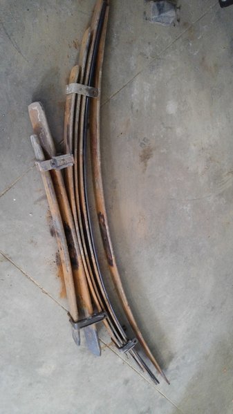

    Installed the AAL this evening.
    It was nice and warm outside, which meant melting snow, on the driveway, which meant mudding on the way up. Perfect, a nice coat of mud on my work area!
    Decided to paint the high performance rusty drums so I didnt cringe every time I looked at the back wheels.
    The hardest part was getting the centering pin to line up with the hole in the axle mount. Great advice was learned... use a ratchet strap to pull it if you can, or loosen the other side U bolts and it'll move!
    Time to go test it out in Utah this weekend.
    This was adding the D29XL AAL to the OME Dakar Pack. I only needed the leaves, the centering pins were plenty long enough... theres still a good amount of threads above the nut.

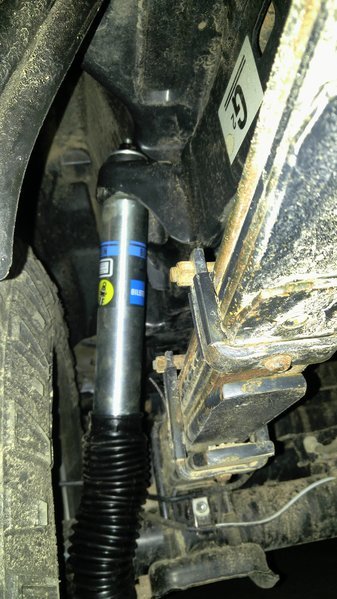

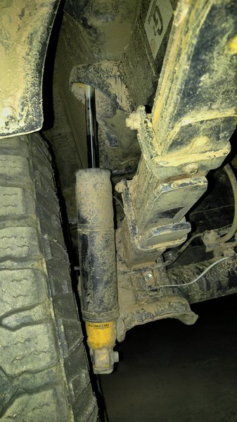

    A week or two ago, I heard a strange clanking sound. Thought it was the Hi-lift on the roof banging around a little.
    Nope
    The threaded part of the shaft snapped off leaving the top of the shock loose and bouncing around in the mount.
    I thought about going with a longer shock. But then that meant more expensive shocks, bumpstops, brake lines, so I just went with a replacement for what was on there.
    Went with Bilstein 5125 SERIES 236.5MM SHOCK
    4wp had them the same day, they were the correct measurement and valved for the heavier loads I carry.

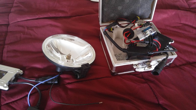

    The time has come for a little extra LIGHT!
    No aftermarket front bumper to put them on, and dont want them on the roof, so they'll have to go in the grill. I have slotted metal for the grill that I'll cut out around the lights, but trying to now decide on lights.
    HID's seem superior for light output/distance vs LED's. Lots of youtube videos out there of lights with HID bulbs in them putting out some crazy light.
    KC Apollo Pro lights have been mentioned a few times. I like them, other than the fact that the rock guard is part of the light so you cant take it off. I guess I could paint over the KC part of them to make it less noticeable.
    Hella Rallye 4000's have also been mentioned.
    Trying to decide if I still want to go with a spot/pencil beam or go with a driving/spread/euro pattern. I'm also thinking that I could put two spots, with a driving light in the middle to cover all bases. Which means I'll need to do a little testing before I cut up the new grill mesh!

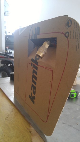

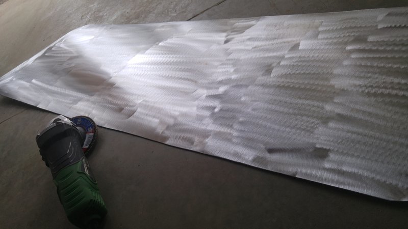

    Getting back on the topper panel build.
    Ordered a part that i should've ordered a while ago so i can build it out as needed. But I guess i can start drilling it out for the mounts after i get it painted.
    Slashaar and alee891 like this.
  10. Mar 5, 2017 at 12:50 PM
    #170
    Stig
    Stig [OP] Resident smartass
    Feb 22, 2015
    #149340
    13,182
    Brandon
    Ta no mo
    Moar sneak peeks.
    Locking water tank filler goes on the bottom (ordered), QD will be for water hose/faucet. QD will be recessed enough to not stick out. And switch will turn it on/off (secondary switch is inside bed to give this switch power).
    Was originally going to put the panel on with rivets. But I'm thinking I'll drill out the holes in the panel, through the topper and then have aluminum/steel strips that are tapped for the screws to secure it and it'll be removable for future additions.
    Still thinking a narrow weatherproof, locking box would be a great addition for random items. But unless i find one soon, it'll be one of the later additions.
    It'll be wrapped in gloss black to make it look like a window and hopefully not noticeable.

    :eek:
    Going to take a little modification. But I'll do one, test it side by side vs the halogen, then decide where to go from there. Maybe I'll start on it tonight.

    The lights come as halogen and going to put the hid in them. But I'll leave one as halogen to see the difference for the light testing before i convert it as well.

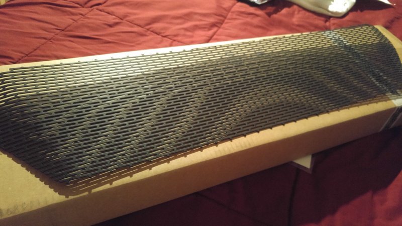

    Apparently it's my trucks birthday month, not mine.
    Got this from Customcargrills.com since I'll be gutting the grill to make room for lights.
    Great customer service, emailed them late at night, got a real quick response, then managed to mess up the address and they got that fixed on the fly. Grill was nicely packaged.
    Unfortunately it'll be a minute before i install it since I'll be cutting holes in it for the lights, which I'm not sure if I'll be going with two or four at this point.
    Also ordered a camera module thing so i can add a front camera... And a few more extra to the stock headunit. The original solution that i found on the forums was well over $200... And i didn't need a camera that bad. This was half that (group buy going on right now on the site).
    Now just searching for a camera that works decently for the front as well as ones for the sides.
