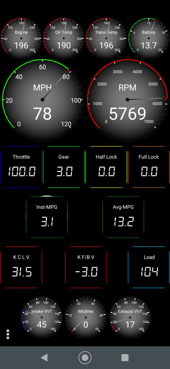

    AJ
    WI
    2017 TRD OR : M+W Nexus Tuned
    Tune: Nexus +P Add ons: +3" custom suspension 295/70/18 Yokohama M/T Tires KMC XD Grenade OR wheels KN intake Blackhawk MBRP Exhaust TJM Rock Crawler Bumper Lighting (+10 H.P.)

    AFR?

    You should log in techstream. The phone apps have massive lag that loses tons of data.

    We're crossing our fingers that VF will have the needed PID's in the near future. It's much easier to log with VF than TS, lol.

    Changes have been made to AFR.

    stock cooler? I assume you aren’t taking a pic of the first WOT :D
    Mooseditty17[QUOTED] likes this.

    Cooler?
    Certainly not the first time she's tickled 6500+

    TS is now and real. It’s not that hard. Use it.

    I'm not sure Karl, but from the #s I'm seeing, we must be getting DAYUM lucky logging and making changes with such shit software.
