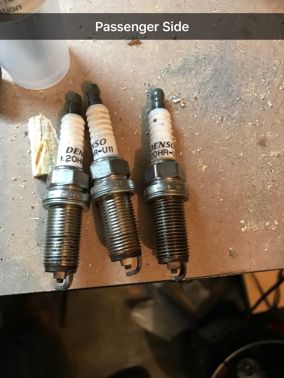

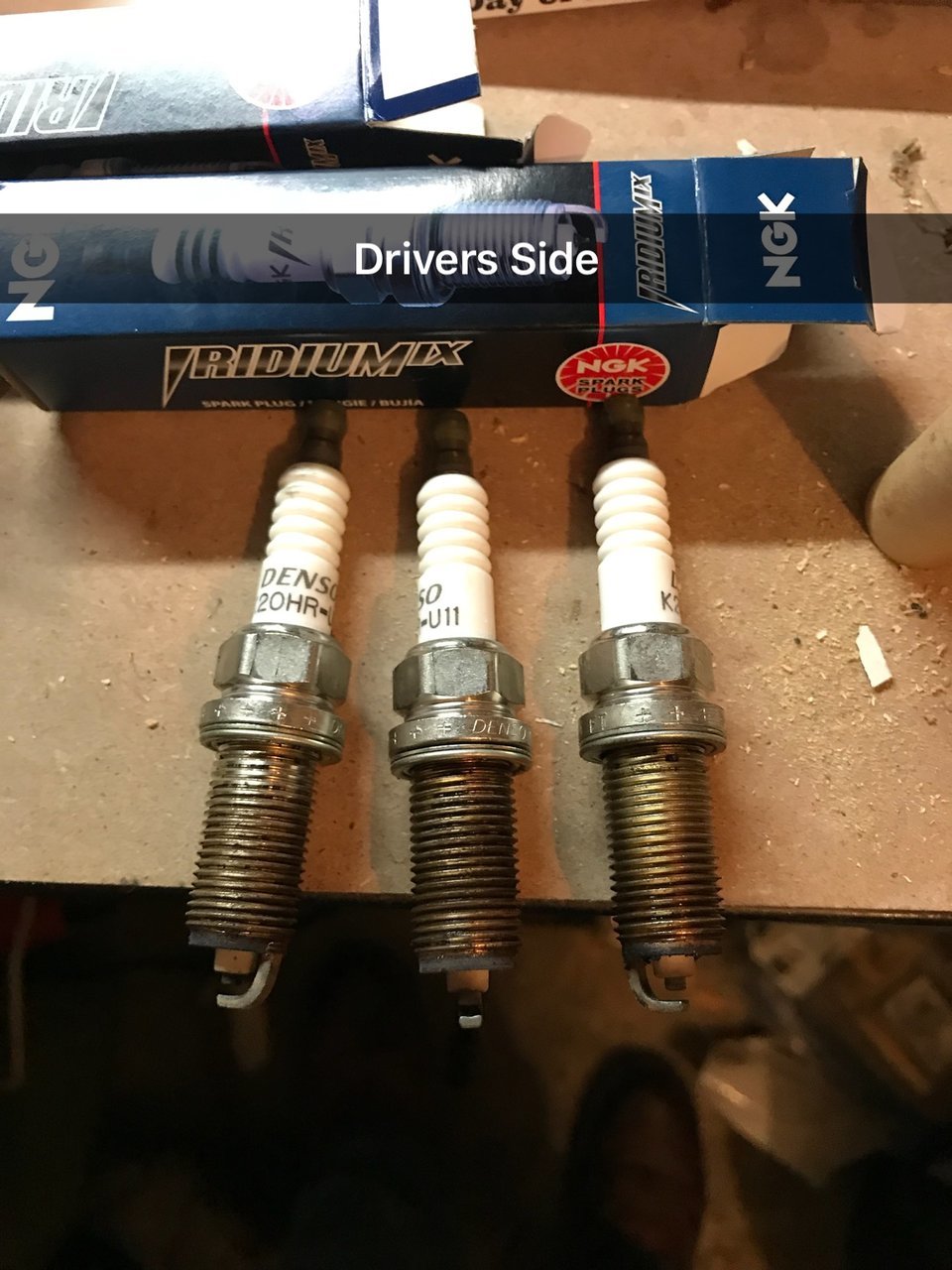

    Well here’s the result, looks like to me the previous owner changed them out, but when I drove it after I put the new ones in it didn’t do anything, it ran fine, should I change out the coils just to be safe?

    Could all that oil on the threads of the plug on the right side of the top pic be indicating a problem? Maybe me but is the insulator darker too?

    Threads do look more oily than the others but the tips look normal. Could just be thread lube used by previous owner, or camera angle. One of mine looks shiny also; switched these out 3 week ago and all look the same but for the pic.
