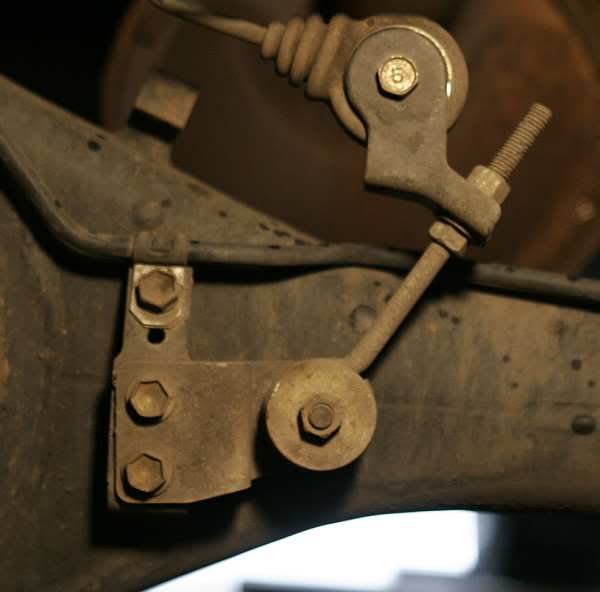

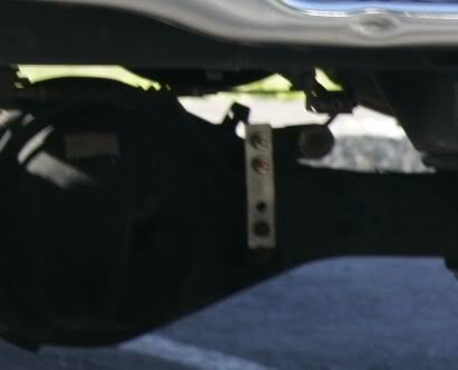

    Are you still stock height? No Lift? If your rear springs are stock it is possible that your rear brakes are not fully engaging because of the BPV. You might try raising the arm a bit to get the rear brakes to engage sooner. Almost as it you have a small lift installed. Raise it by 1" to see if it has an impact. Raising it will cause the braking balance to increase slightly in the rear. Here is a pic that shows the bracket you would raise.
    _MG_0141_f1edb32c2748d2690d8ec7a8881b9bf878b6451f.jpgHere is a pic of the bracket mount raised for 2.5" lift. That would be too much if you are srock. Try raising it by 1" first to see if you can "feel" any difference.
    BPV = Brake Proportioning Valve. Follow the arm back to where it attaches to the valve.
