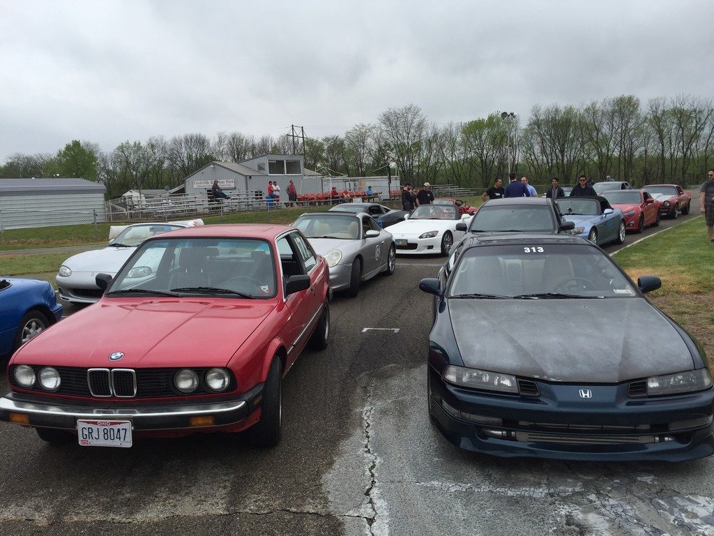

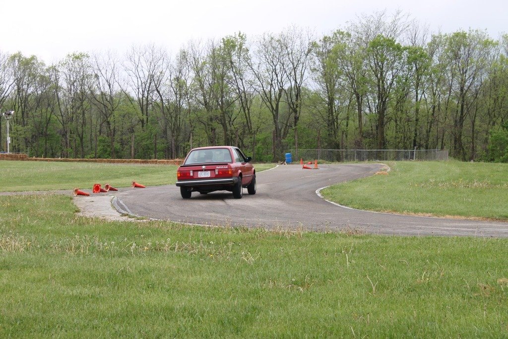

    Well autocross went about as good as expected. Got two runs in before the car broke :laugh:
    Turns out the crank pulley bolts had worked themselves loose (I think I was supposed to locktite all the pulley bolts on this stupid engine lol). This caused it to throw both the power steering belt and the alternator/water pump belt off. I got a new alternator belt from vatozone and threw it on after tightening the bolts down again but ran out of time to run again.
    I learned a couple things: this thing needs better brakes sooooo bad, this thing needs suspension sooooooo bad, and it also needs tires.

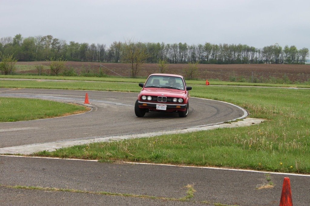

    Just a bit of body roll lol
