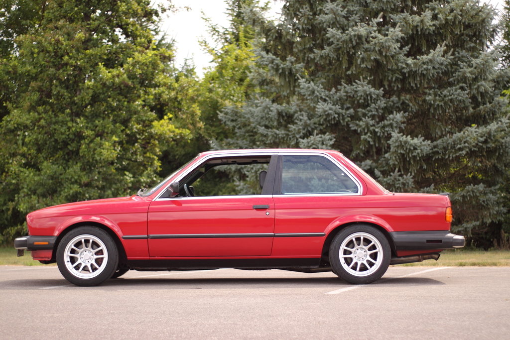

  6. Jun 2, 2016 at 6:36 PM
    #66
    steve o 77
    steve o 77 [OP] braaap
    Nov 29, 2009
    #26726
    19,917
    Steven
    In a corn field, OH
    1990 Chevy Siveraydo
    245k+ miles, rust, working AC, bald eagles

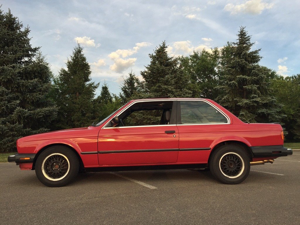

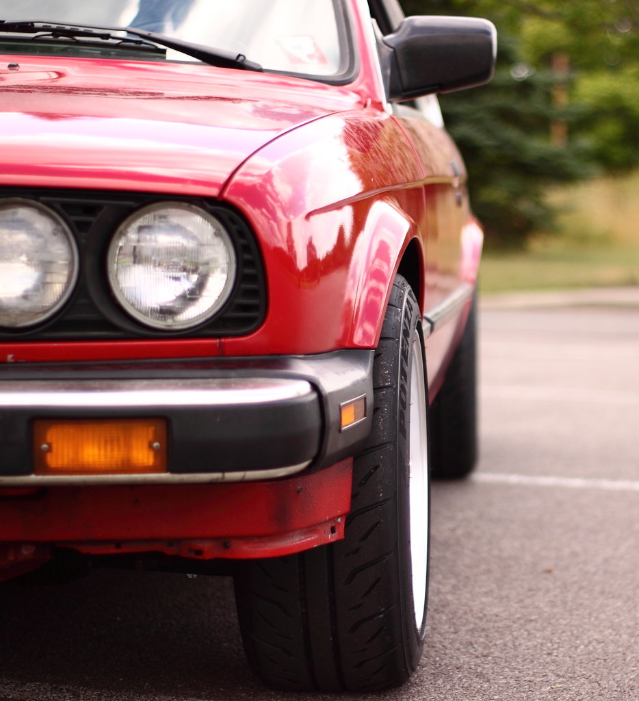

    Thanks guys, hopefully it spools even faster once I get around to getting it properly dyno tuned.
    So I finally bit the bullet and ordered suspension, wheels and tires.
    The wheel/tire combo is nothing special, TRM C1's in 15x8 with 205/50r15 re71r's.
    For suspension I got koni yellows, ie3 springs (should lower it about 2-3"), bigger adjustable sway bars, poly bushings for subframe and trailing arms, solid front lower control arm mounts, camber plates and a kit to make the rear camber and toe adjustable (involves removing the subframe and welding adjusters to the mounting points for the trailing arms).
    Should be sitting much better fairly soon.

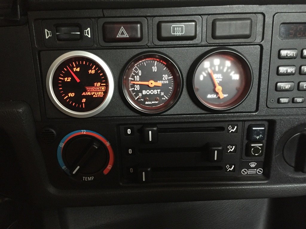

    Finally got some gauges installed. Don't mind the fogged up oil pressure gauge, no clue why it did that...

    Nice, im assuming thats a single DIN plate that replaced your radio? i want to do the same kinda thing

    Yes the car came with the radio removed and this blank plate in its place. I just took a hole saw to it.

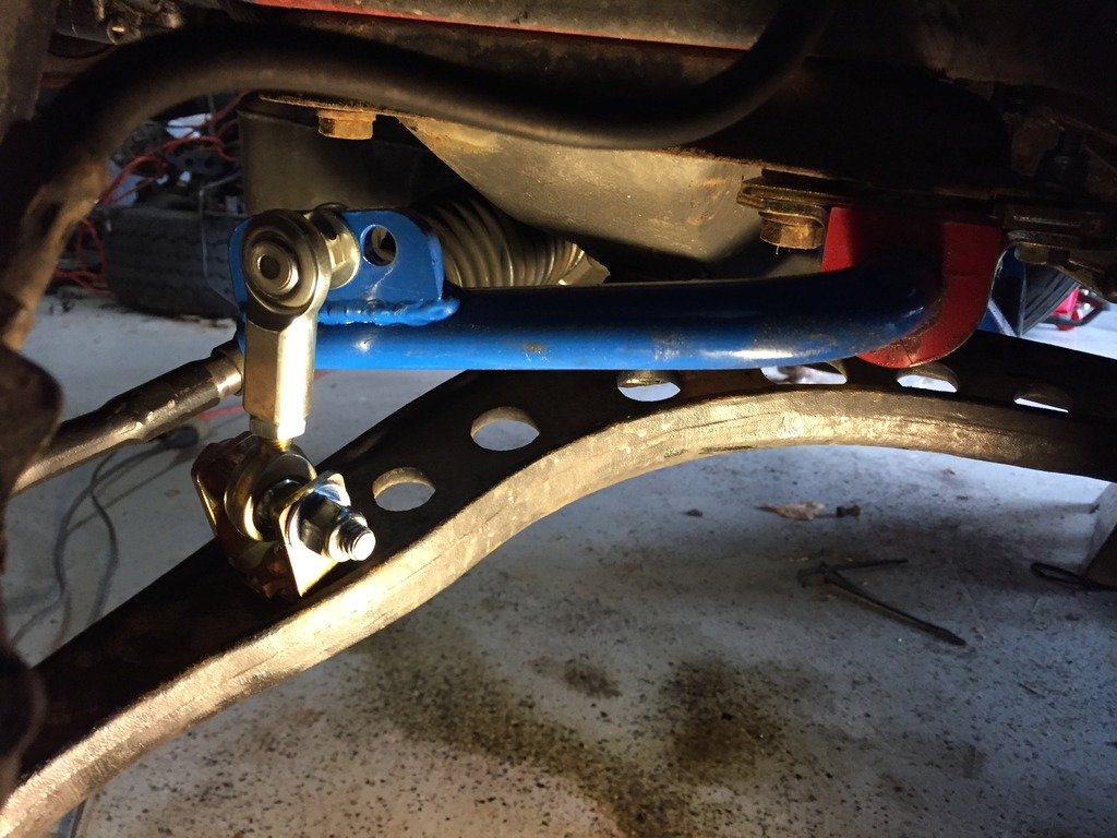

    Ok suspension upgrades are under way.
    Front is done. Strut tubes were pretty rusty but I got them apart with a week of pb blasting and some map gas torch action. Wheel speed sensors also came out without incident.
    IE3 springs
    Koni yellows
    IE camber plates with new oem top mounts
    Bimmerworld solid offset delrin Lollipops
    Ie 22mm bar
    Rear is up next, kinda dreading dropping the subframe and dealing with those bushings.

    Ok suspension is done for the most part, just need to align it and get IE to actually send me the correct end links for the rear sway bar. I just have it unhooked for now.

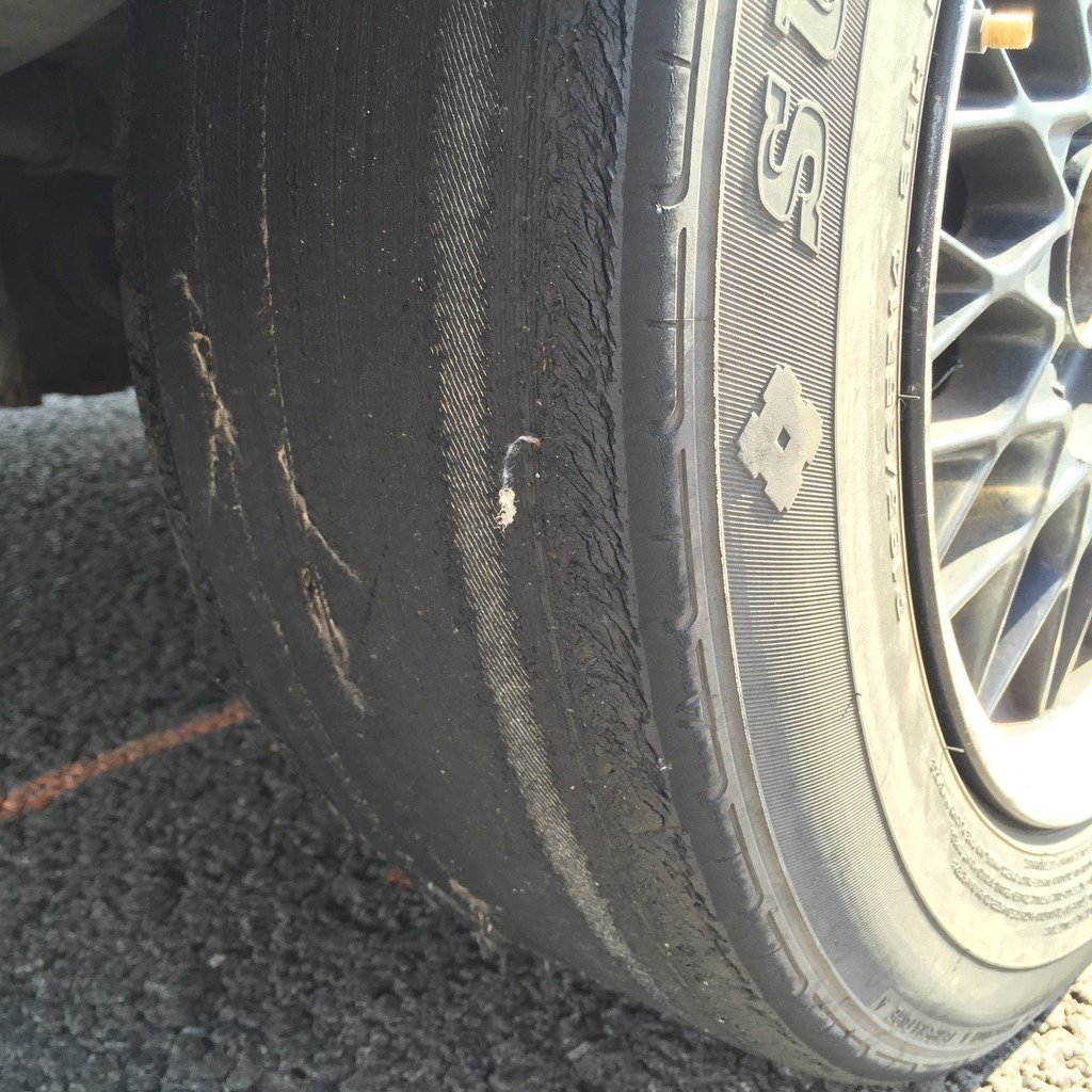

    Took the car out to Pittsburgh last weekend for my first drift event ever. Learned a lot and the car did great.
    I was running some $20 used sumitomos from 2003 on the rear.
