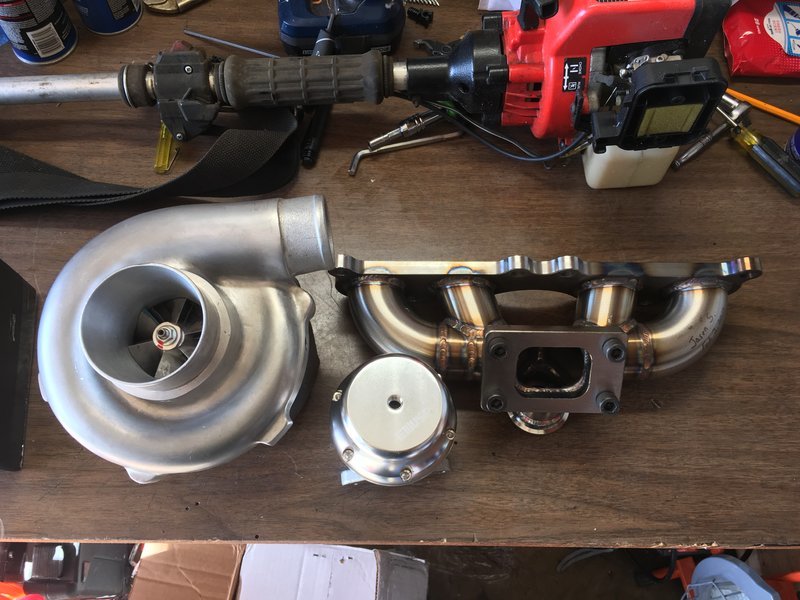

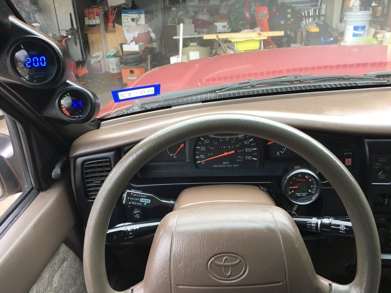

    IMG_5336.jpg IMG_5340.jpg I bought the turbo from Jimountain on customtacos. Manifold is being built and coming soon. This is all happening so fast. I was planing on taking a little time just to make sure everything is right. I got the gauges in today just need to hook up the air/fuel gauge(narrowband)to get started and here is what I'm starting with.

    Here's what I got so far. I'll have to get an adapter for the wastgate vianda to bolt onIMG_5363.jpg

    Wastgate is 2 bolt and flange on manifold is v band so I'll need to get an adapter and it doesn't have a place for EGR so I'll have to do the EGR delete.

    would it not be easier to just get a vband wastegate? save some space too, which is a pretty big deal on my truck anyway
    MarX and Jstand[QUOTED][OP] like this.

    Yep I'll be returning the wastgate and get the v band

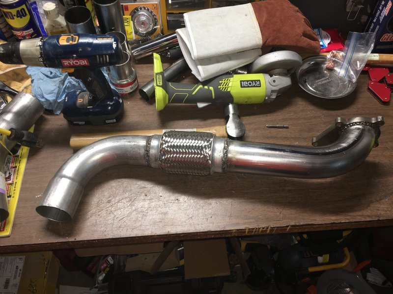

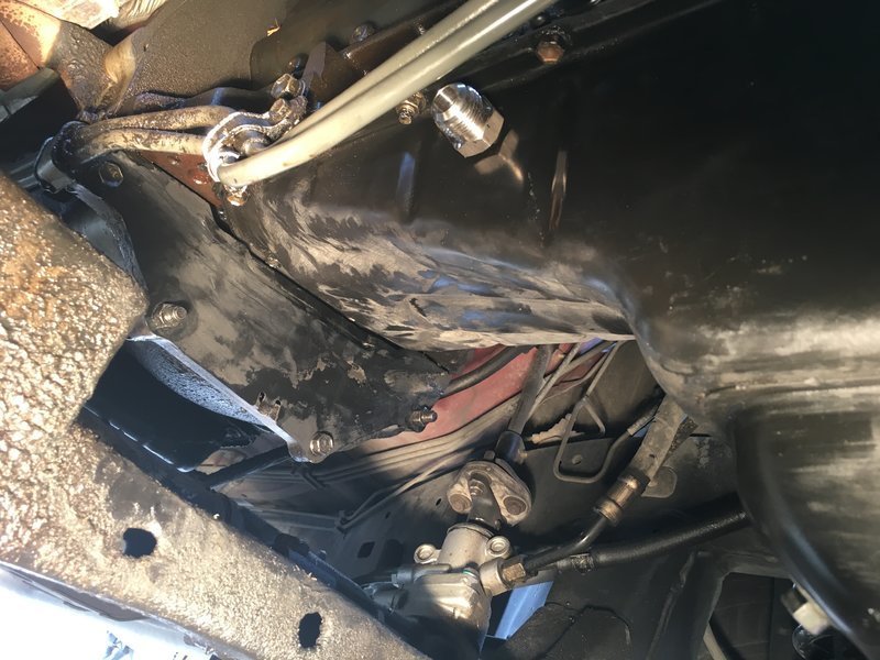

    IMG_5448.jpg IMG_5449.jpg Turbo update : I installed the oil return in the oil pan today and got excited about welding and welded the downpipe the only problem is it's slightly off and it's touching the header does anybody know if this would be a problem well I need to start over

    Well I don't think that the header and the downpipe will rub a hole in each other because they shouldn't move against each other so I won't worry about it

    Id wrap it and that will atleast coushin it some. My down pipe just touched my frame and i wrapped it i think it will be fine... If it isnt its post turbo so oh well

    I would guess it may depend on how much it's rubbing. Like @yota243 said, some heat wrap may minimize the rubbing
