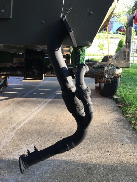

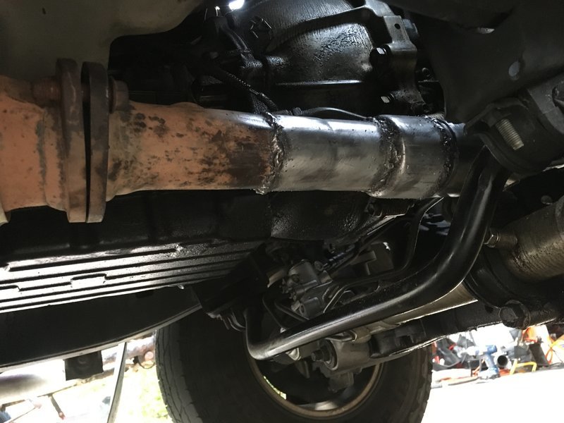

    IMG_5478.jpg IMG_5480.jpg Well after lots of recutting and re welding I think I got it. Question though do I need to paint it before wrapping it IMG_5479.jpg
    yota243 and MrCrowntown like this.
  6. Apr 1, 2017 at 6:55 PM
    #86

    I would paint to prevent rust. I used high temp header paint I found at Vatozone. It's held up well
    Jstand[OP] likes this.

    If it is mild steel, definitely paint it.
    Coming together well. You'll be boosting in no time!

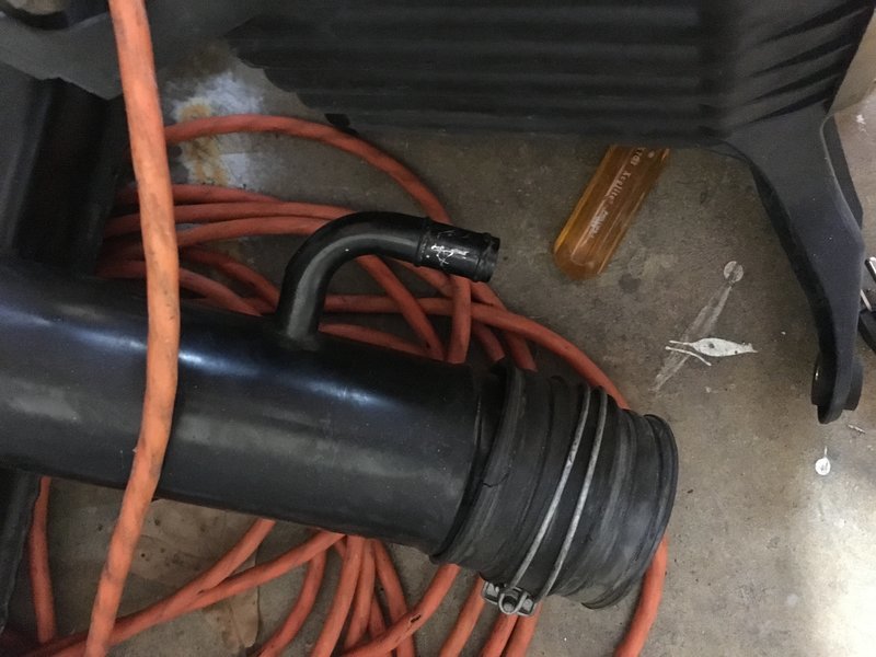

    And pipe is painted now to wrap it but I wonder if 15' is. enough IMG_5483.jpg

    Looks sweet! Nice work

    Are you only wrapping the downpipe? You might just have enough to do that

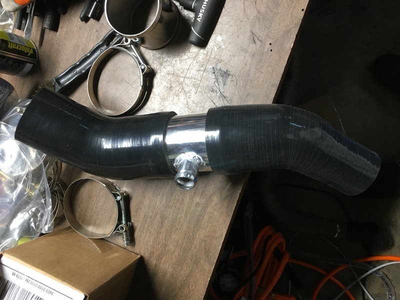

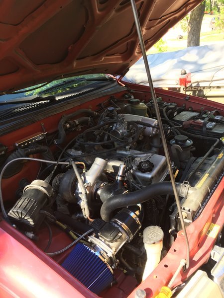

    Next challenge I need to reincorporate this pipe back into the piping.IMG_5489.jpgThis is the pipingIMG_5488.jpgThe peice between the silicone tubes is aluminum so I can't weld it but I was thinking to make a hole in the silicone pipe that the metal tube would fit snugly into and put the Toyota fipg around the outside. Would this work?

    Whats the pipe for??

    He needs the pipe for idle air control. The fpr and evap I just vent to atmosphere.
