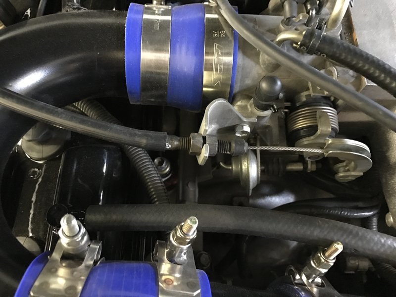

    Torspd Custom Turbo kit [] Borg Warner 9180EFR Turbo [] Haltech Elite 2500 [] TiAL Q BOV [] TiAL V44 Wastegate @ 15psi [] CP Pistons [] CP Carrillo Rods [] ARP Head studs [] ARP Main Studs [] ARP Header - Head Studs [] Ported Heads w/ 1mm oversized valves intake/exhaust [] Brian Crower Forged Stroker Crank [] Darton M.I.D. Sleeved Block [] Kelford Camshafts [] Torspd 160* T-stat mod [] APR Large Fuel Rail [] Walbro 460 LPH E85 Fuel Pump [] FueLab FPR [] APR T56 Conversion Kit [] KP RACING Built T56 [] McLeod Racing Custom Twin Disk Clutch [] One Piece Aluminum Driveshaft [] MGW Shifter [] Custom lowering kit [] Ohlins Front Coilovers [] QA1rear shocks [] Custom Ron Davis Radiator [] Dual SPAL Electric Fans []
    I HIGHLY recommend re routing that oil line, but especially the MAF wire loom. Being that close to the turbine housing, will damage the wires.

    As far as the oil line what would be the best route to go?

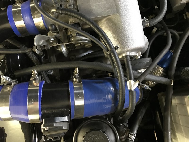

    IMG_5507.jpg IMG_5506.jpg IMG_5504.jpg Ok ready for first start I'm a bit nervous about the vacuum lines. On the vacuum block the main line is tied into the intake and brake booster.From the vacuum block one line goes to the BOV, one line goes to the wastegate on the side one, line goes to the boost gauge the other line on the wastegate I think it's a vent it comes out of the top

    You need to cap off the vac connection on the side of the TB that goes to the front part of the valve cover. Otherwise you'll put boost into your crank case and blow oil out of your oil cap. You can either put a breather filter on your valve cover or connect it to a vac only source. I teed mine into the vac system that hooks up the the Intake pre turbo. I had read online somewhere that the backs cover needs a small amt of vac. That why I did it that way
