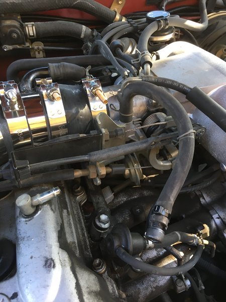

    Scary it went up to 11 and I wasn't even all the way in it I don't know the RPM because the tech stopped working i'll check some things tomorrow and let everybody know

    That just made a huge vacuum leak. At least have a hose on there, folded over and zip-tied.

    It looks like he has a bolt stuffed in the end and zip tied. Should hold for a temporary solution

    Now I understand what you were talking about I have melted plastic I'll re rout the wires and oil line tomorrow.

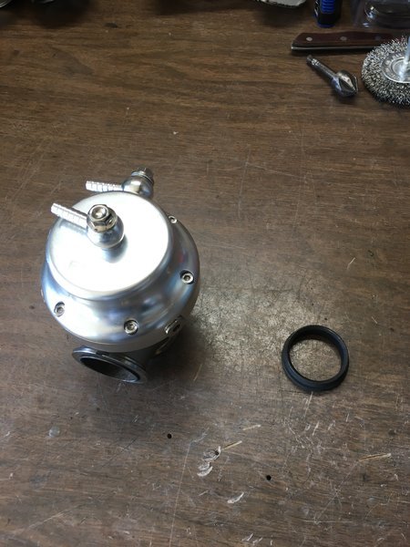

    I left the top outlet of the wastgate to vent to atmosphere is this ok ?

    Yeah the other one can be used for a vacuum port with a 4 port boost controller.

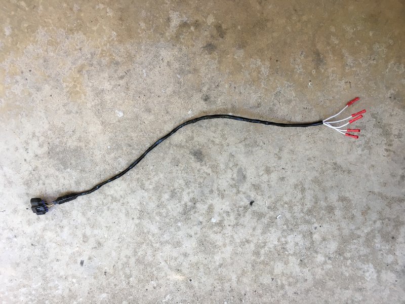

    IMG_5509.jpg :thumbsup:Wires not melted had to make a homemade extension for the maf sensor harness

    I had to Springs in the wastegate I took one out it wasn't the softest but now I'm seeing 13 PSI could I have the wastegate hooked up wrong or is the top outlet of the wastegate supposed to be hooked up to a vacuum source too ?

    You should have just the bottom port connected and the top one vented to atmosphere if your just running the WG with no boost controller. Keep swapping the springs til you get the PSI you're looking for

    Yeah I'm just gonna have to put the softest spring in and see what happens thanks

    image.jpg Is this ring supposed to go in the end of the wastegate on the manifold side because it seems like it pushes it open a little bit but if it seals then I guess it's

    yes it has to go in there, I think mine also pushes on mine (like I would say 1/16" or less) I feel like its just enough to keep everything in place and keep tension on it. I may be wrong but that's the way I have been able to sleep well at night
