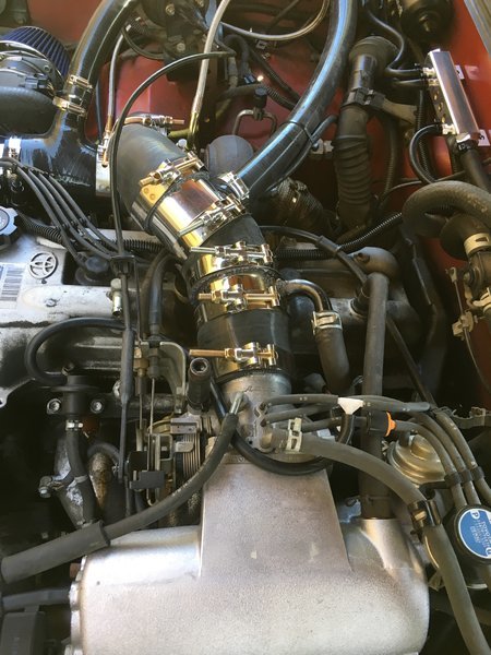

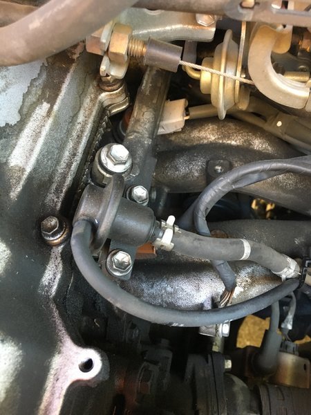

    IMG_5501.jpg So I put the resistor in the connector for the EGR and the check engine light comes on and still. Does anyone think it IMG_5502.jpg could be one of these two things here

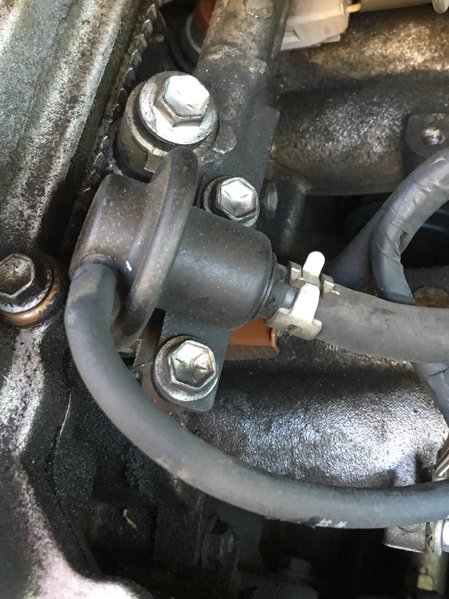

    Where do you have that Vac line from your FPR connected to?

    Does this need to be hookup to something

    That's why your running lean. You need to hook that up to a boost referenced source. You can use one of the 3 points on top of your throttle body. That is what tells the FPR to up the fuel for boost

    You can get rid of one of the vac hoses that comes from your EGR valve and cap it off at the EGR. Then hook up your FPR vac line to the nipple on the throttle body that you opened up by doing that. Your EGR won't care since you have the resistor installed now

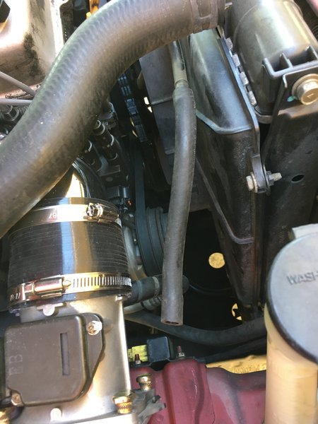

    Yeah you should be good now. Kind of scary thinking you were making 10+ psi with your FPR not hooked up!

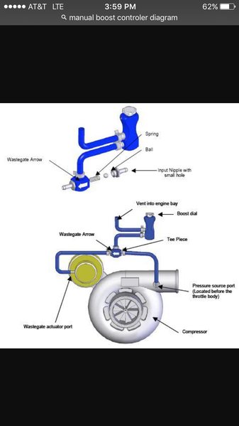

    The same as this diagram accept the pressure source is the intake manifold Brake
