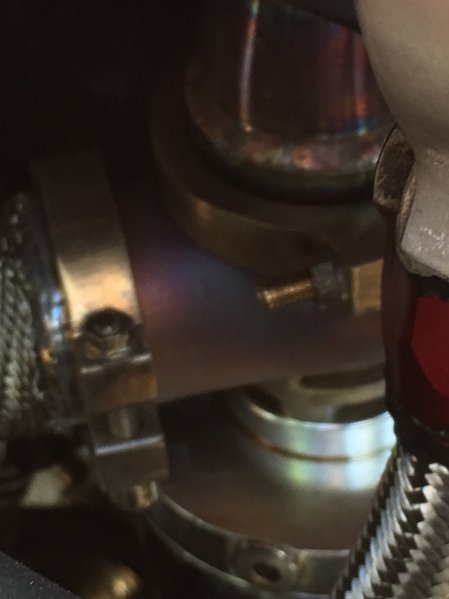

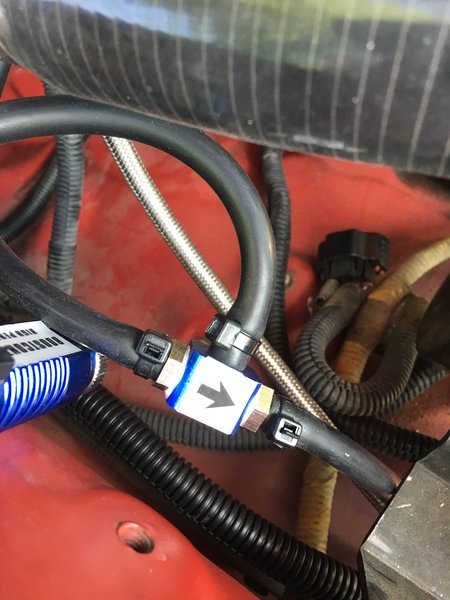

    So I took this T fitting/check valve apart in the spring that's in there was stuck open with the sealant that was used to put it togetherimage.jpg

    I haven't adjusted the BOV yet I wonder if that might have something to do with

    Wow! Good find.

    That is normal due to the heat saturation.

    Well it looks like I'm learning the lesson of the Ebay wastegate. It was stuck open and the diaphragm looks like it got too hot. I'm thinking to buy a good one instead of another eBay one

    Precisely the reason why I was asking earlier. Certain parts you can cheap out on. Others you cannot.

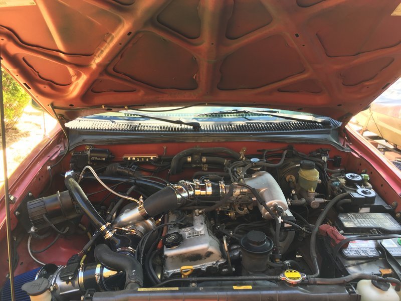

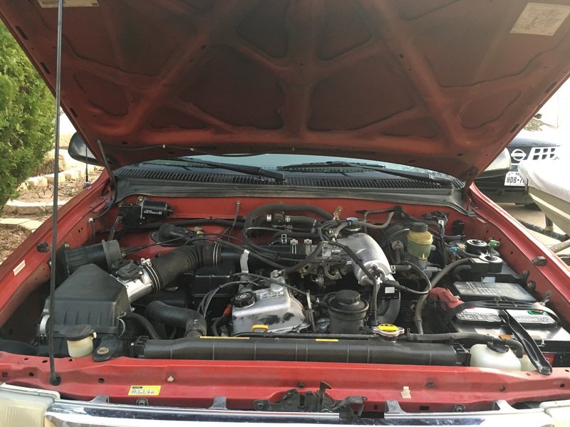

    After

    What is that ~1.5" pipe that t's into the intake between the maf and turbo?

    ^^^ What he said, and where is the other end attached?
