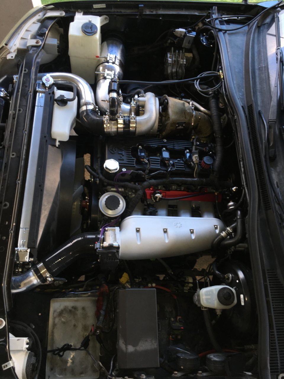

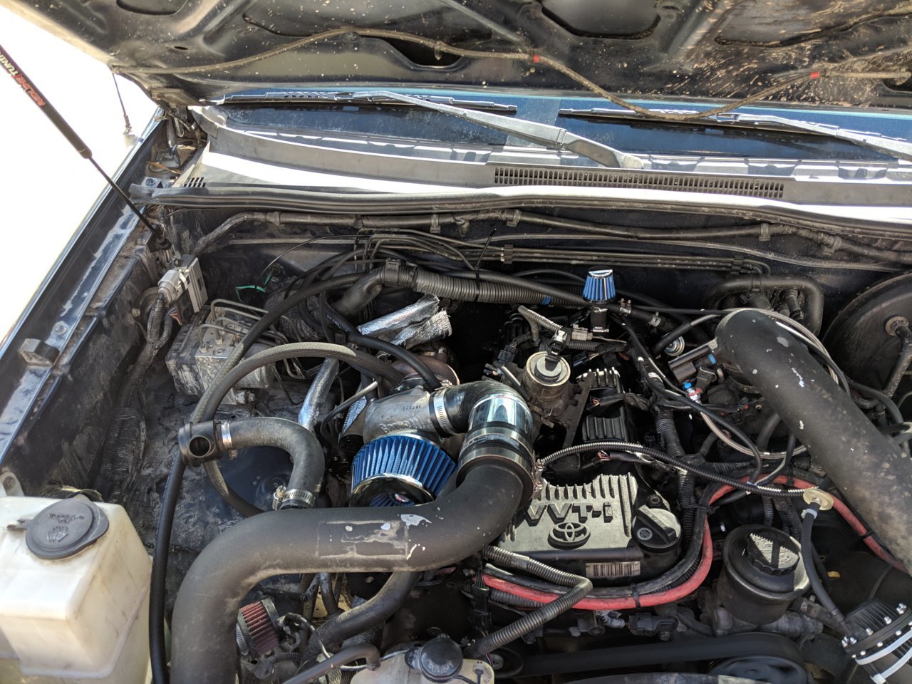

    I didn't either so I read read read, watched online tutorials/videos and followed Turbo BS thread for a while to supercharge... ended up using too small a supercharger and then tried my hand at turbo. I'd copy my kit for you but don't think I can get another exhaust manifold, was a stroke of luck the company made it for me slightly different than they usually do [they aren't inclined to make one off pieces, only sell what they have on hand].

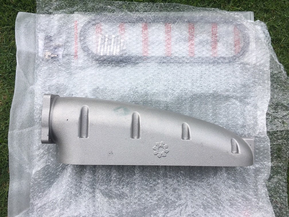

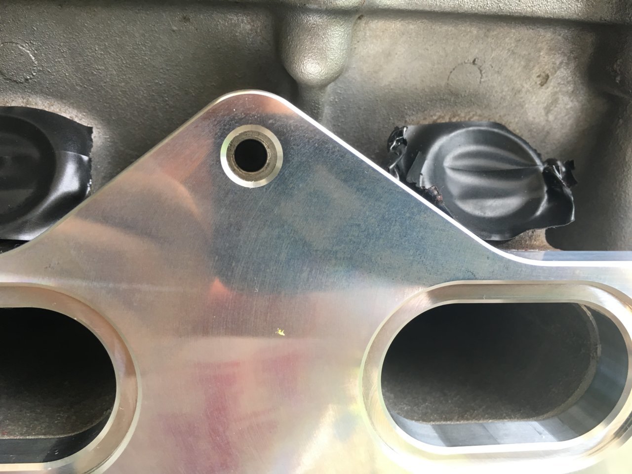

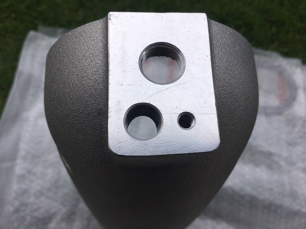

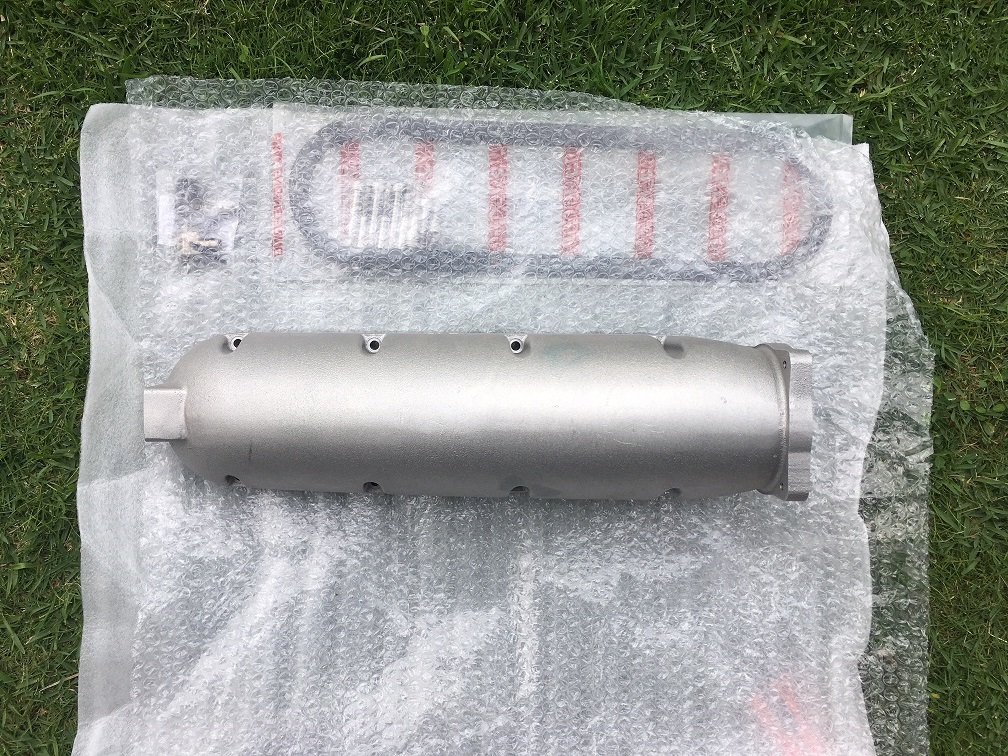

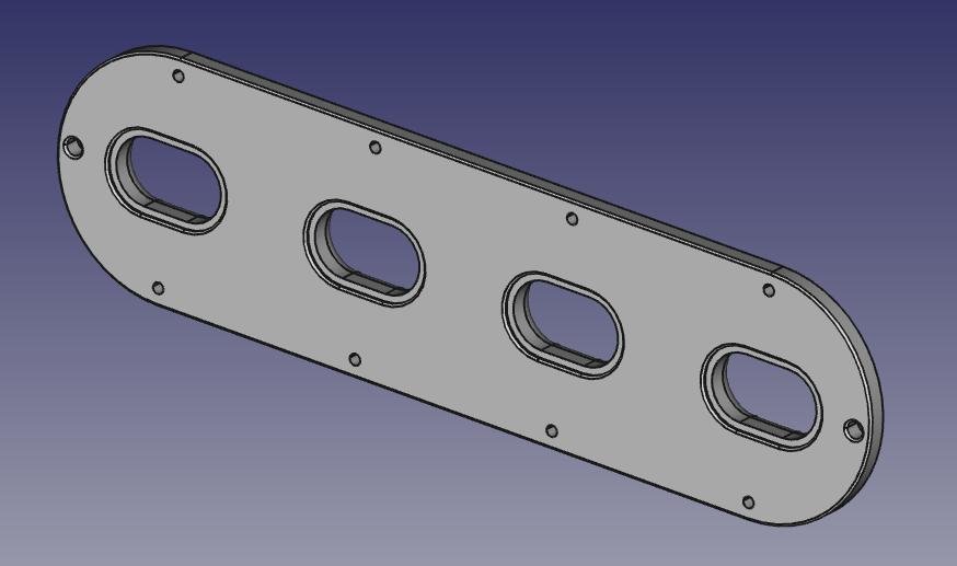

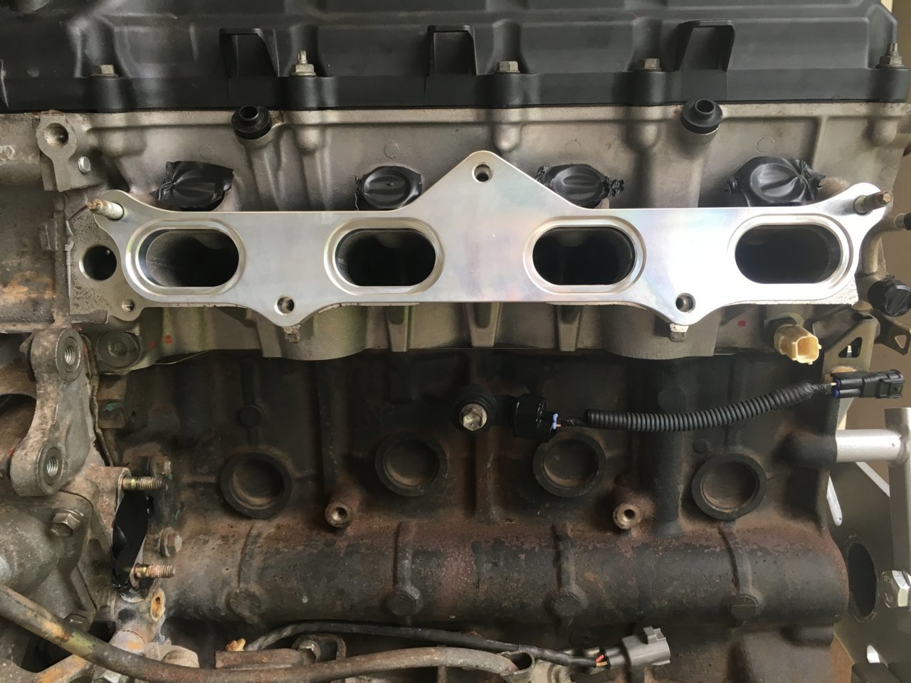

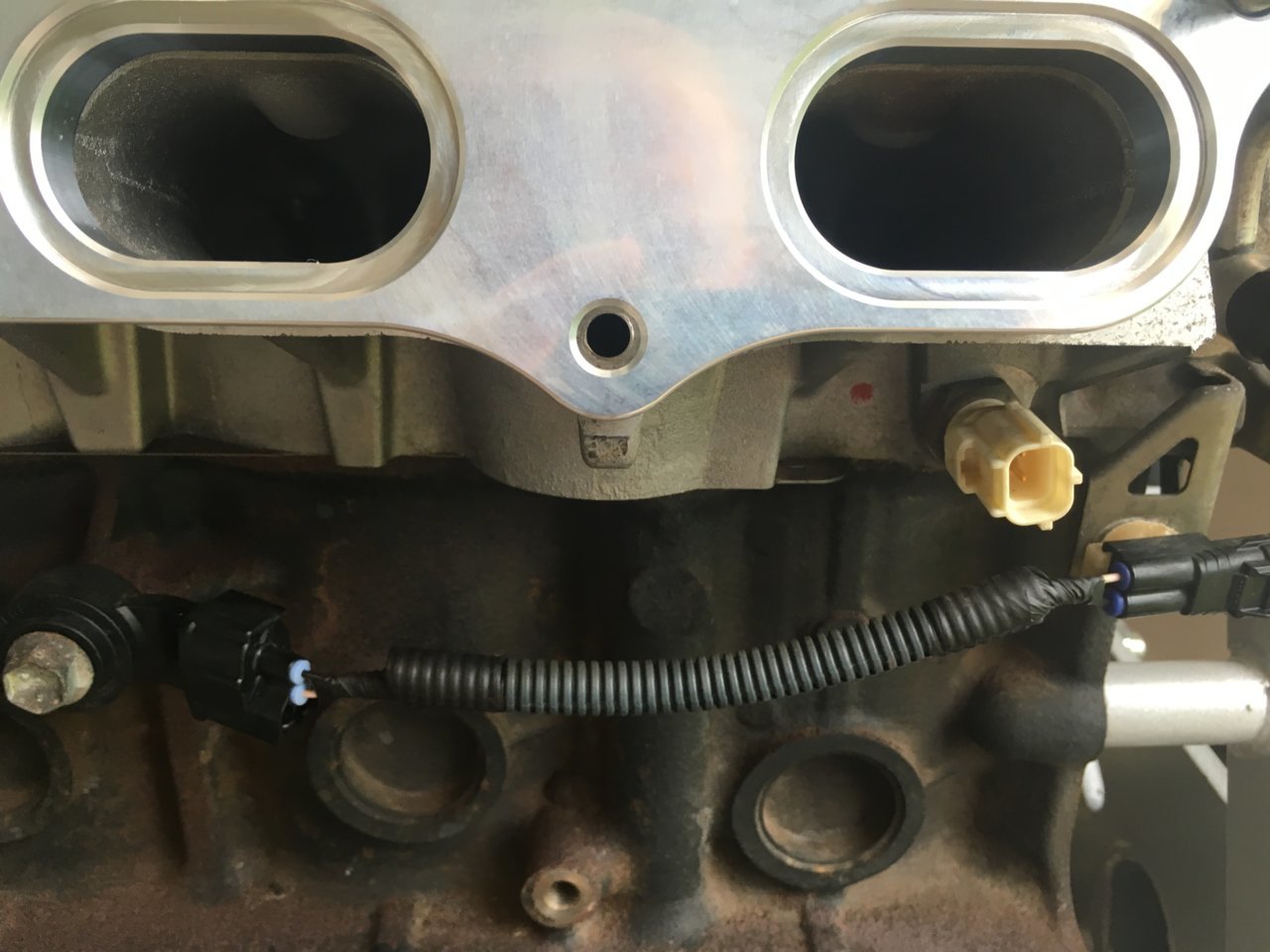

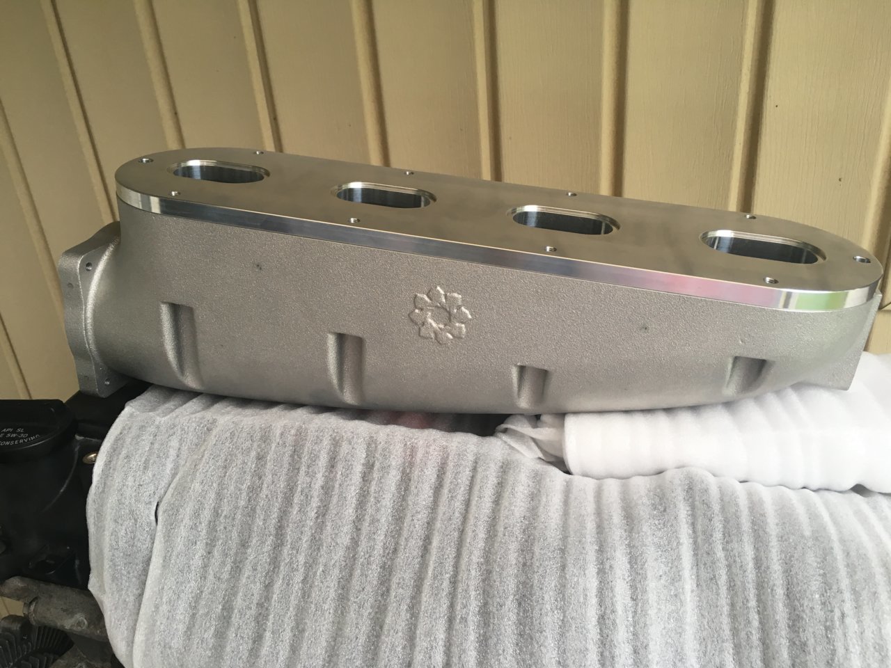

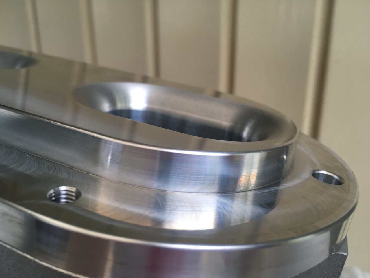

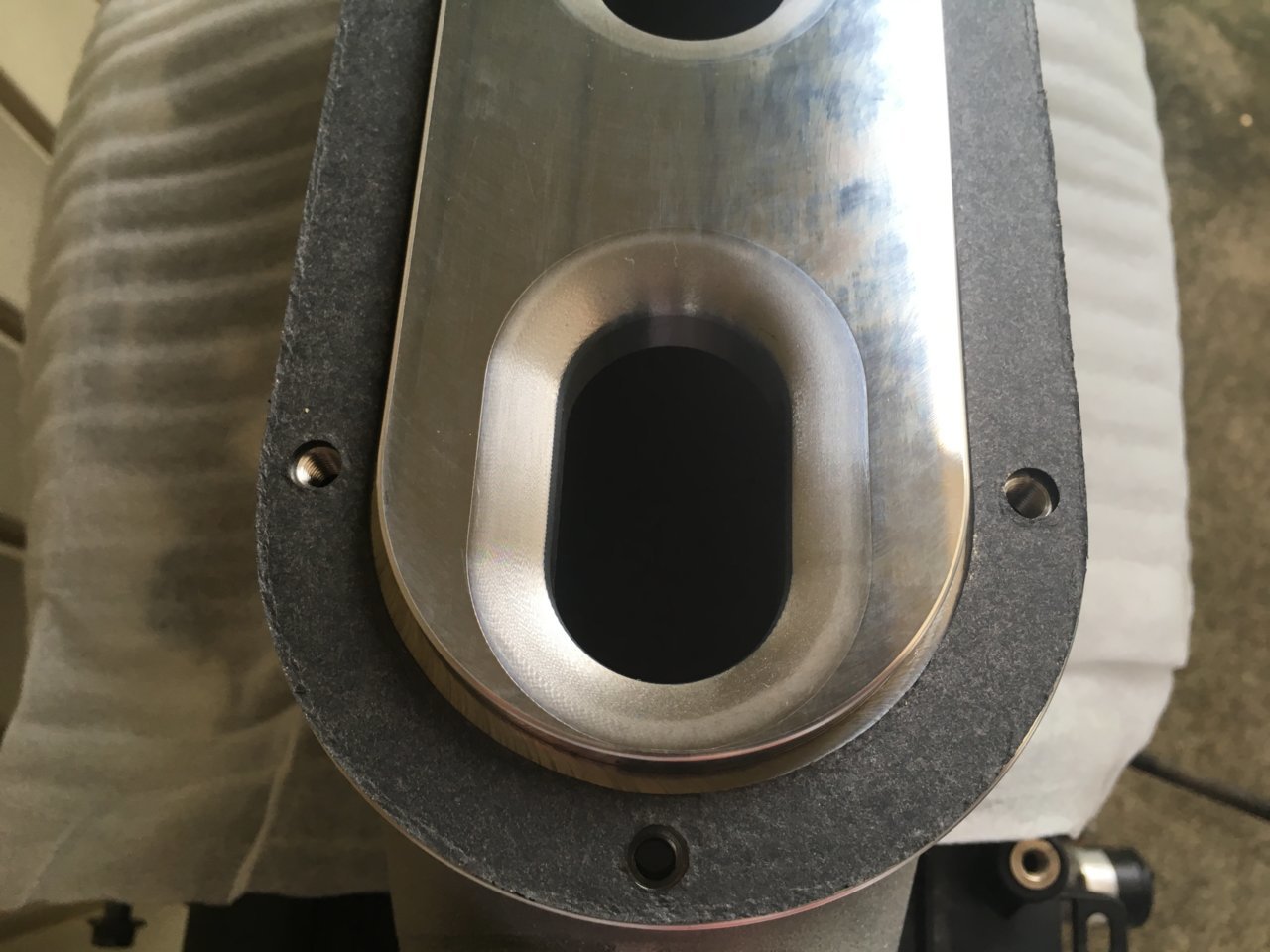

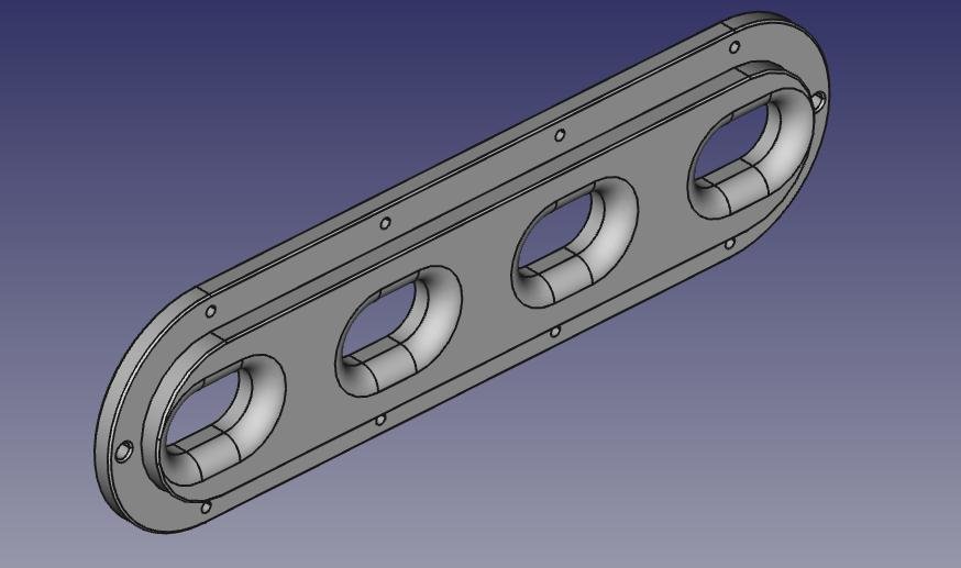

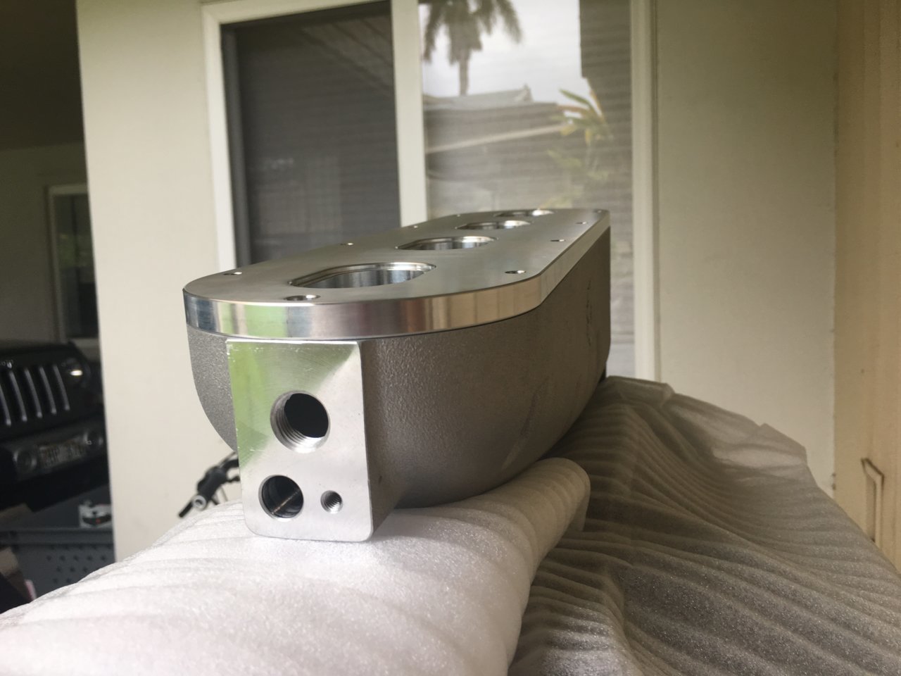

    I did, uses stock gasket with built in velocity stacks and seats for the runners.
    Billet aluminum, she's thick :D
    Made to accept this guy
    (80mm Hemi throttle body)

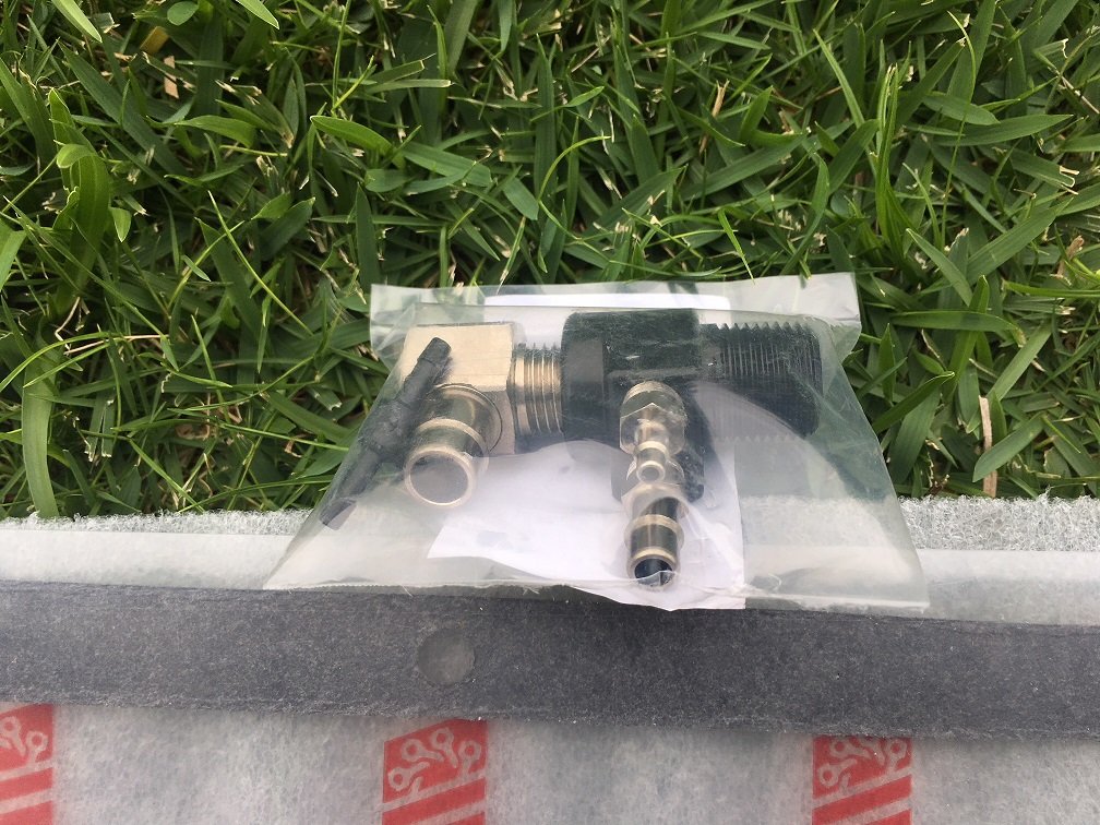

    Inputs for Bosch IAT sensor and mini vacuum manifold
    Fits like a glove

    So much craftsmanship here. Mad respect brother

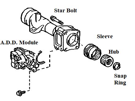

    Havent converted it yet but Im thinking a 4wd swap is definitely in my future and ill be using a fj tcase like you. Did you run an FJ AWD diff tube to eliminate the ADD? Im thinking about doing that..
    It hasnt been turbo'd yet, but ive been strongly considering it and doing my research. Kinda depends on if LCE releases a 2tr supercharger this year. Would rather go with a positive displacement s/c than turbo.. or maybe both since theyd be on different sides of the motor..:devil:

    Thanks for the post about the ADD. I remember reading that now that you mentioned it. I think since ill have to source all the parts ill just get the diff tube from the FJC

    Wow awesome build man, talented fabricator. I've been searching for the past 2 years for a aftermarket intake manifold, found one in Thailand through ig, those guys specialize modifying the 2TR engines. But the language barrier. Got a translator to see if they would sell the manifold but no reply back. Even in the states many refused to make one.
    Hows the performance and throttle response ?
    If you ever make one again and sell your old one I'll buy it from you.

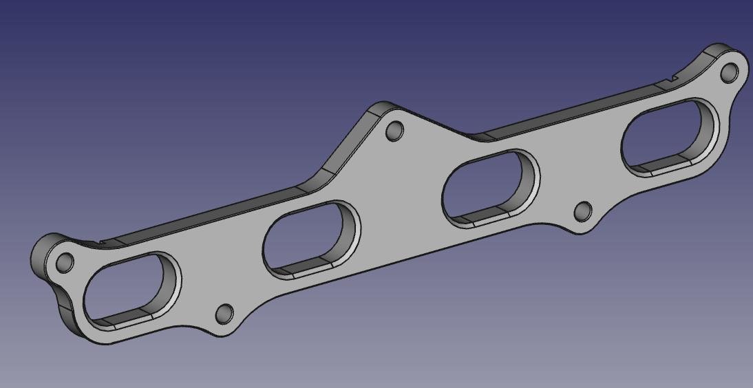

    I won't be selling mine but I can have more made. I don't have any extra fuel rails on hand but I do have another set of plates for the intake, you'll have to weld the runners on (I can provide those too).
