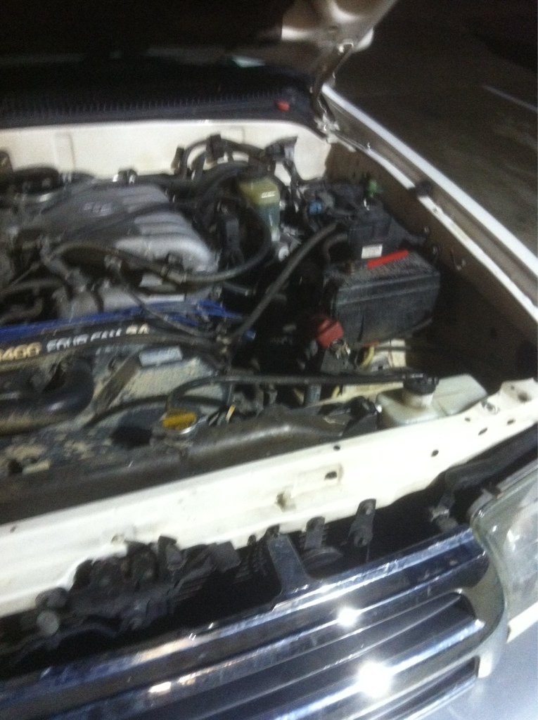

    Time to bring this thread back to life.
    I decided I wanted to give these manifolds a shot, so I went to order them yesterday, but apparently they're out of stock. 2 weeks at least until they get more.
    While I was on the phone with the guy, I mentioned putting these manifolds and downpipe on my 4Runner. He said it wouldn't work. All he knew was that his "R&D department" had tried it, and that there were clearance issues with the 4Runner. He didn't know anything more beyond that. My plan is to fabricate my own intake (non-intercooled, low boost), so why wouldn't the manifolds fit? What's different about the 4Runner engine bay compared to the Tacoma?

    Not sure... Can you post pics of your engine bay for mutliple angles? I know this kit is designed to be a non-cut setup so it might just need a little chop chop to fit.

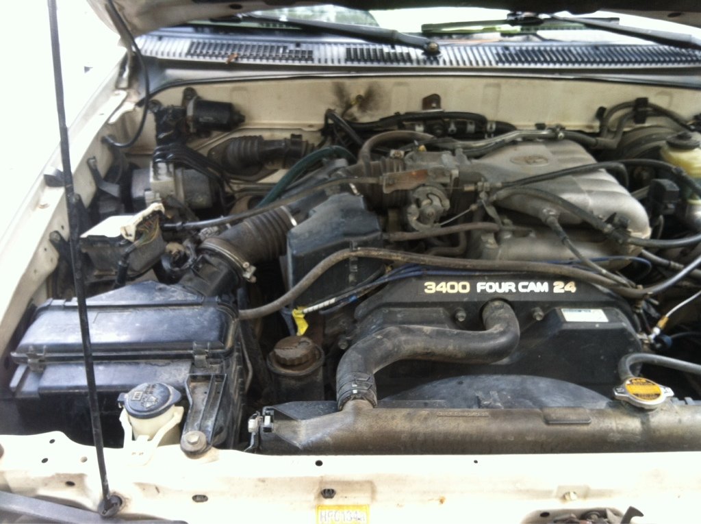

    Pictures I have on my phone at the moment.

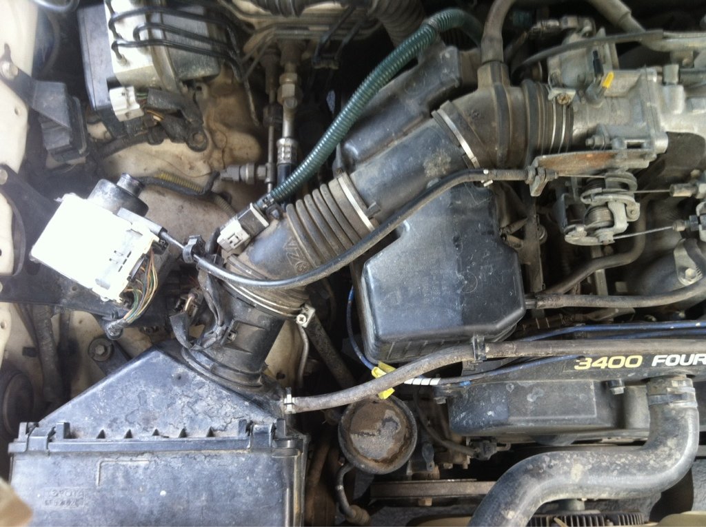

    You have a cross over pipe in the back of the engine? Im thinking the issue is how high/low the engine is mounted, how far back its mounted, or how much clearance there is between the wheel wells and block...
    If the engine is too high/low, the down pipe will need to be modified to match your exhaust run. If the engine is mounted too far back, you will need to cut your firewall to fit the cross over. If the wheel wells are too cramped, you will need to cut those a bit.
    Im currious if 1st gen tacoma headers fit your 4runner...
    Can you get pics more of your headers and exhaust run from under the truck?

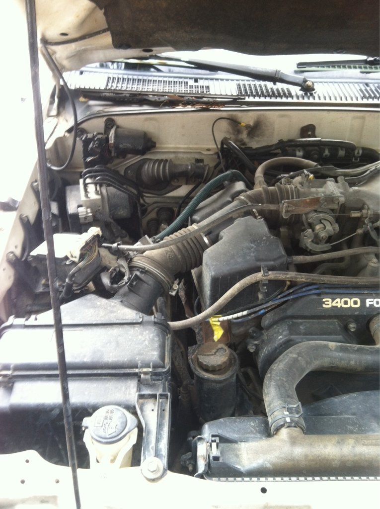

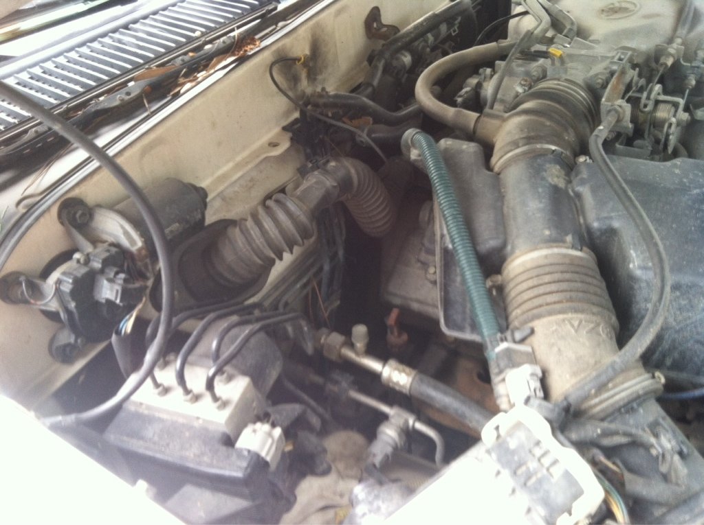

    Only other pictures that I found on my phone. I'll try to take more tonight when I get home from work.

    Can't tell... Did you ask Ace why it won't fit? Might be refering to the IC pipes :notsure:?

    Ace is the main sales guy there. Great to work with. When I bought my kit, I asked him to price match the ebay deal with free shipping (wanted about $100 more + shipping). Not sure why the price increase :notsure:
    Headers should def fit. Down pipe should as well. Everything else, hard to say.
