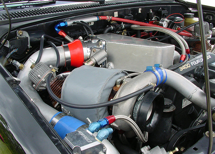

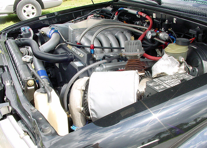

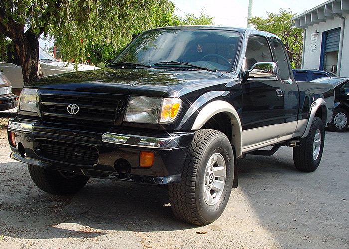

    Here are a few pics that PSI Racing emailed me. Enjoy.
    :D
