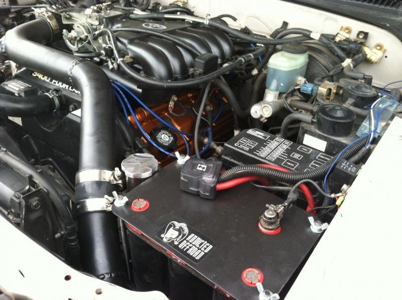

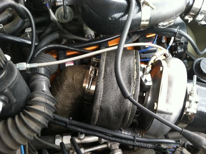

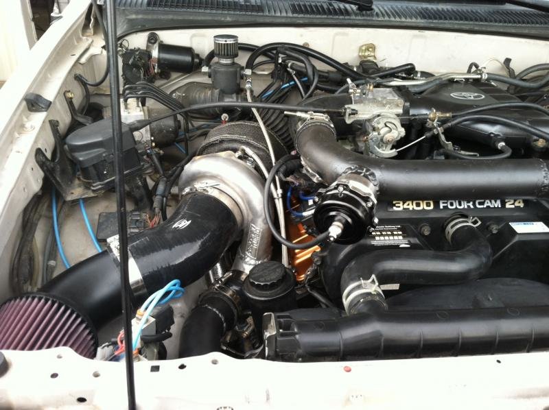

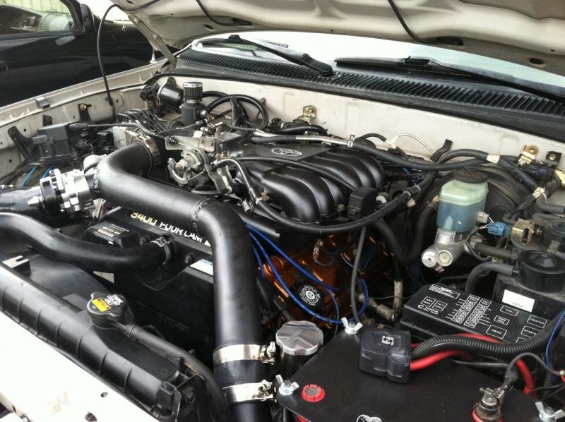

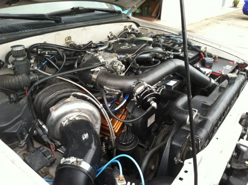

    Here are some pics of ours.
    3.4L Turbo'd

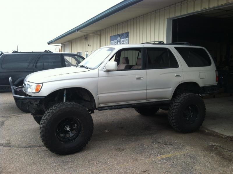

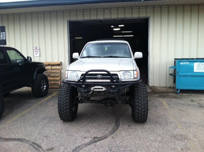

    Current ride height now. This is MUCH lower than when first finished.

    That looks very nice.

    Looks sweet!

    Hey scotty can you post up a few specifics like the turbo size, psi your running and what fuel mods you have with it?

    Intake, exhaust, lift. Typical stuff.
    With high engine load and low air flow, may want to consider an electric fan mounted on intercooler :notsure:.
    This. And WHP? CXRacing claims 300-500 WHP which I find a bit optimistic...
