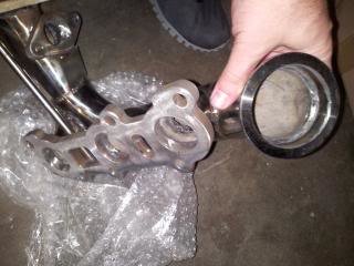

    No its a T4 Exhaust mount
    Edit: it LOOKS..like it might be a T3/T4..notice how it has two sets of holes for a turbo to bolt too. Doesn't really say tho..Think its a typo that it says T4/T4. Should be T3/T4

    yea thats what im saying theres 8-holes which wold make virtually any turbo work...well not any but having t3/t4 holes would open the door to lots of turbos.

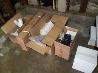

    Turbo kit acquired... now to find the time to install...

    Nice. Can you also run a list and prices of extra necessities needed to properly tune the turbo?

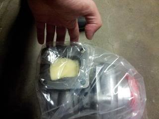

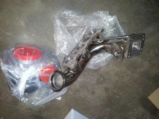

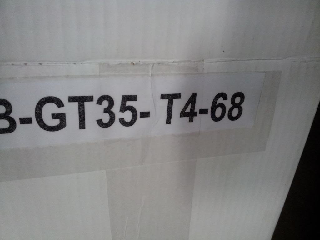

    I am curious about the turbo, and its specs. Could you snap a few more pictures of it?

    - 4" Air Inlet
    - 2.5" Compressed Air Outlet
    - Standard T4 Turbine Housing Flange
    - 3" Vband Exhaust Outlet
    - Journal Bearing
    - 300~500 WHP
    - Oil and Water Cooled
    - 6-25 PSI Working Pressure
    - .70 A/R Compressor
    - .68 A/R Turbine
    - 61.3 /82 mm Compressor Wheel
    - 62 /67.8 mm Turbine Wheel
    - 38mm 8 psi Wastegate

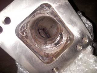

    I'll snap more pics later. The welds look great, and I like that they bothered to grind down the slag inside the manifold and reinforce the turbo mounting point.
