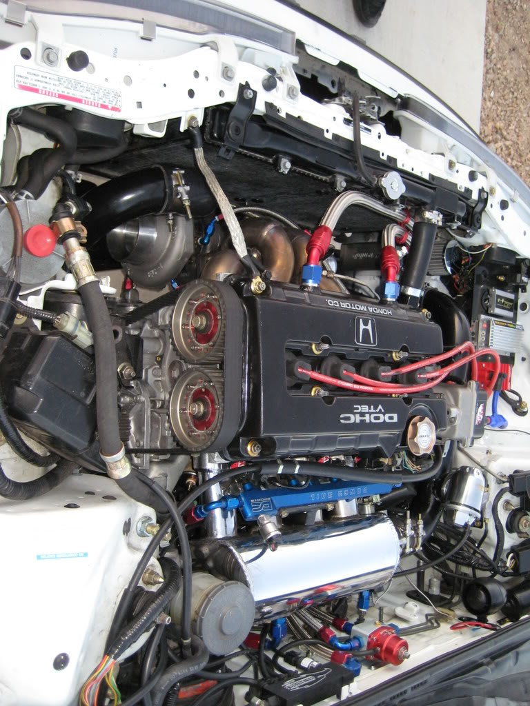

    My resume so I don't have to bother digging out the flame suite.

    Nice... I used to have 2.5L Sentra with Treadstone kit. T3/T4, megasquirt ECU 3" open cutout... I did everything myself... The best way how to learn!
