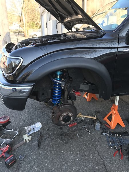

  11. Apr 28, 2017 at 9:34 PM
    Jcyr
    Jcyr [OP] Midnightthetaco
    Mar 16, 2017
    #213447
    3,280
    Jack
    North east
    3RZ 04 4x4 black ext cab
    2.5" lift king/total chaos Skids sliders rear tire swing

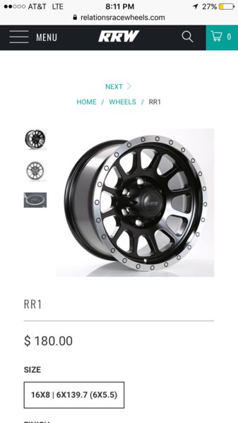

    Thoughts opinions or reviews on these?? I'm pulling the trigger Monday morning

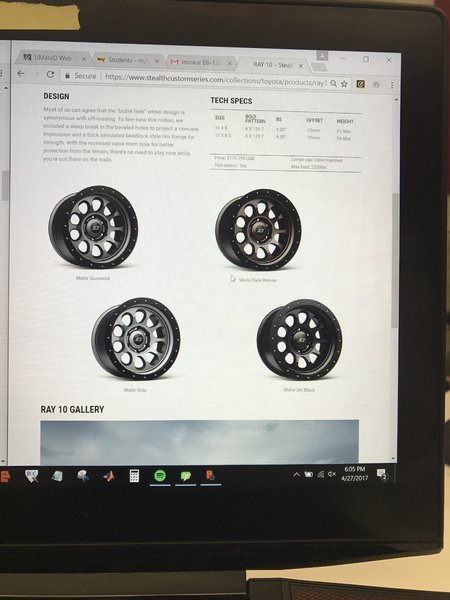

    Or this one

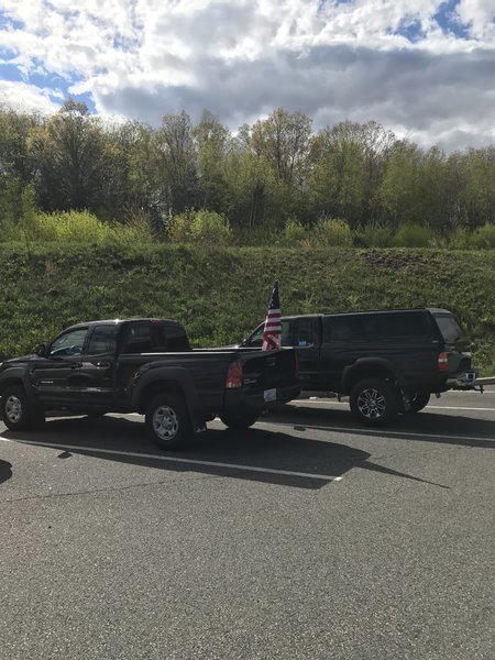

    Tacos unite! Me my new cap and lift with some random taco with the +300hp American flag mod IMG_0192.jpg

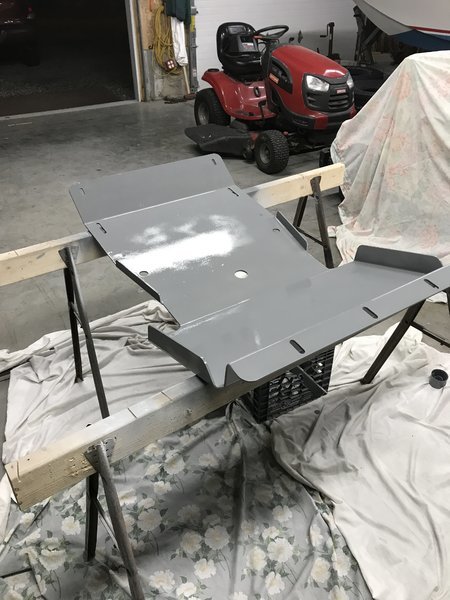

    It's a Budbuilt.com skid it's pretty much bolt in. Super high quality although one hole was an 8of an inch off so I needed to use a dremal
