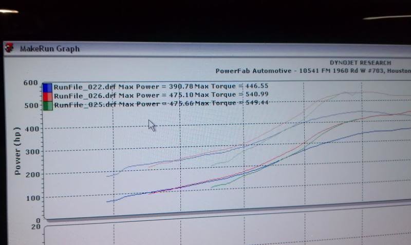

    Originally Posted by pikuptruk [​IMG]
    Turbo
    Although, they tend to cause more wear and tear. The heat etc....
    Turbos need more power management. Boost is boost, so does a Supercharger
    Turbos cause more shock load on tranny they shouldnt, turbos generally "kick in" slightly slower than most S/Cs
    Back pressure issues if not tuned properly... You can mismatch anything..
    Always more BHP. Generally speaking thats true
    Always more efficient. Newer S/Cs are gaining effeciency, but will never exceed effeciency of a turbo. There are incredibly efficient supercharger out there, it really helps now that they use a bypass valve to help it out..
    S/C pulls on the front half of your engine however.... Well it sort of uses the entire engine since it is crank driven
    Faster reaction It can unless its a Centri blower
    It all depends on how you drive.... What you need it for....
    on our 42k BHP diesel, we have turbos. But we also have engineers to fix everything the turbos break... Lol
    Quoted from Speed-Freek.
    To coincide with Speed-Freek, a dynograph with from a TRD S/C @ ~9 psi on E85.
    Notice specifically the instant torque. Non progressive, which also means instant shock load. Graph from this link: http://www.xr-underground.com/forum/showthread.php?t=32072
    Now, here is a graph of my turbo's torque comes in.
    As you can tell, it is much more progressive than a roots style s/c, and thus less instant shock on components.
    I agree with Speed-Freek.
