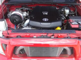

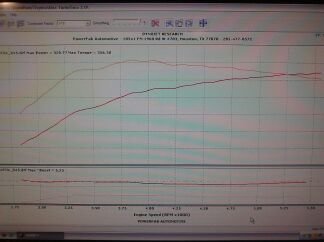

    I vote turbo again. Hehe.
    5 psi. Stock Injectors, stock ecu, FPR Mod.
    320 WHP 350 WTQ. AFR's are high 10's to low 11's.
