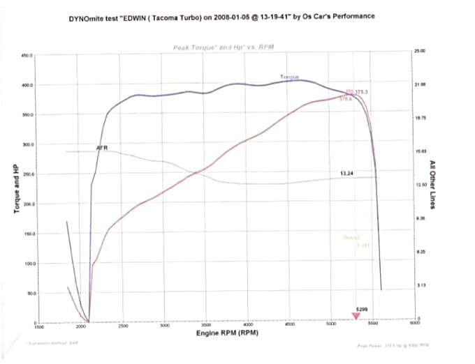

    40bed92f-18db-42fb-93ee-f17d419a2ab4_zps_3e15f7cfd55ae9a894bd8da512bf770e30b44655.jpg
    Twin GT28R's :D Even on an initial tune.

    Am I seeing that right - 13.xx AFR??

    Yes you are. That was right after the twin build was completed. The shop quickly found that they needed to upgrade the fuel pump. At that time/date, Gadget hadn't yet released his URD fuel pump upgrade kit. This was early 2008.
    The impressive point to notice here is that how immediately the torque comes on. Almost full torque as soon as the thottle is buried. This was a 7psi pull.

    was that megabits kit?

    Yes sir. That was prior to the Emanage Ultimate, fuel pump, and 750cc injectors. Which then led to the retune.
