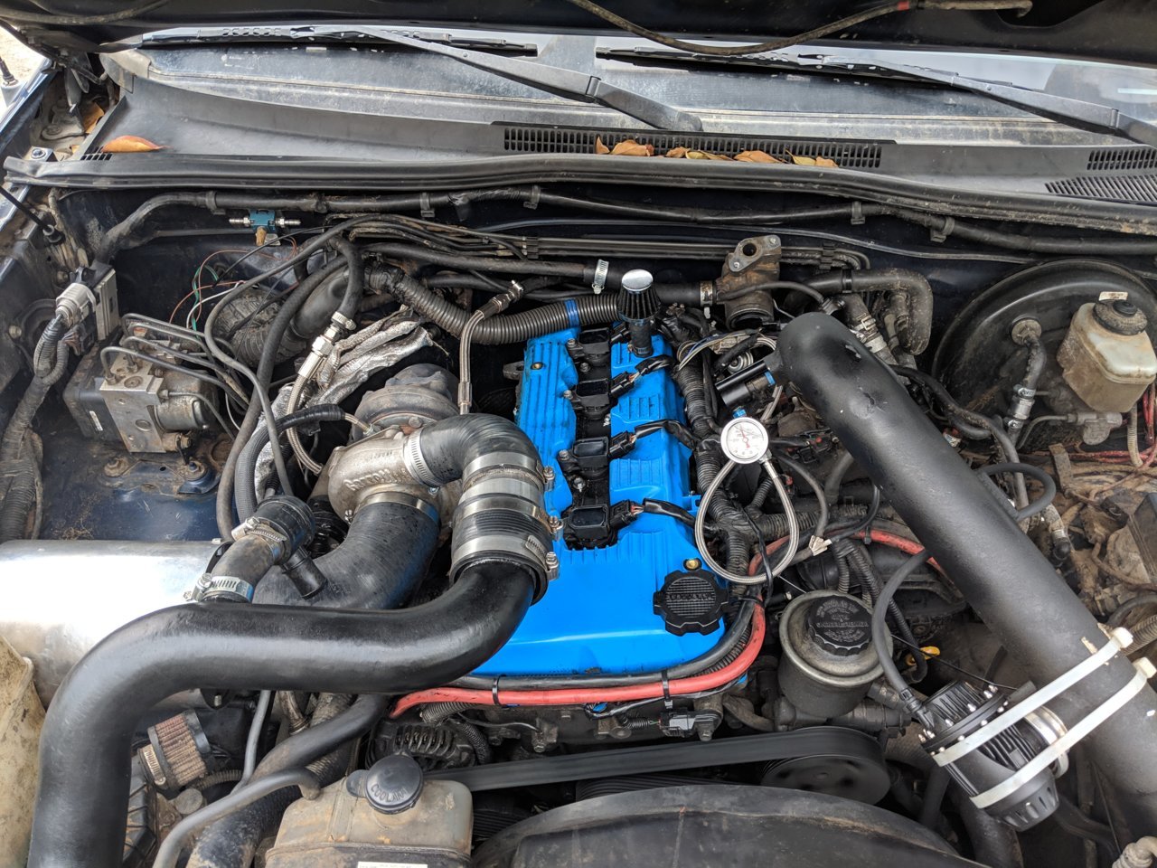

    well... where do i start. I kinda forgot to give yall an update, a very long time ago. So I spent a while figuring out and deciding how to go about a turbo. I went into the shop and started dissembling what I needed to. The first problem was that the turbo manifold did not fit. So i tried for eight hours trying to cut and weld. Nothing would budge. That is what quickly put me in my tracks. Simply couldve avoided every problem by having a CUSTOM BUILT manifold and not a cheap one off ebay. Then two months later, I built a VW Golf and turbo'd that and flipped it and made a few grand to put in my pocket. Lesson learned, expect for everything not to go as planned and have the right parts.

    Yeah I had to order a manifold from China and it needed a some modifications and repair

    do you have the link to the manifold?

    That's the one I'm running, along with a few other guys.

    How much work did it take to get it to fit right? Ive heard they can require modification to get them to fit nicely

    That's the one I used. I had to modify the downpipe alittle on one bolt hole.

    I didn't have to modify anything on mine... But the quality control on some of these ching-Chong parts can be sketchy.
    I'd honestly get the manifold and bring it to a machine shop with your turbski and have them face the gasket surfaces... And avoid having to replace gaskets by simply running some RTV

    Oh yeah I forgot I split mine . It was probably me doing push-ups on top of the engine while I was working on it. Luckily it was easy to patch up.
