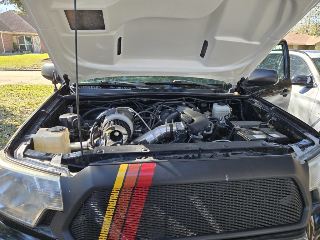

    Anyone on here has or have had a turbokit on there truck for a while?
    I recently had a custom turbo kit built/ installed on my 2014 / 4.0, curious on any advice on experience or what to expect in the long run, or if any internals need to be upgraded,,, it's at 8psi, and don't plan to go anymore in the future

    Pics and videos please! :D

    Sorry, no videos yet, im still working on the build

    Torspd Custom Turbo kit [] Borg Warner 9180EFR Turbo [] Haltech Elite 2500 [] TiAL Q BOV [] TiAL V44 Wastegate @ 15psi [] CP Pistons [] CP Carrillo Rods [] ARP Head studs [] ARP Main Studs [] ARP Header - Head Studs [] Ported Heads w/ 1mm oversized valves intake/exhaust [] Brian Crower Forged Stroker Crank [] Darton M.I.D. Sleeved Block [] Kelford Camshafts [] Torspd 160* T-stat mod [] APR Large Fuel Rail [] Walbro 460 LPH E85 Fuel Pump [] FueLab FPR [] APR T56 Conversion Kit [] KP RACING Built T56 [] McLeod Racing Custom Twin Disk Clutch [] One Piece Aluminum Driveshaft [] MGW Shifter [] Custom lowering kit [] Ohlins Front Coilovers [] QA1rear shocks [] Custom Ron Davis Radiator [] Dual SPAL Electric Fans []
    Do not increase the RPMs. Or your rods will fail quickly. Keep the timing conservative, or your ring lands will crack.
    Basically the 3 first upgrades are rods, pistons, and head studs.
    What are you using for tuning?
    Have you upgraded the fuel pump yet?

    It was tuned with HP tuner and yes the fuel pump was upgraded

    My last truck i has the Trd Supercharger/ retuned with Hp tuner as well and fuel upgrades .... I ran that sucker like a dog with no issues for over 10 years .. but i have a gut feeling i need to invest in some things with this kit,,, thanks again for the heads up... I had the pistons and compression adjustment in mind, but not the other things

    An intercooler or some water methanol injection to lower intake temps would be a solid upgrade imo
