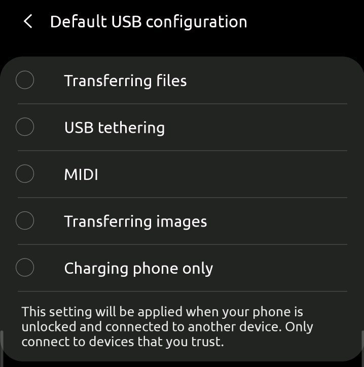

    You can select for charge only on the smartphone settings.

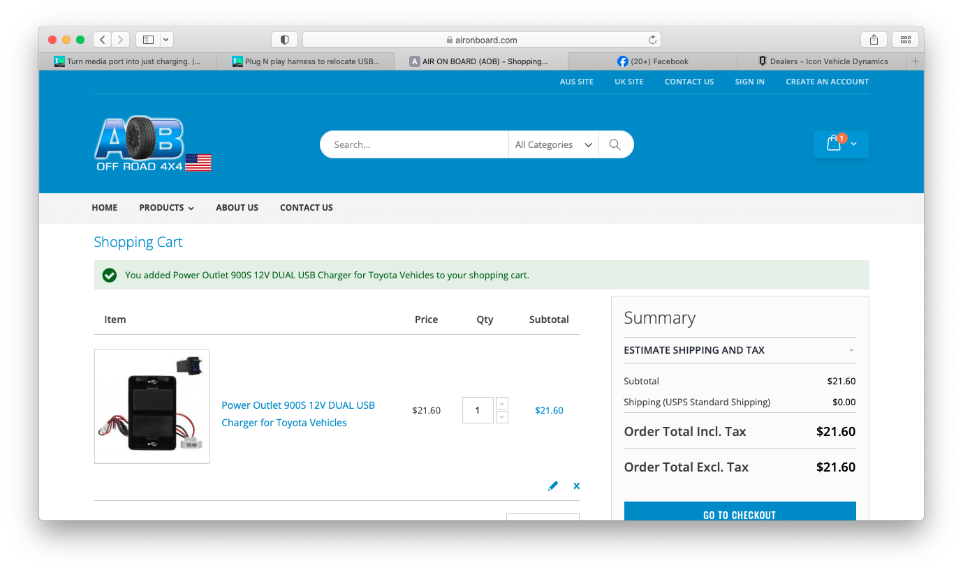

    Think I'm going this route. evidently I can tap off 12v power.

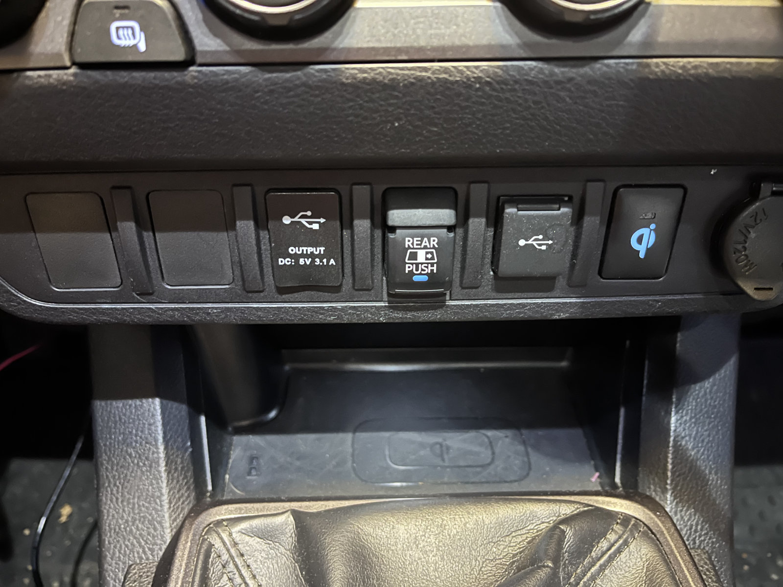

  16. Nov 17, 2023 at 5:32 PM
    #16
    mtbkman
    mtbkman [OP] 2020 TRD Sport
    Dec 9, 2022
    #412674
    110
    Metro Detroit
    2020 Trd Sport MT
    None yet

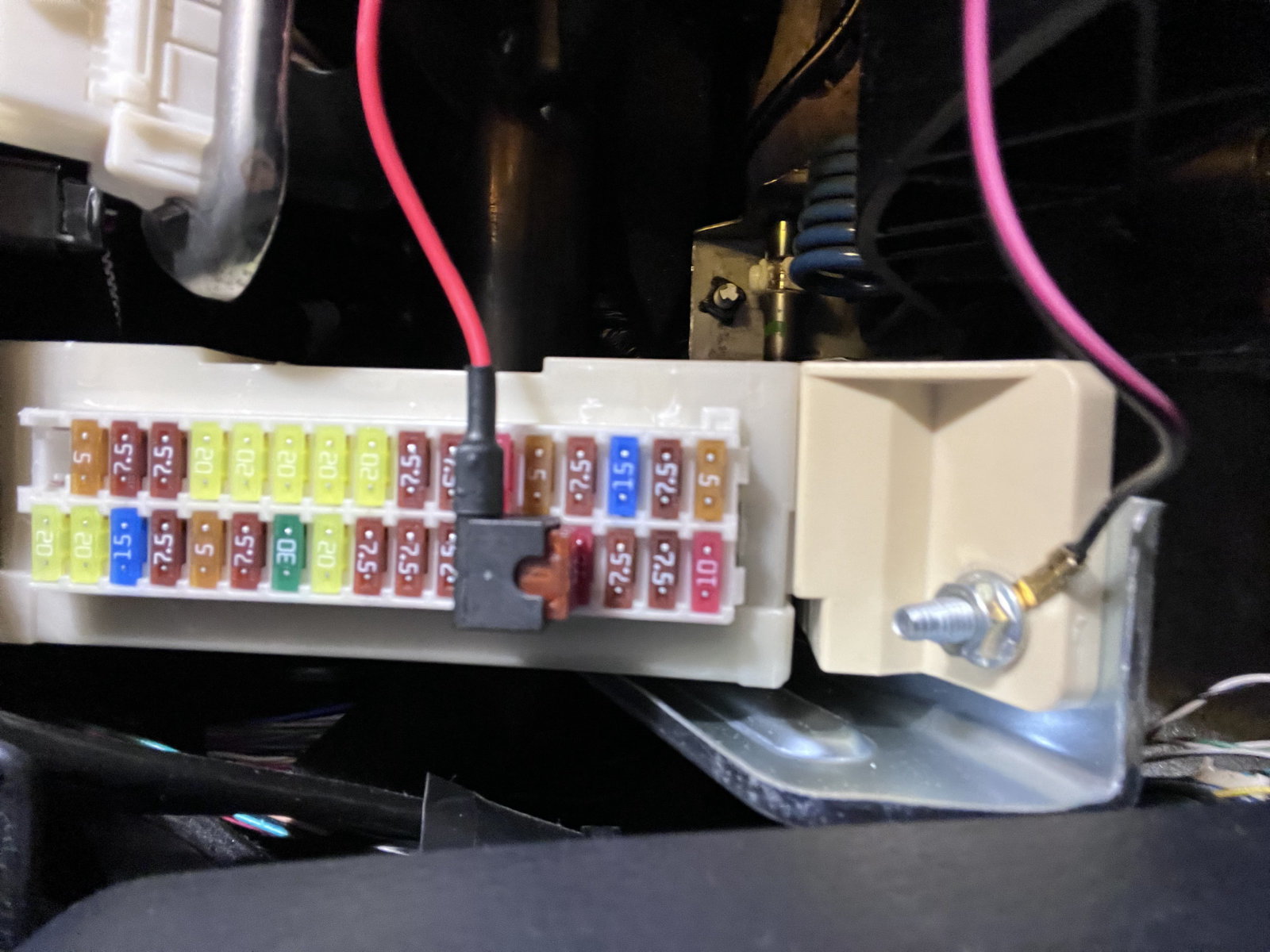

    Ended up putting that USB switch from AOB in, Did an add a fuse. Left the OEM one in in case I don't keep the truck as long as I think I am going to and want to go back to OEM.AC657C9B-E2E3-4E4C-9A06-AC2D75122AB9.jpg5031AD8A-C970-4B8A-973F-D176F3881FE7.jpgE69CCB5B-4279-435F-86A8-D2C0247A6843.jpg

    Actually looking at that photo, I think the add a fuse is suppose to go the other way.... Am I right?

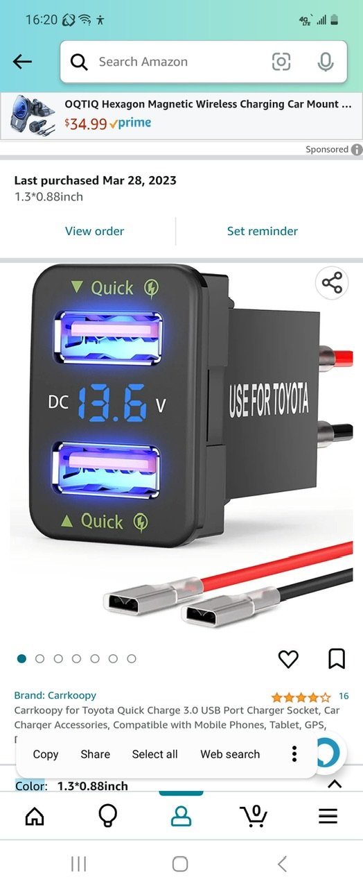

    Maybe this51fqSjuOhlL._AC_SX679_.jpg ?

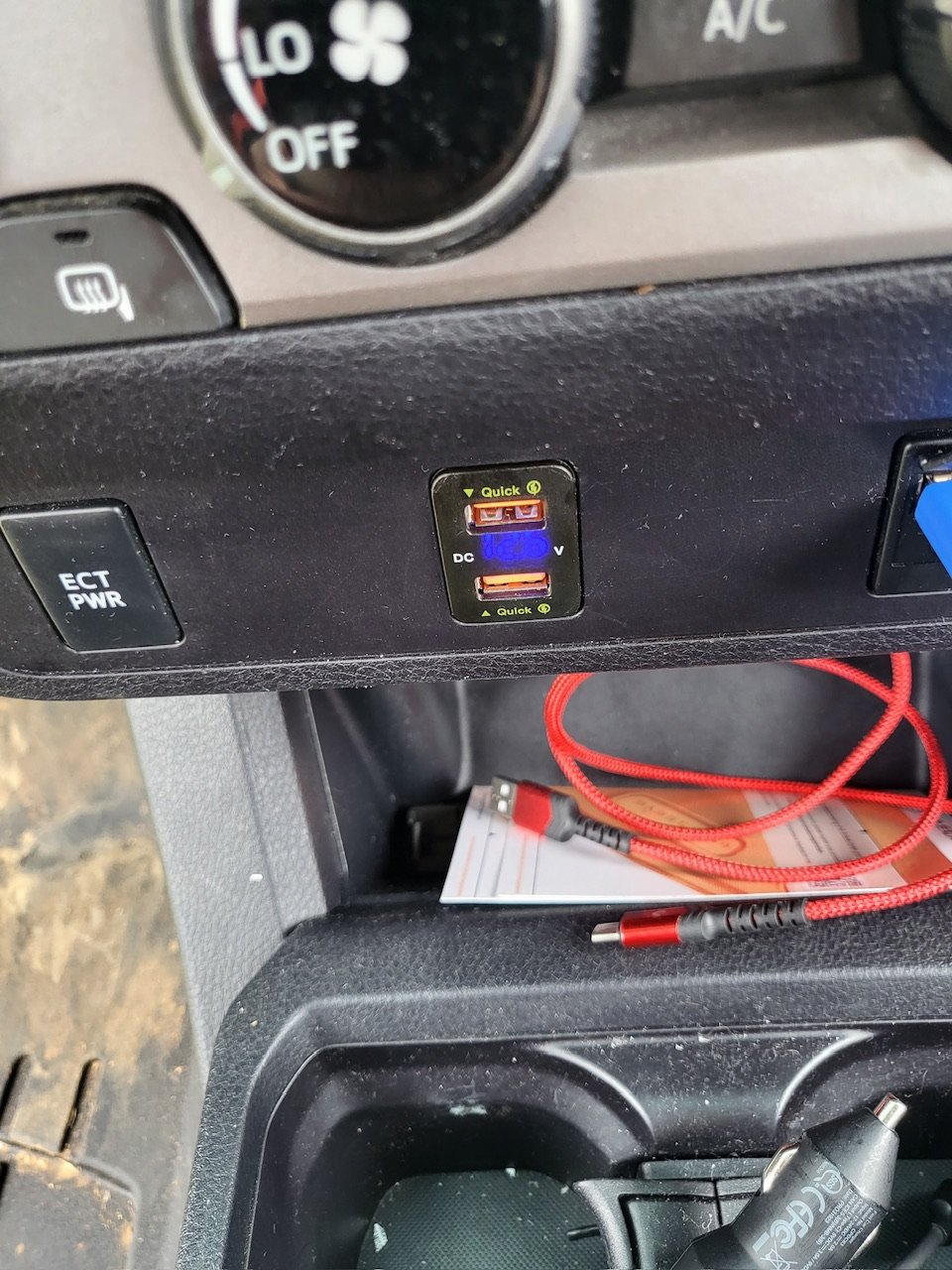

    I went with this as a fast charger
