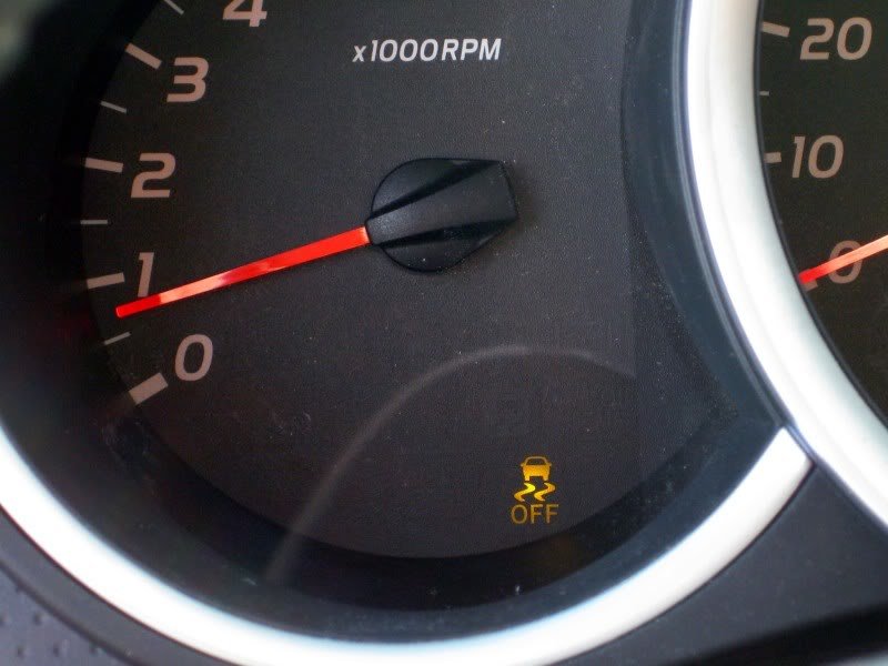

    Hello, I have a 2010 DCSB TRD-Sport Pre-runner. I wanted to know how to turn off all the vehicles assist systems so I play in the dirt without having a beeping sound (driving me nuts while sliding sideways in the dirt)... followed by a cut in the throttle/brake or whatever it is to correct my "so called lost of control" I've search the forums about the Auto LSD button... I've tried pressing the button an I get two lights on my dash (Auto LSD off an the car logo with squiggles) that doesn't work. Then I pressed an held the button for five seconds, the Auto LSD light goes off an the car logo with squiggles stays on. But in the dirt when i try to spin out or do a "doughnut" the system quickly cuts power an tries to stop me from sliding. Its no fun :( How do I turn this off an have the rear end still be limited slip so I can play???

    You've done all that you can to turn it off , but it still lurks in the background but at a lessened sensitivity .
    Search out Crom's threads on ABS / VSC bypass

    You must stop moving, then hold down the VSC OFF switch for a few seconds until the indicator light comes on.
    As OZ-T said, it will come back on to PREVENT you from rolling the truck or spinning out-of-control. You have an excellent, expensive vehicle... not designed for 'do-nuts'... Have fun off roading in a more straight line!

    This just isn't true... while it uses wheel brakes instead of clutches inside the differential, to slow down a slipping tire, it IS LIMITED SLIP.
    ALL TACOMAS since 2009 have:
    TRAC (2WD) normal mode: brakes and engine output regulation to reduce (limit) wheel spin. VSC is active.
    Press the VSC OFF switch quickly for:
    AUTO LSD (2WD): brakes only to limit wheel spin, engine is NOT regulated. This gives max. power to the traction tire to get unstuck. VSC is OFF to 30 MPH, then is active.
    Stop moving and hold down the VSC OFF switch for:
    VSC OFF MODE: TRAC is also OFF to allow tires to spin without traction control. If vehicle is approaching tipover angle (high yaw rate), VSC will come back on automatically.
    Press the VSC switch again to return to normal TRAC mode... or re-start the truck.

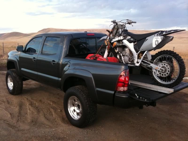

    Greeeeaaaat... Thats not what I needed to hear, cause I'm taking this to Pismo in two weeks, one tire fire hear I come!!IMG_04871_0786bbc1ce84aa7815e56cd262be7c92e024a3a6.jpg
