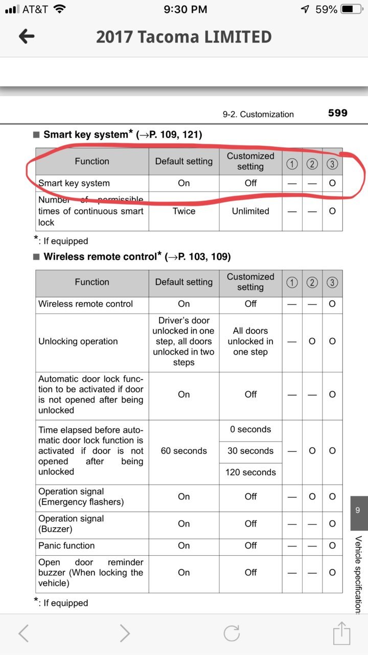

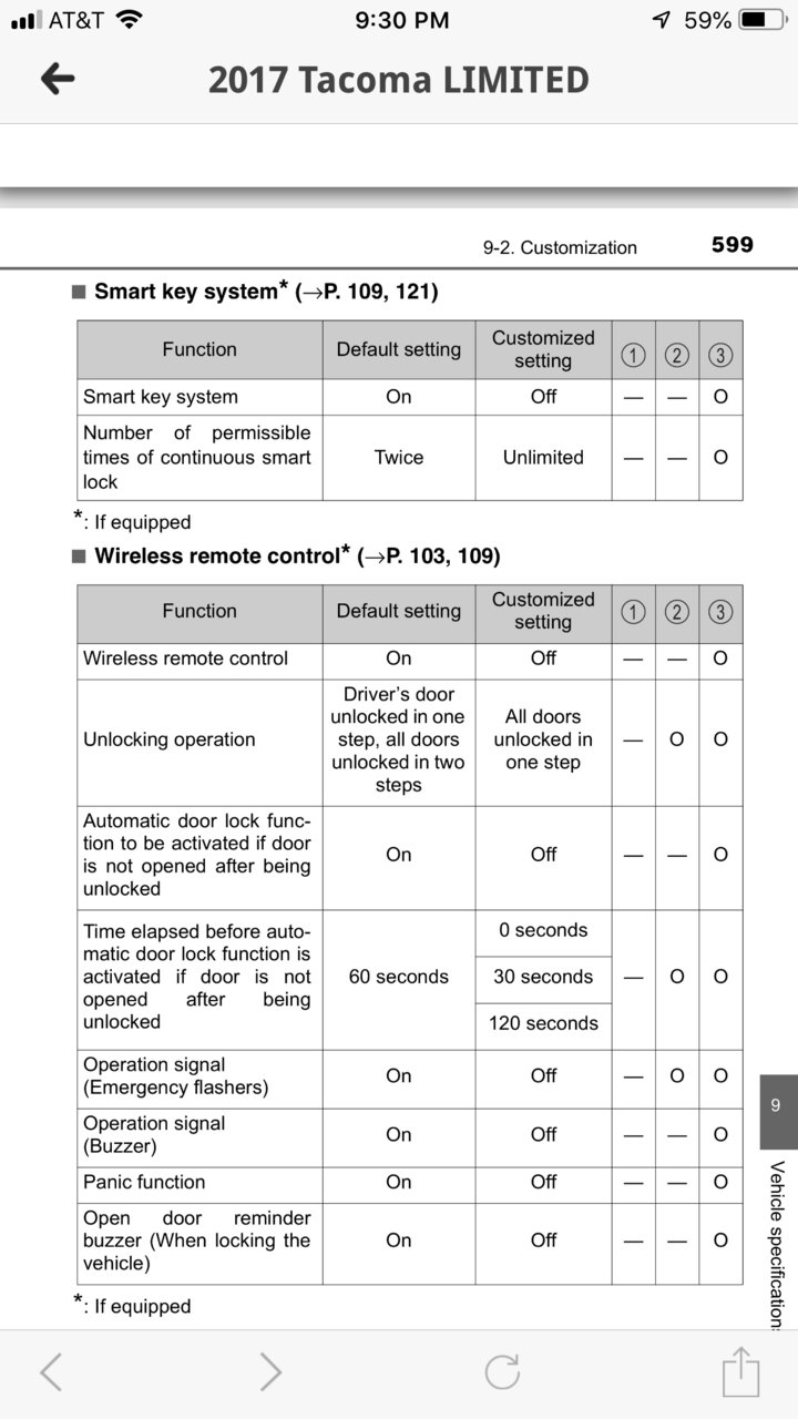

    Or, it looks like the dealer can disable it:

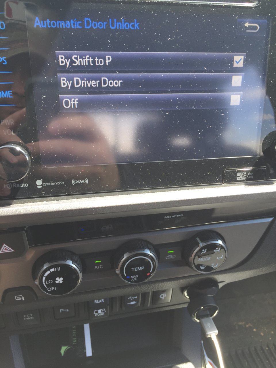

    Page 592 on your user manual.
    Just do it through your infotainment. I did mine so it opens all the doors when I touch it.

    You can't turn off the unlock feature through the infotainment that I can find.

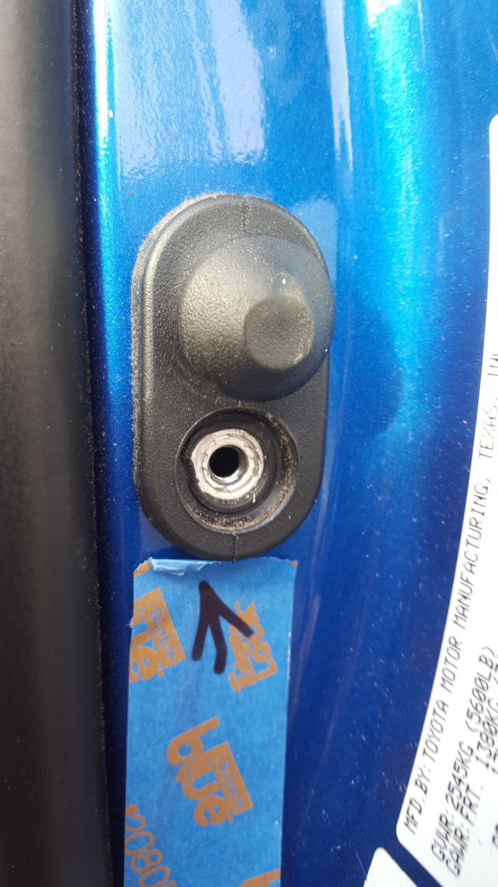

    Ended up just pulling the wire from the sensor inside the door. Was surprisingly easy. Problem solved!

    How did you get to that sensor?
