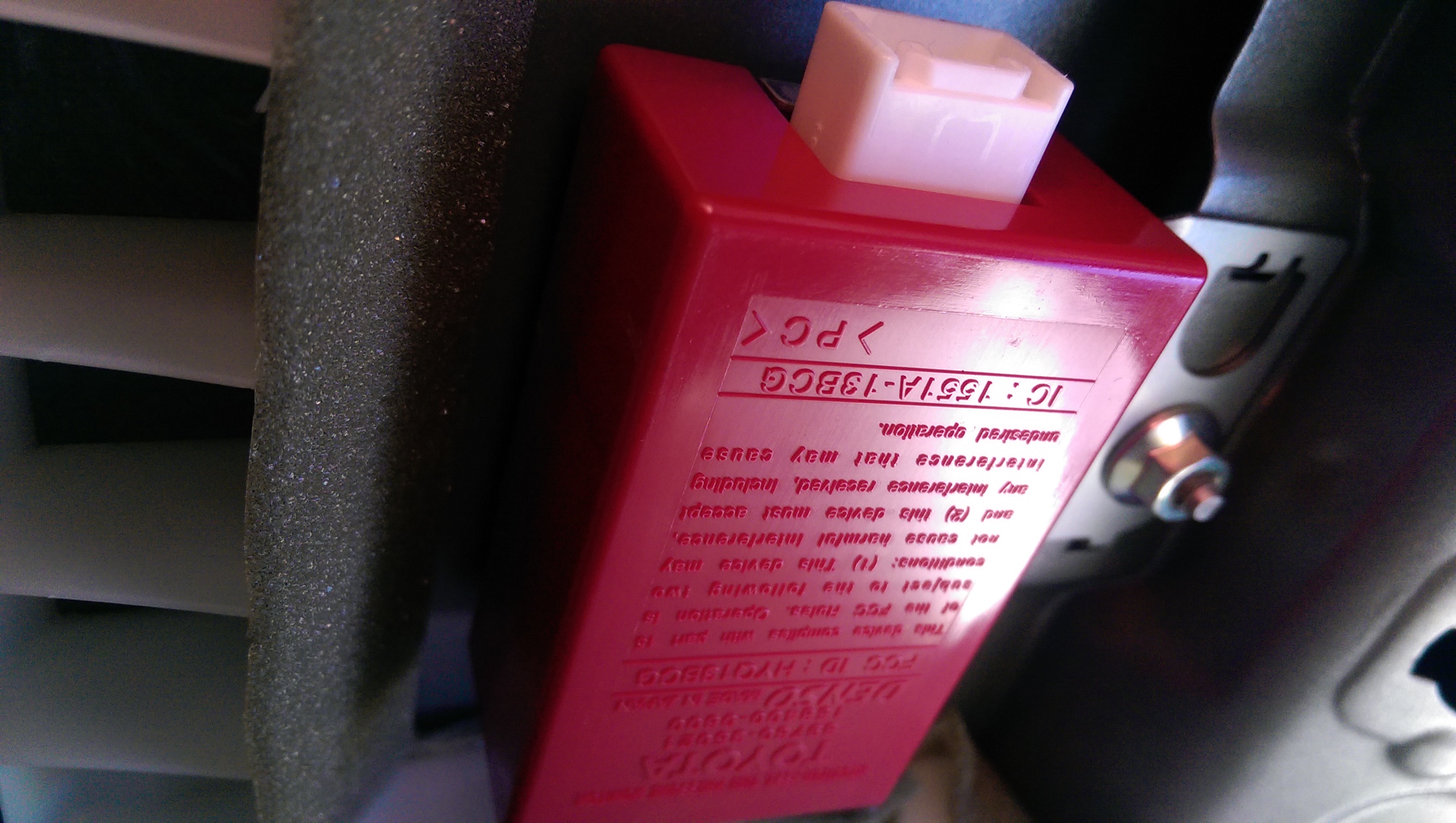

    When I did this on my 2010 access cab the tpms box was red, not black. Maybe that's why it worked for OP and not for mine.

    Tried the OPs method today and only result I got was that the light flashed longer before staying lit. Super simple (no tools) and was worth a shot.. Too bad it didn't work.
    This was on a 2012 DCSB.

    So, my box is red instead of black. Unplugging it only cause the light to blink longer before staying on.
