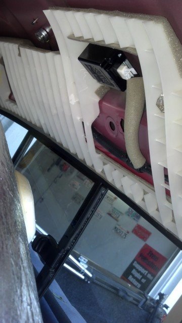

    OP states to simply unplug the box. I had tried with no success.

    may I please get a pic of the specific harness, I see one that is taped to a wire cluster in the area given but I just want to make sure so I don't do something stupid. Specifically the passenger side apparently there is a mod that works off that side by shoving a wire into the blue #4 slot and grounding it. It only works on 06 and some early 07 models 05 did not have TPMS system. OOPS nvm as I scrolled down I saw it and I have the right one THANK YOU!!!! update: confirmed as well worked like a charm thanx again.

    Just scroll down on the link provided down below, confirmed it worked like a charm light is gone. It is in fact the small white wire harness tapped to a cluster on the right hand side, there is only one that is like that not too hard to miss and only one blue wire in that harness super easy to get to once you remove the glove box and kick panel. There is a small bracket (presumably the one that holds down the side panel) light grey in color with one 10 mm bolt undo that ground your wire to the bolt done. I reconnected the stupid box and the light still remains off so that process is totally unnecessary. I did not need to do anything on the drivers side took me all of 5 min. Hope this helps. Finally a solution.
