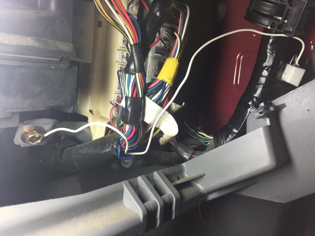

  7. Jan 12, 2020 at 12:21 PM
    #127
    benzy
    benzy Well-Known Member
    May 4, 2016
    #186122
    656
    Bay Area, CA
    2006 DCSB TRD OR
    Simple OME/884/AAL lift. 32” WP’s
    If anyone is interested in disabling the TPMS in a 2006 4wd DCSB i can verify following steps 13 on in the link below worked for me. Ignore steps 1-12.
    Very simple. Just find the small while connector taped to a wire black mass of wires the far right behind the glove box. It’s this lone white clip on the right side. Jamb a wire where the blue wire is (position 4) and ground that wire on the nut right above.
    ...no cutting of wires and can be returned to factory in 2 minutes.
    https://www.toyotanation.com/threads/how-to-disable-the-2006-tire-pressure-monitoring-system.124871/

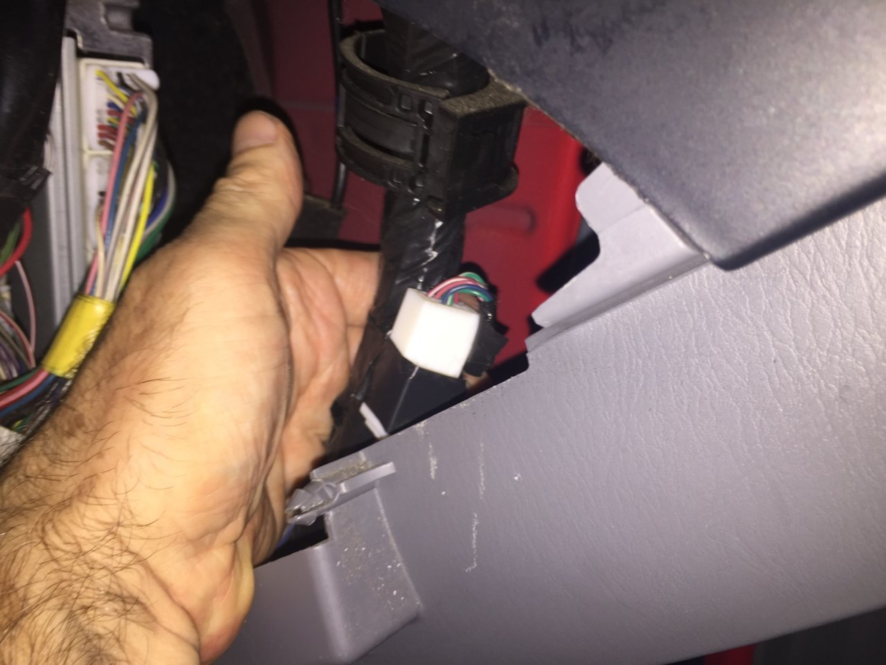

  9. Mar 21, 2020 at 8:11 AM

  11. Jul 18, 2020 at 3:27 PM
    #131
    SaratogaTaco
    SaratogaTaco Well-Known Member
    Jun 29, 2020
    #332879
    76
    I followed Benzy’s instructions on my 2006 access cab and it worked perfectly for me. No more light. This took a few minutes and is easily removed.
    Some more detail. Take the glove off or down like you are going to change the cabin filter. The white connection is to the right of the cabin filter taped to the right most wire loom. Twist the connector to see it better and push in a thin wire below the blue wire in position 4. Then ground the other end of the wire to the bolt near the cabin air filter.
    John90XJ likes this.

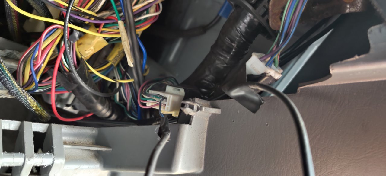

    will.i.was
    will.i.was Well-Known Member
    May 6, 2018
    #252688
    1,709
    Will
    Houston, Texas
    SC 2.5
    A member just messaged me about this asking what I did. I have a 2007 Tacoma. I powered a blue wire with 12v from an unused plug. I believe this provides a signal to ecu that the tpms computer is installed. Here's a picture.
