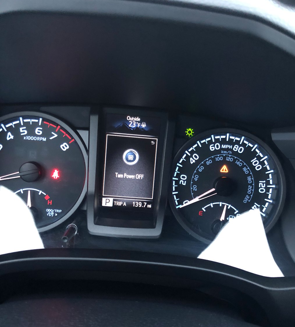

    Have any of you seen this happen before? Just got to work, been driving through 8"~ of snow and its not overly cold or anything..but when I turned the truck off and got out, it started beeping at me. The message on the dash says "Turn Power OFF"....odd.. the truck is off. I press the start engine (brake not pressed) button to see if it was on accessory or whatever, nope. Turn the truck on and the message is still up...turning the truck on and back off again fixed it.
    THE FIX: I immediately pulled out my cigarette lighter usb charger and it went off as normal. My GoPro is messed up and won’t turn on now and I think that is causing it. No idea how, but once it’s unplugged the message goes away. I am thinking the gopro was backfeeding into the port or something.

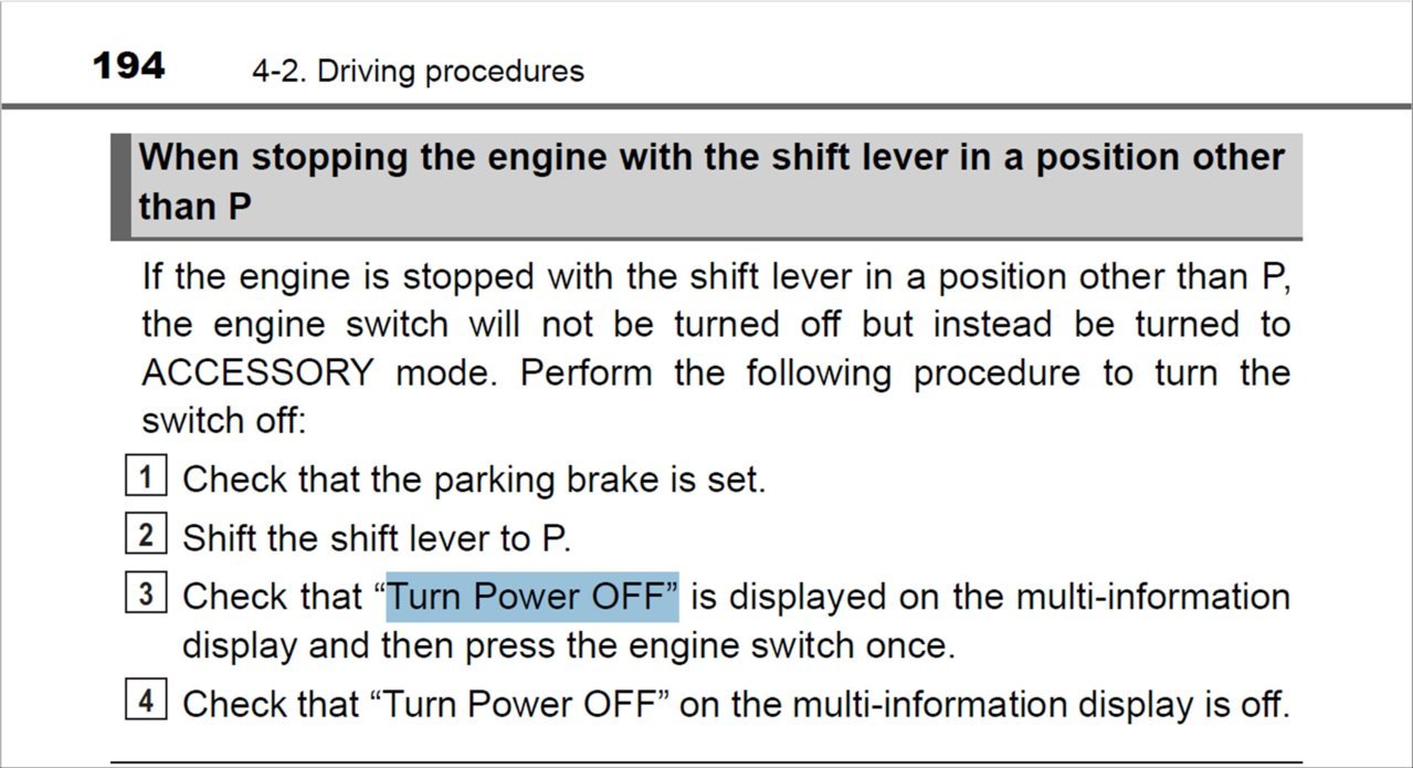

  13. Feb 6, 2019 at 8:27 AM
    Lawfarin
    Lawfarin Who me?
    Oct 25, 2015
    #167659
    7,923
    Beetle Juice
    NY
    2024 GMC Sierra
    The gear selector in his picture showed it was in park. My truck lately has done something similar when it was cold. Almost like the accessory was still on as I was getting out. I didn’t notice that message but perhaps it did appear. One time I actually cycled the accessory and ignition just because I thought it was left on somewhere. I didn’t really investigate as I was in a hurry and it was cold as hell outside
  14. Feb 6, 2019 at 8:35 AM
    Technique
    Technique [OP] Well-Known Member
    Nov 4, 2017
    #235046
    2,922
    Alex
    Utah
    2017 Silver Offroad DCSB
    -285/70/17 Toyo AT3 -Tuned
    Good point, didn't even think to check the indicator in the picture. My experience today, it was beeping and wouldn't let me lock the truck.

  16. Feb 6, 2019 at 8:42 AM
    #16
    Technique
    Nov 4, 2017
    #235046
    2,922
    Alex
    Utah
    Thanks for finding and posting that info. I did have my truck in park when it was turned off, I double checked that. I also did cycle through the power modes via the engine switch, nothing. Started the truck up, still there. Only went away when I turned it off again and back on.
    Again, just chopping it up to a fluke. It it happens again today then I may be concerned.
