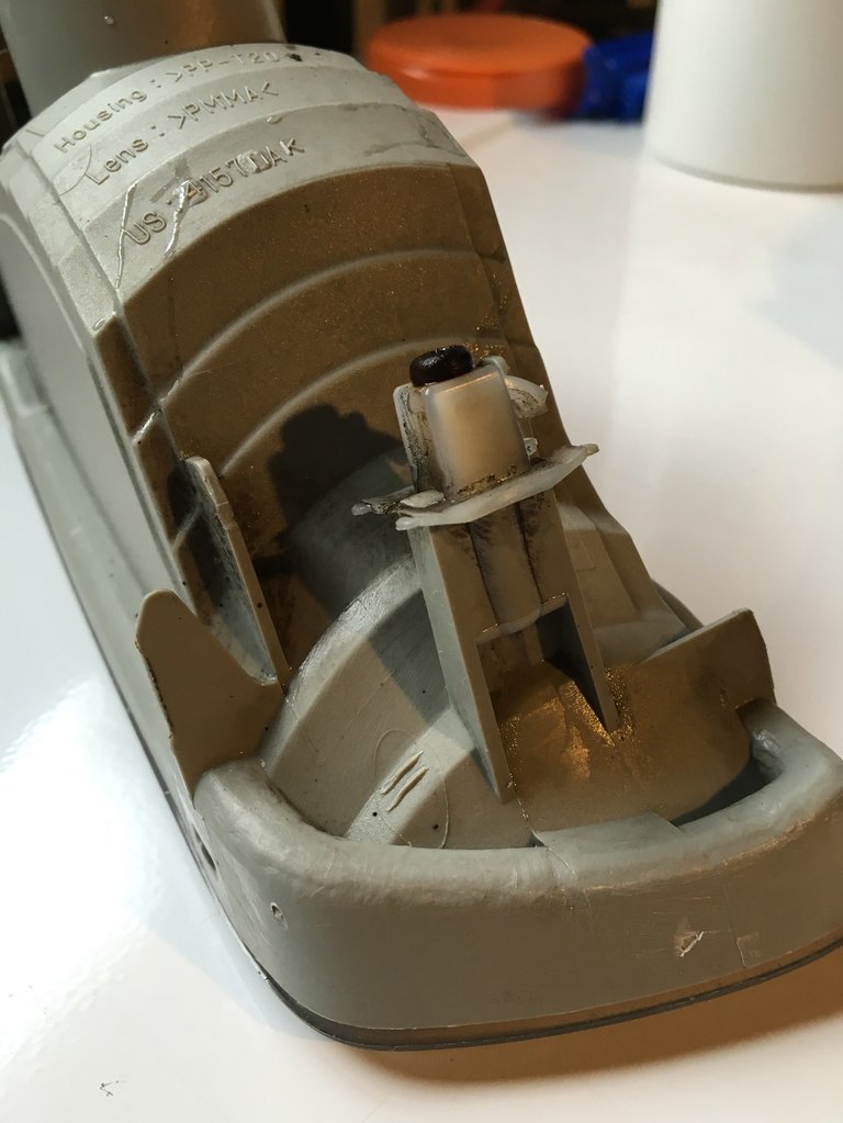

    I broke the clip on the back of my otherwise good condition front turn signal. Anyone know where I could find this part?

    Anyone? I'd love to just replace just the nylon clip.
    I looked at some Toyota schematics and it appears that the lens is sold as a complete unit, but there's got to be another way...
    Thanks!

    sorry bud. i think these only come with new lights. just get a fender washer and put the screw through it while it's mounted. it should hold very well from the back.

    Shoot, ok. Thanks for the input. I'll glue it or something.

    to be honest you may as well just buy the new light, you can get them for like $9 and you would likely pay over $1 for just the clip even if you could buy it
    here is one for $8.50 and free shipping http://www.ebay.com/itm/2001-2004-T...ash=item4858987aba:g:JuYAAOSwBLlVPni2&vxp=mtr
    unless maybe someone has a broken one they can send you, you can always clean it very well, then use a blob of silicone and tape the light in place. 24 hours later it should be held solid in place
