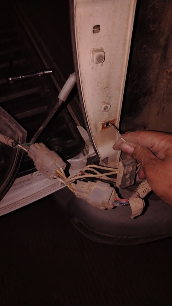

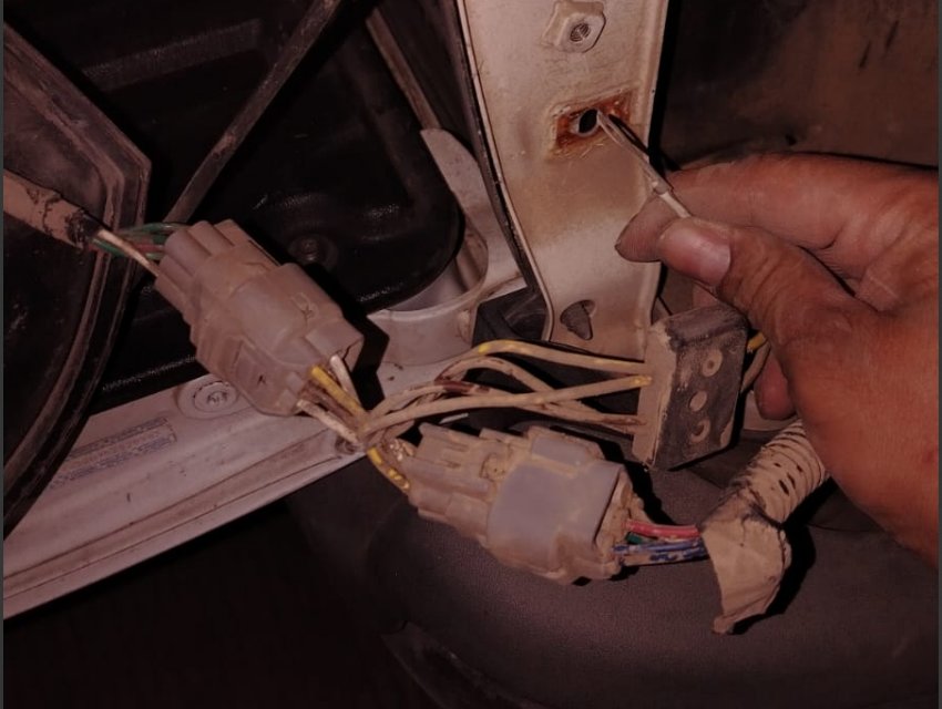

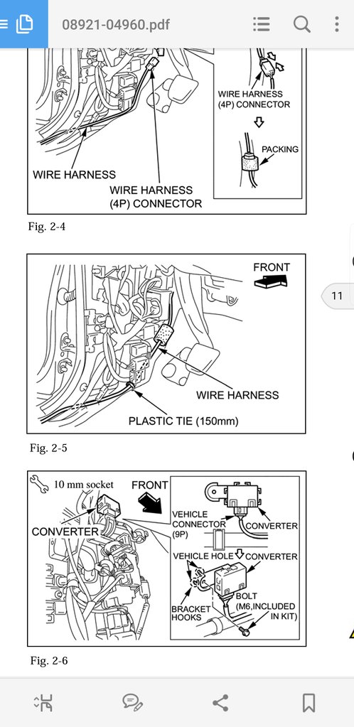

    So took my truck to the dealer and turns out my converter for my trailer 4 pin is bad and the dealer wanted $400 to install an all new factory kit. Just had them disconnect it and will do the install myself sometime in the near future. Took a pic of the culprit from the install PDF (included PDF also). The OEM wiring kit can be had for around $90 + sh from Toyotaparts123 or other Toyota parts dealers. Can't buy converter separately from the kit.

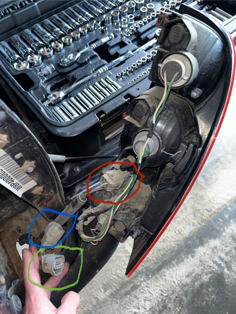

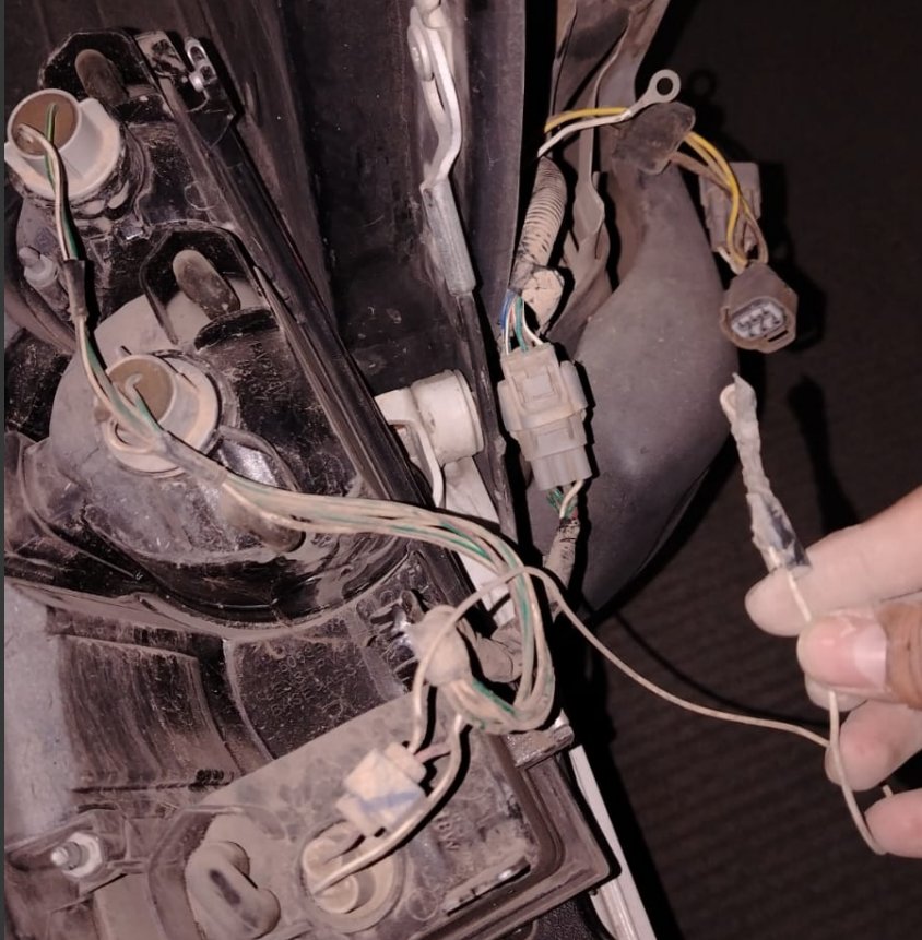

    Mine was only the left side, both front and rear, so I removed the left taillight and disconnected the trailer lights plug and plugged just the taillights in and the problem was solved.
