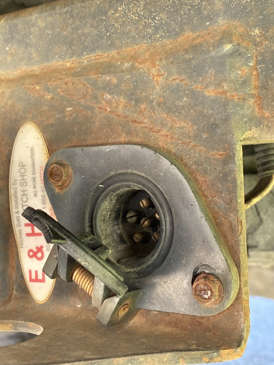

    I do have a trailer plug. Now it was already on the truck when I got it so I don’t know anything about it.
    Appreciate the help. Don’t know anything when it comes to electrical hahaha still learning!

    The 7 pin plugs are not usually as much of a problem but any connection can work loose and cause a open circuit or a short to ground.
