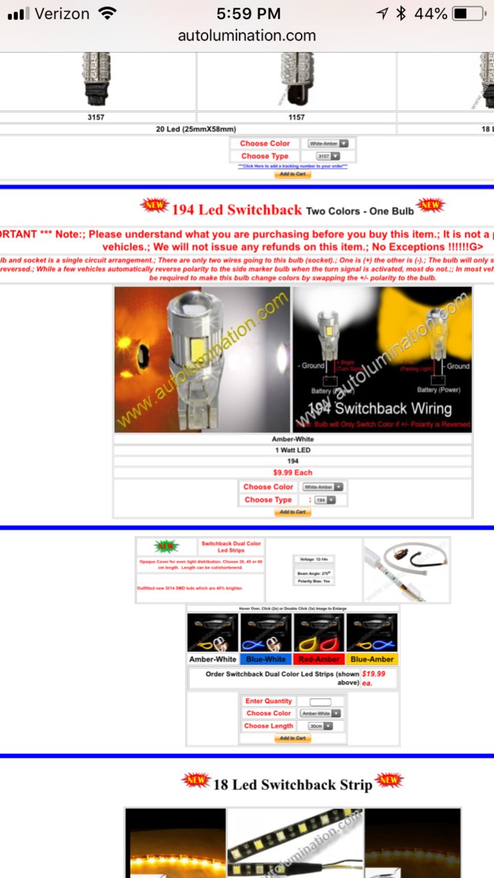

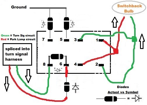

    2004 PreRunner 4x4
    kangs and thanngs
    2xdpdt relays
    4 diodes
    2 bulbs from the picture below
    Some wire
    I’ve also included a wiring diagram for your reference

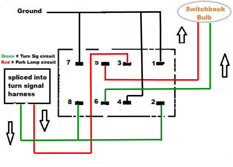

    I'm not sure what relay you used but I suspect that the relay diagram is
    7 (COIL) - 5 (COM1) - 3 (NC1) - 1 (NO1)
    8 (COIL) - 6 (COM2) - 4 (NC2) - 2 (NO2)
    If so, actually the diagram can be simplified by removing all diodes:
    Or the same diagram showing internal guts of the relay
    Anyway, this is quite clever idea. I'm leaning twards installing it. How bright are these switchbacks? What type of relay did you use?
