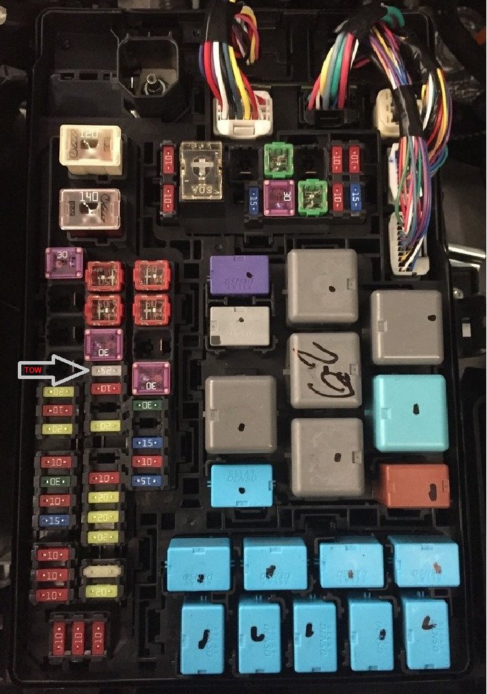

    Seems your turn & hazard module is AFU. It's part of the Combination Meter, soldered & non-removable.:(
    Try this: remove the Tow fuse and the Hazard fuse, see if it still flashes via the stalk and Haz switch. Let use know what you get.
