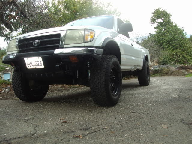

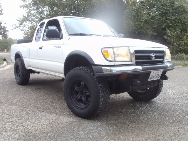

    I trimmed the shit out of my '00 & relocated ugly ass turn signals to the outside bumper brackets at an angle, now cutting out the middle does expose the radiator (not the best look) but more importantly it exposes it to damage because so much of it IS in the open, so I found a piece of steel mesh (or perf panel ) & trimmed it to fit attaching it to the top of the skid plate & bent a 1/2" flange & screwed it into place to the bottom of what was left of the front bumper.. looks ok IMO
