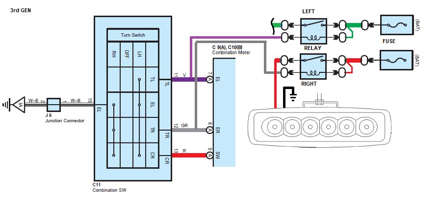

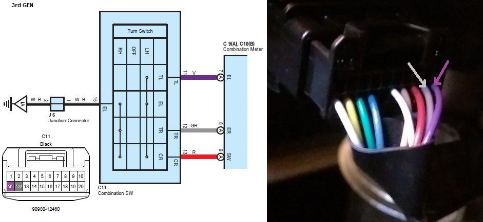

    So is this a legit wiring hack for illuminating a light constantly when the left or right blinker is engaged?

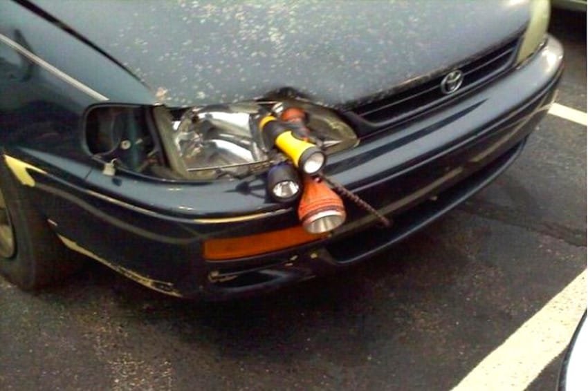

    No.... more like this:
    o0oSHADOWo0o and TacoGreg like this.

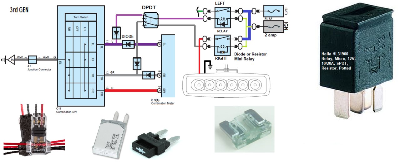

    Rig a relay with some mini led and test it yourself. You might need an switch to disable them when hazards are selected...(maybe)
