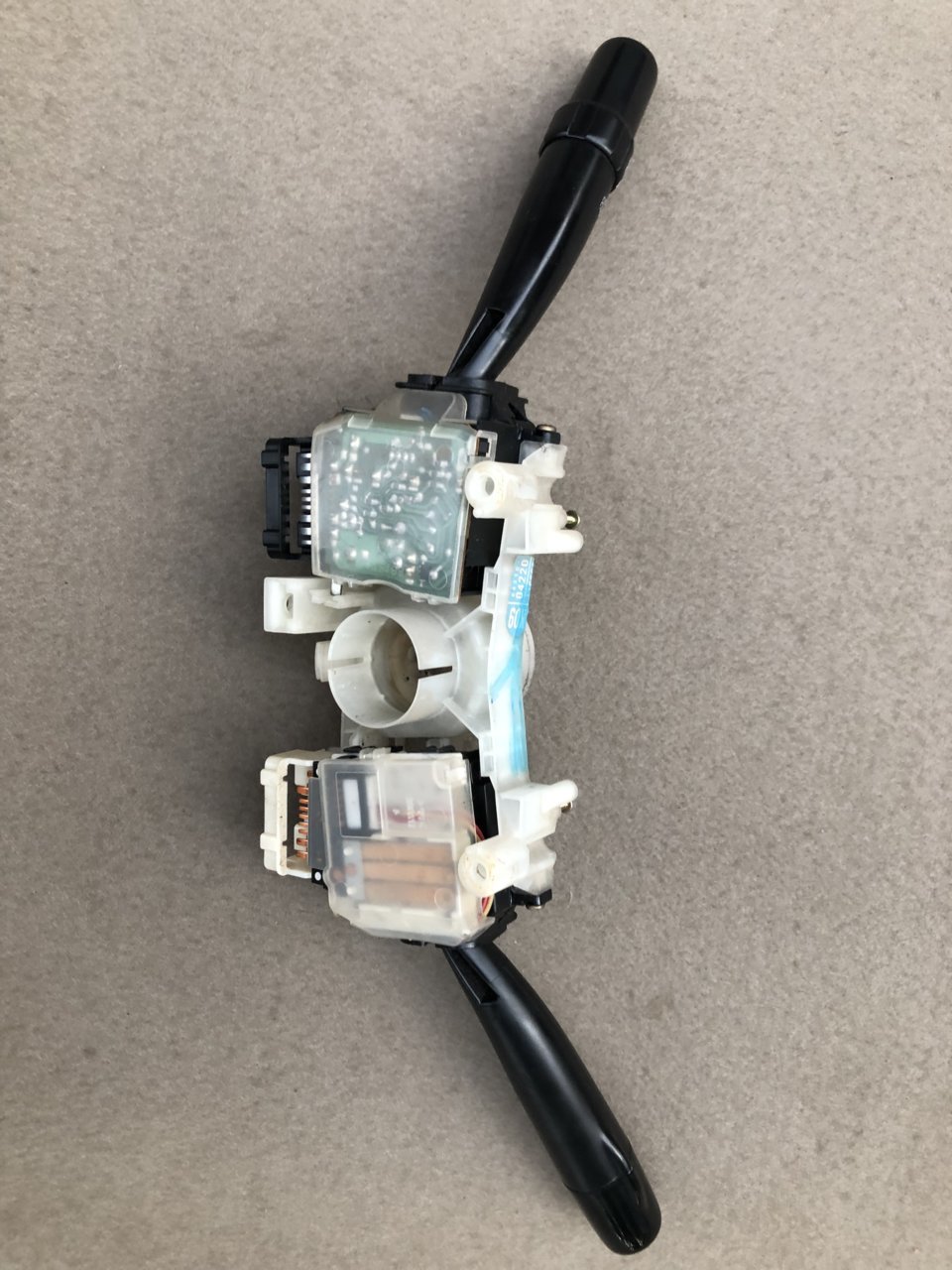

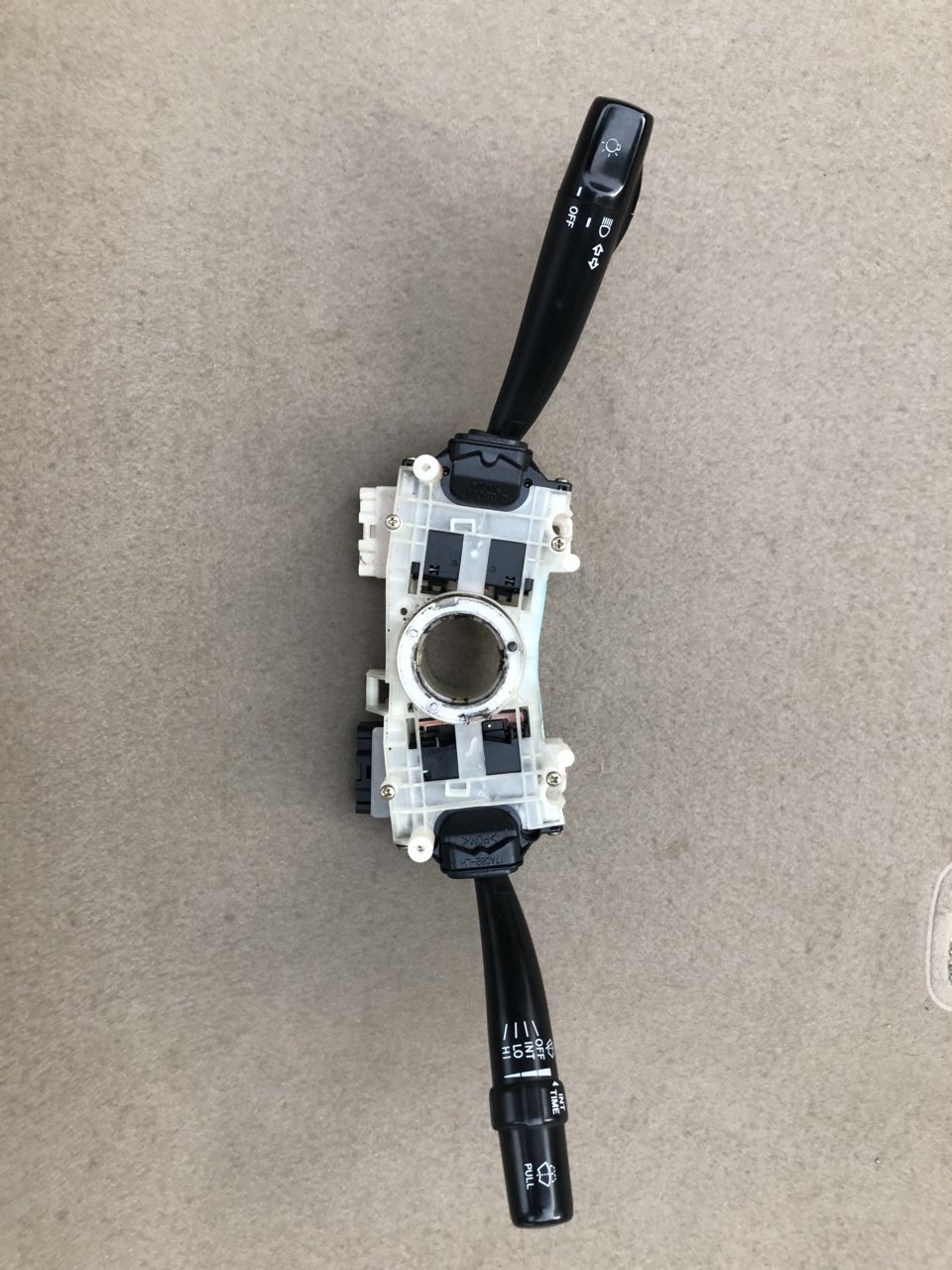

    I do have this if it does turn out to be you have a switch problem.

    Does that fit/work on a 96'?

    AFAIK, yes. Mine is from a 2001 with tilt wheel.

    Pretty sure 95-97 used a different turn signal and wiper setup than the rest of the years
