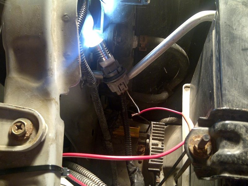

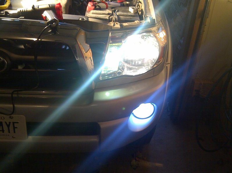

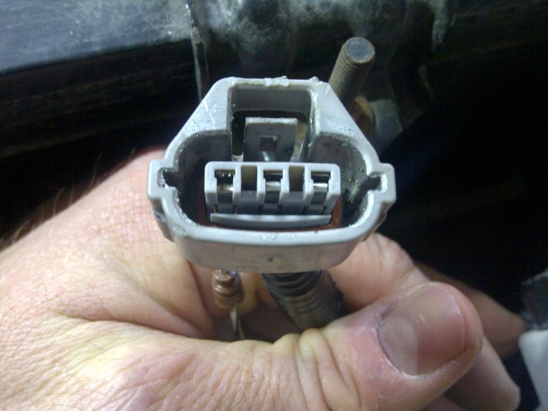

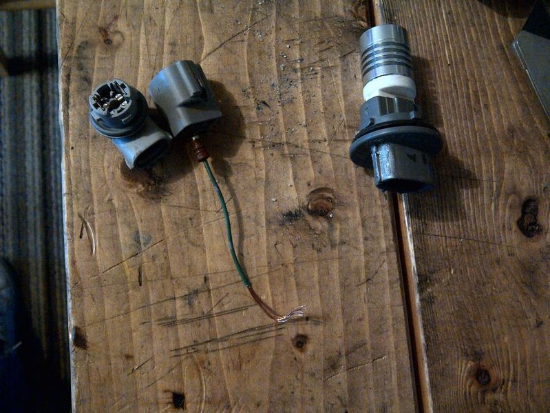

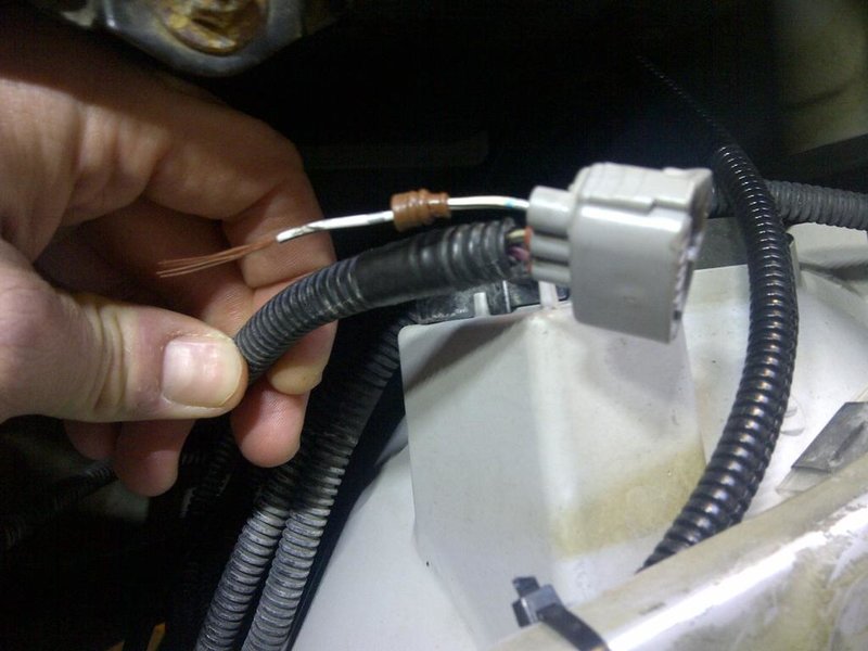

    I bought these a while back and finally got around to playing with the "switchback" function today.... I think i paid around $50, shipped online with the load resistors included.
    I recently re-located my trailer plug into one of my licence plate lights in the bumper. Had no use for the drivers side plate light plug, so i gutted it for the socket connections, then I just inserted them into the blank spots in the turn signal sockets and powered them off the corner markers. I just have to finish it up tomorrow with a switch in the cab to kill the DRL. Worked out pretty good...
