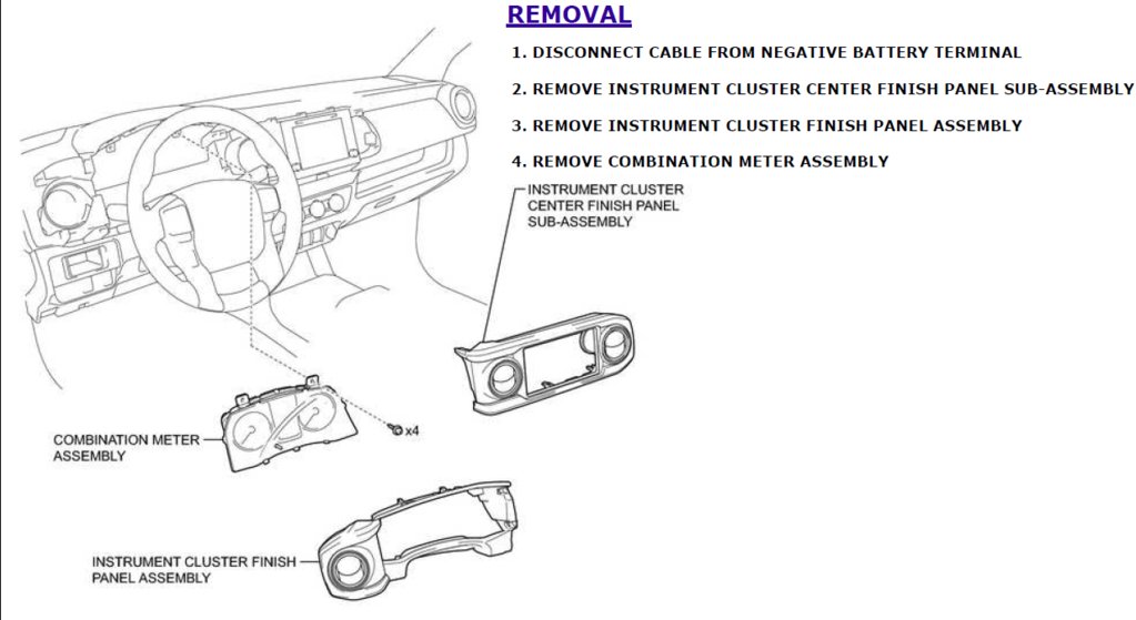

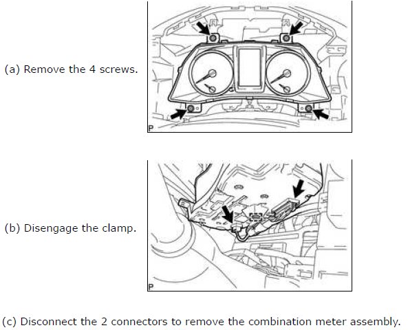

    Remove the cluster: pull out the trim(s), unscrew (x4) disconnect harness (x2).
    Remove the cluster cover on back and take a look.

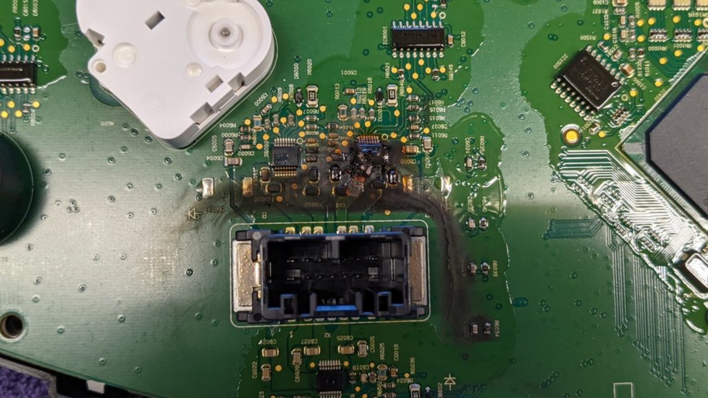

    Maybe you might find something like this:

    Hi! Update: Replacing the gauge cluster fixed the issue. Bought a used cluster off of ebay for $100. Was literally a 5 minute fix following the instructions above. I did not notice any burned contacts or anything on the board upon inspection of the old gauges. Hope this helps! Brian
