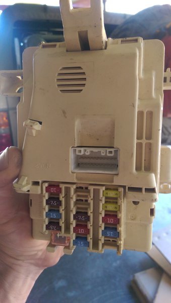

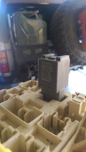

    Where, exactly, was the flasher mounted?

    On a 04 it's on the back of the Body Fuse block.
