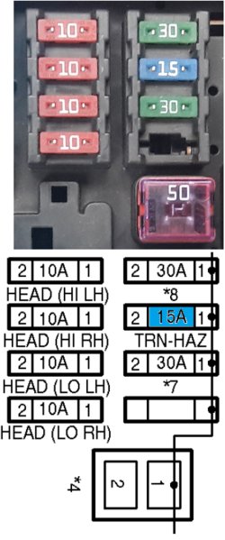

    i just got done installing an LED Daytime Running Light bulb and after I installed it, neither of my turn signals work. No clicking sound or anything. I also noticed that my hazards do not work nor make any noises. Help needed.

    Ya blew the Hazard/turn signal fuse...

    You get a new fuse...but make sure the hazard button and the turn signals are not "ON". I always remove the ground connection to the battery while doing electrical jobs.

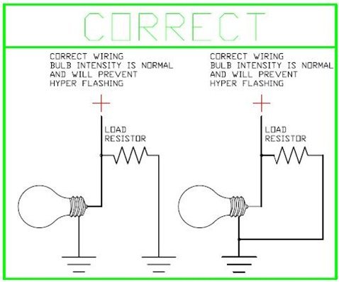

    LED bulbs will not flash or flash very fast because of the different voltage requirements. There are other mods that need to be done to the circuit. I have seen this before with other TW members.

    Yes but blowing the fuse? He needs to add inline resistors. But the fuse blowing would need to be addressed first.

    What headache? Adding an inline resistor isn't a complicated task.
    It's the fuse doing it's job is the concern. What is causing the short.

    I'm thinking lack of power draw from the l.e.d.'s makes the hazard/turn relay pull an inrush amp enough to cause the fuse to "work". So do install the inline resistors since they'll be needed anyway in order to prevent hyperflashing from the new L.E.D.'s

    Isn't that a shunt/parallel resistor with respect to the bulb? It's not limiting current to the bulb.
