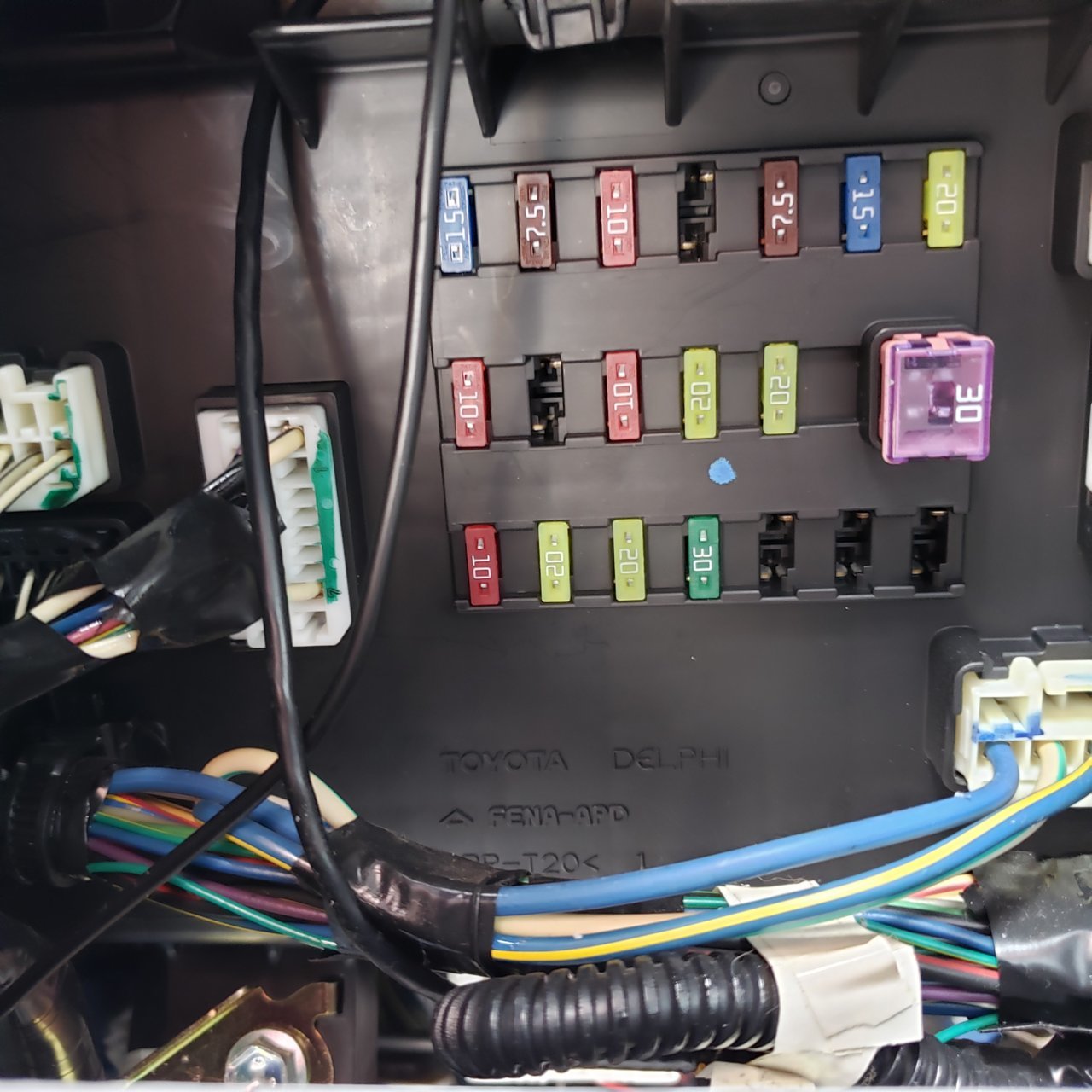

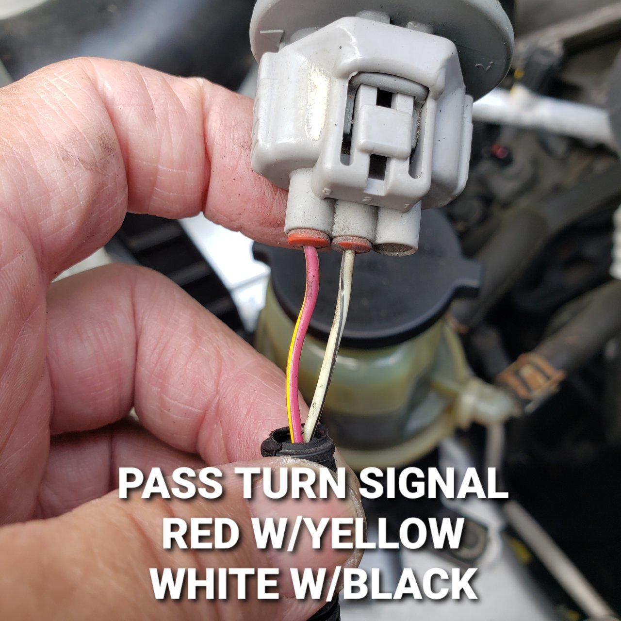

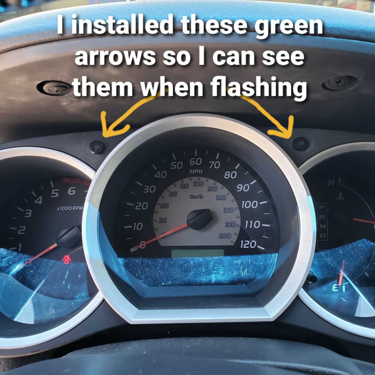

    Greetings Taco lovers! I am a new 2007 Double cab TRD PreRunner. The previous owner cared for this truck 14 years and had 44 service records over the years. It really looks like new 2007.
    So my issue is visibility of the turn signal indicators on the instrument panel when driving. I am an older guy and can't really hear the flasher relay so I didn't want to not notice if my signal was still on. I bought a couple 12 volt green arrow LEDs and installed them at the top of the instrument panel. I am search for the corresponding signal wires in the driver side footwell wire bundIe. I took photos of both turn signal lamp wiring but I can't seem to find the same color wired (red w/blue & red w/yellow).
    I have searched everywhere for wiring diagram without success. I would appreciate and help you can give me.20210510_102900.jpg 20210510_102747.jpg 20210510_102113.jpg

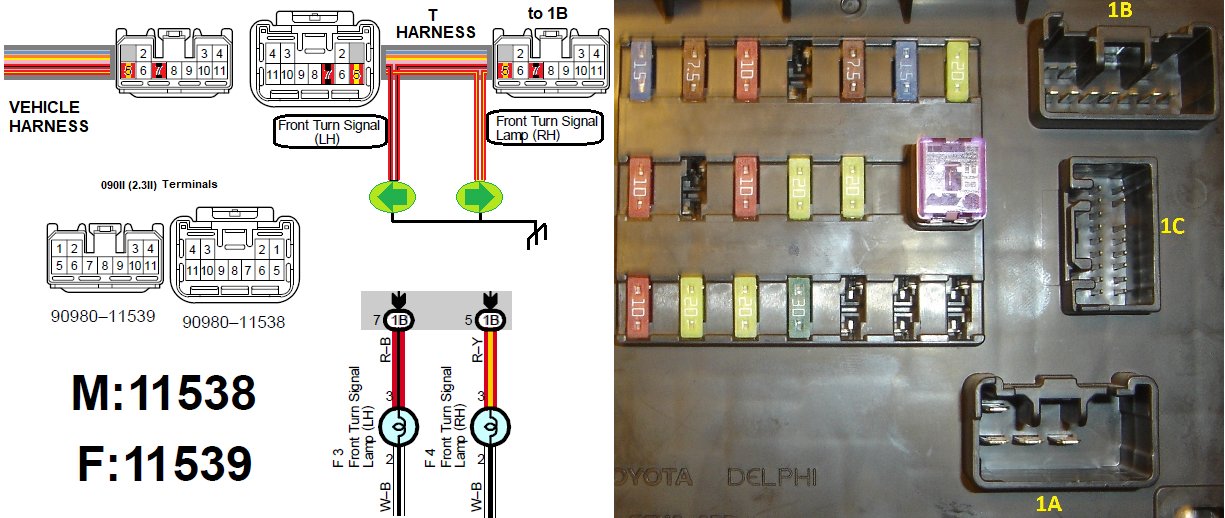

    What you are looking for is here coming from the flasher behind the interior fuse panel: Red with black stripe for Left and Red with yellow stripe for Right. The white with black strip is a ground.

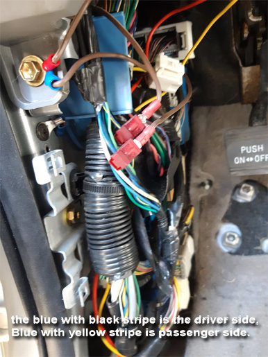

    Shout out to Christian 06 who helped be identify the turn signal wires in the kick panel!

    These is my added turn signal indicator in action.

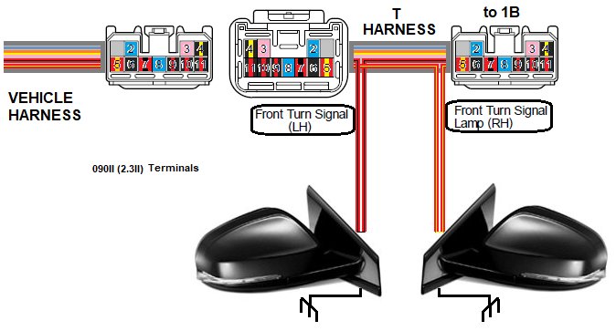

    If you anyone were to need to duplicate it, here's an overbuilt solution...
    Or to add the door mirror signals from a 2011+ (or 2010 4Runner)
