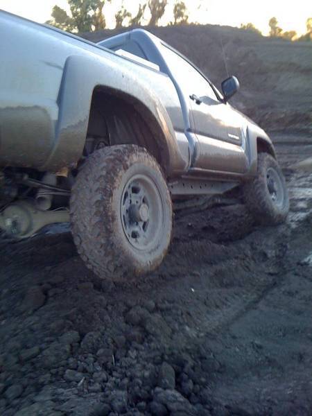

    do it like mine :headbang:

    You know-you could cut the pipe foreward to have the tips exit before the rear tire on one side like nascar:) I guarantee it will stop the vibe too!

    thats what i was considering doing but i have a dual out muffler and like how my dual tips look
