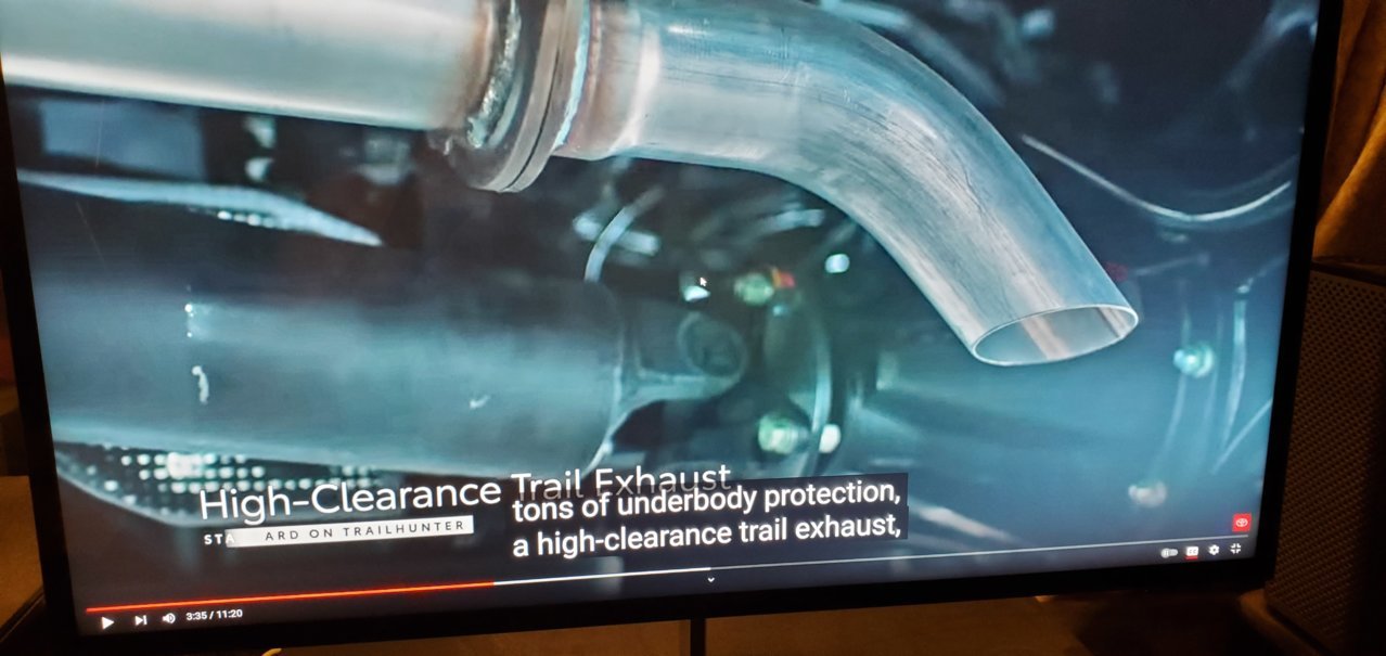

    anybody take note the new Trailhunter will have a turndown exhaust ending before the rear axle housing ... i thought turndown exhausts terminating under a vehicle were illegal ... i guess it depends on the smog tech validation ...

    This is interesting. In PA, per inspection regulations, the exhaust must extend and discharge to the outside body edge of the vehicle, i.e. to the side(s) or rear.

    Might be a good idea to not heat your differential with exhaust.

    carbon monoxide creep into the cab when idling ... can't see it or smell it ... poisonous outcome ...

    I have seen some failures because of before the axle dumps. Find a better way.

    I've got a turn down on my Tacoma. However, it terminates after the axle.
    I believe these new trucks pulled the axle back farther than the 3rd gen. (Wheelbase is 4 inches longer)
    Maybe they are able to skirt around the regulations because the exhaust is ending in the bed area.
