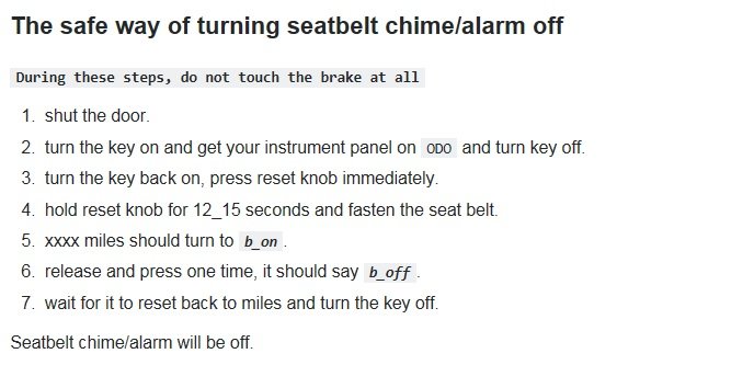

    looks like the last 2 steps got cut off.
