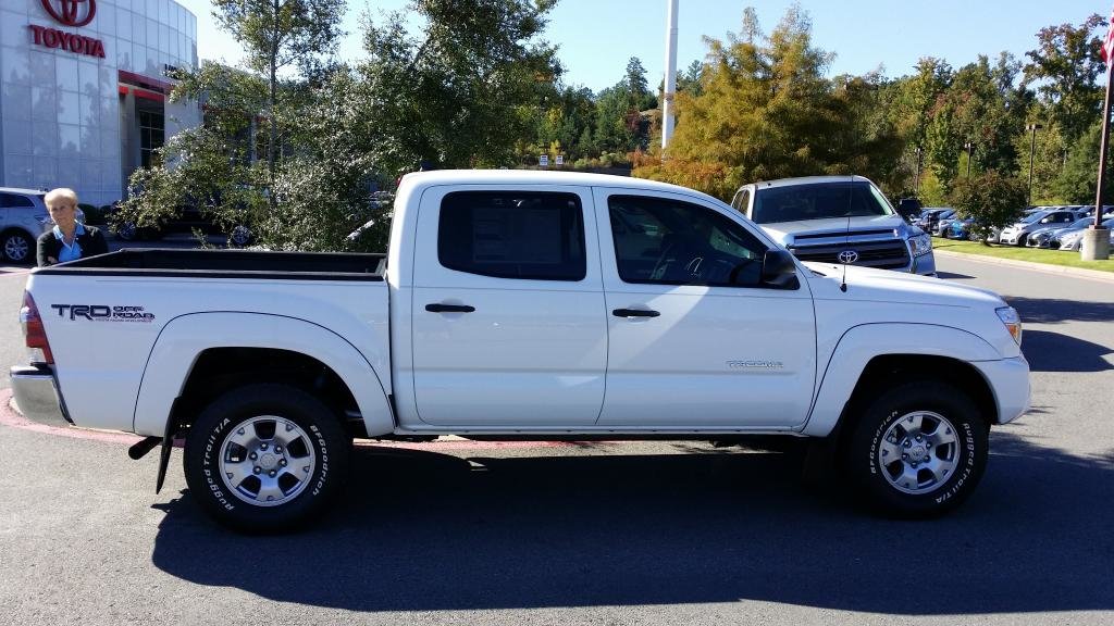

    Truck as it sat on the lot (I don't know who the old woman was gooning at me)

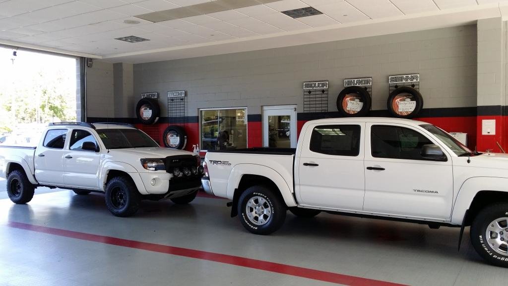

    2011 sitting behind the 2013 getting ready to do the tire and wheel swap. Yes I still have the Factory wheels and tires from the new truck in the attic right now.

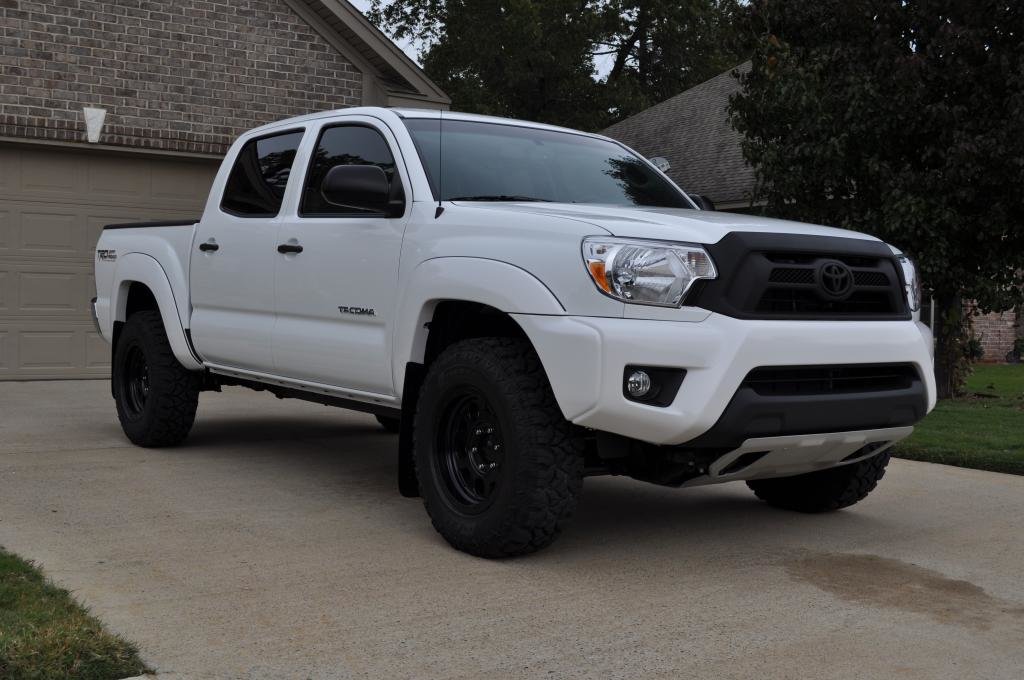

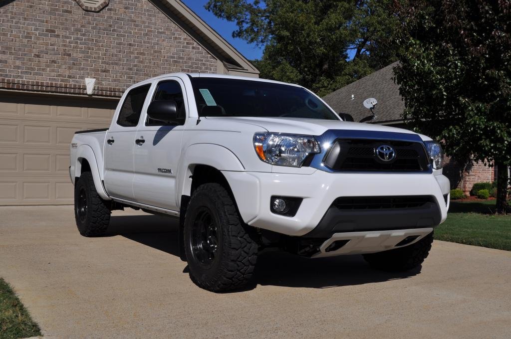

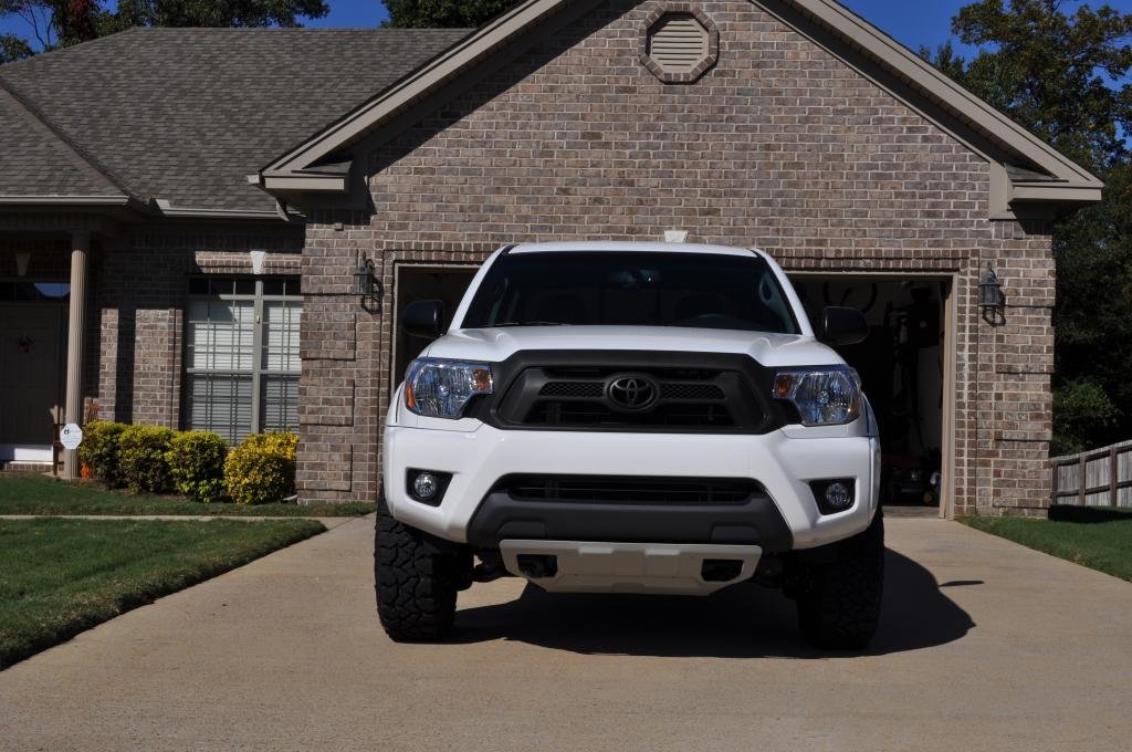

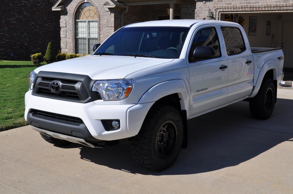

    Sitting in the driveway for the first time

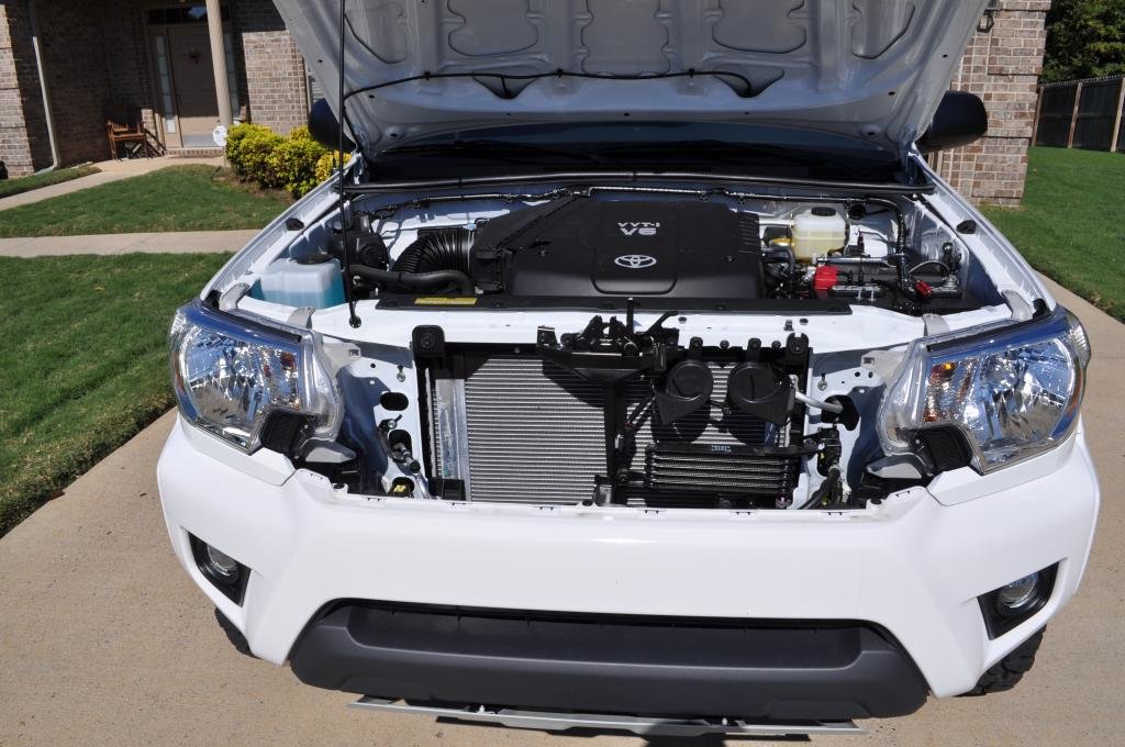

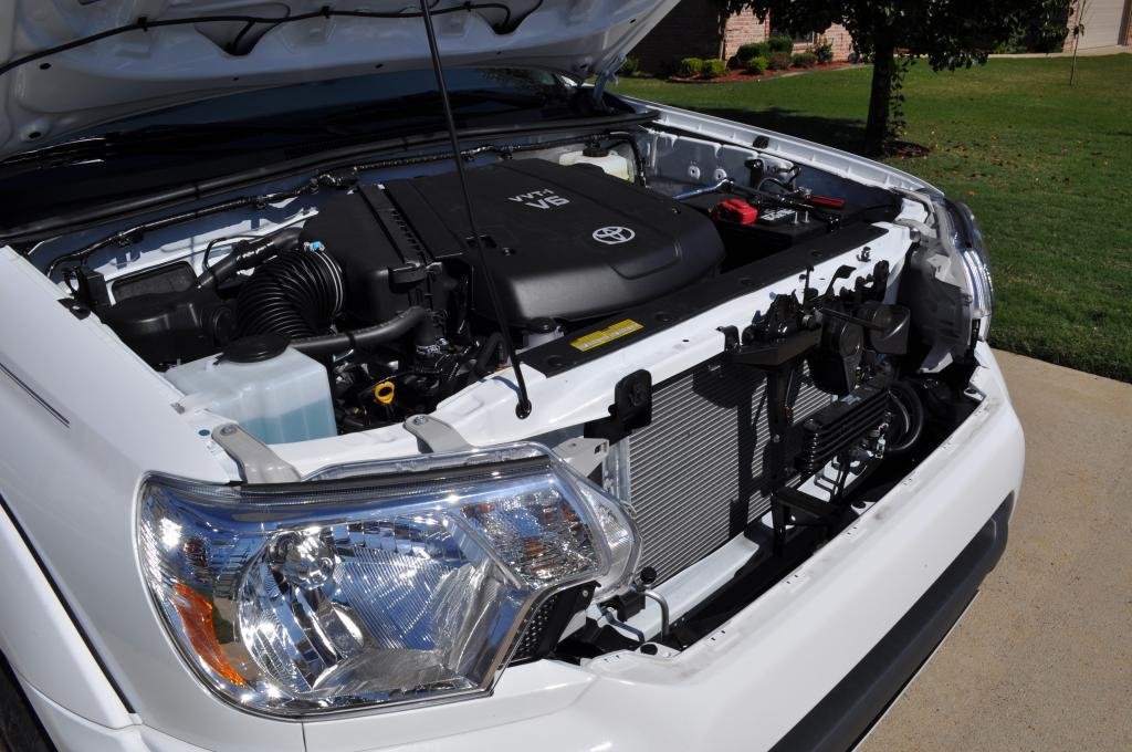

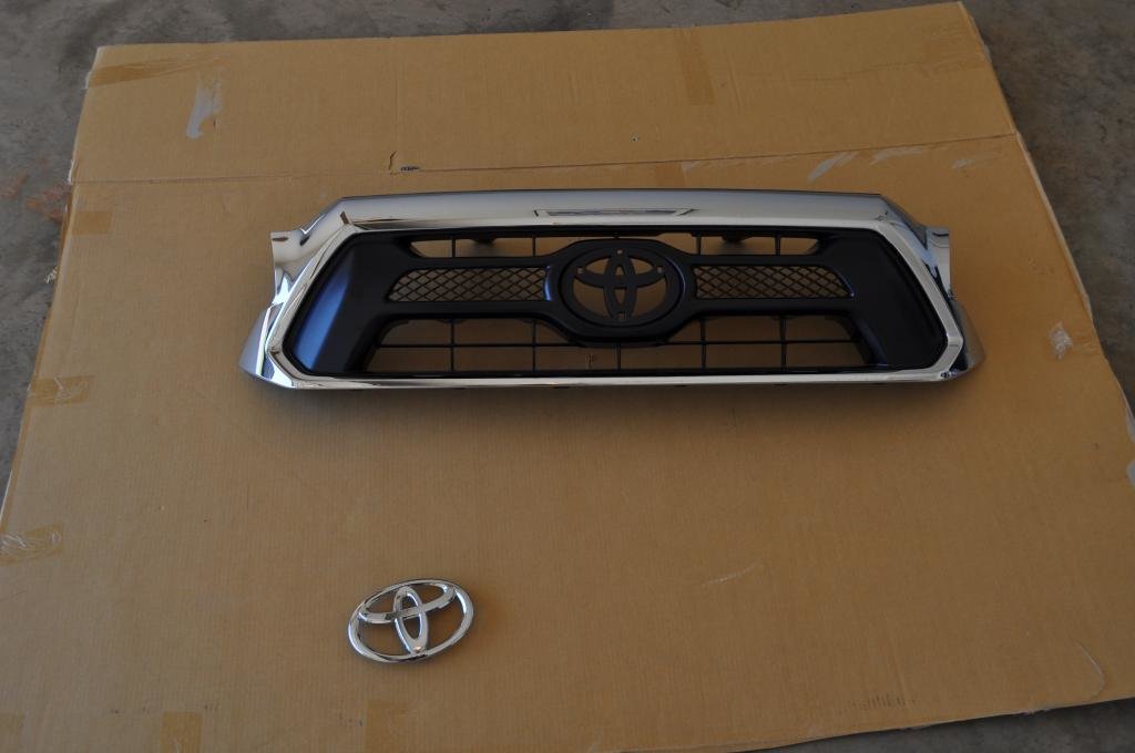

    First Mod... Paint the grill to match the lower valance and get rid of the chrome surround. Removed the grill.
    Taped off the inside of the grill to paint the chrome but ended up painting the entire grill in the end.

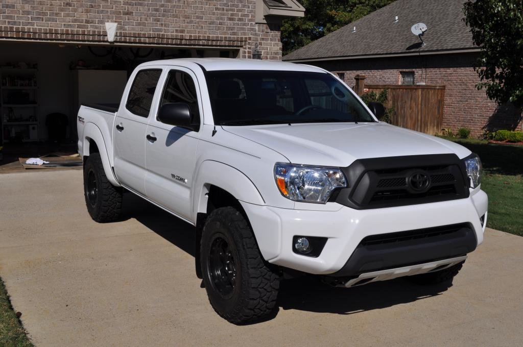

    Grill Back on the truck. Paint matched perfectly!

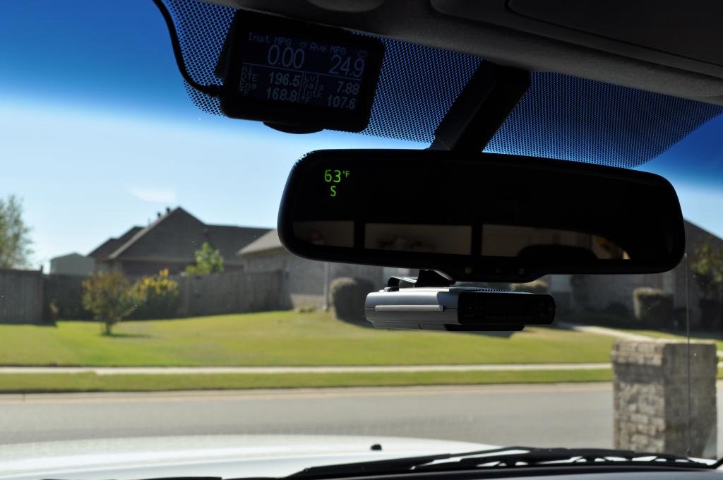

    Mounted the Ultra Gauge and Escort 3 Radar Detector with a BlendMount Rearview Mirror mount.

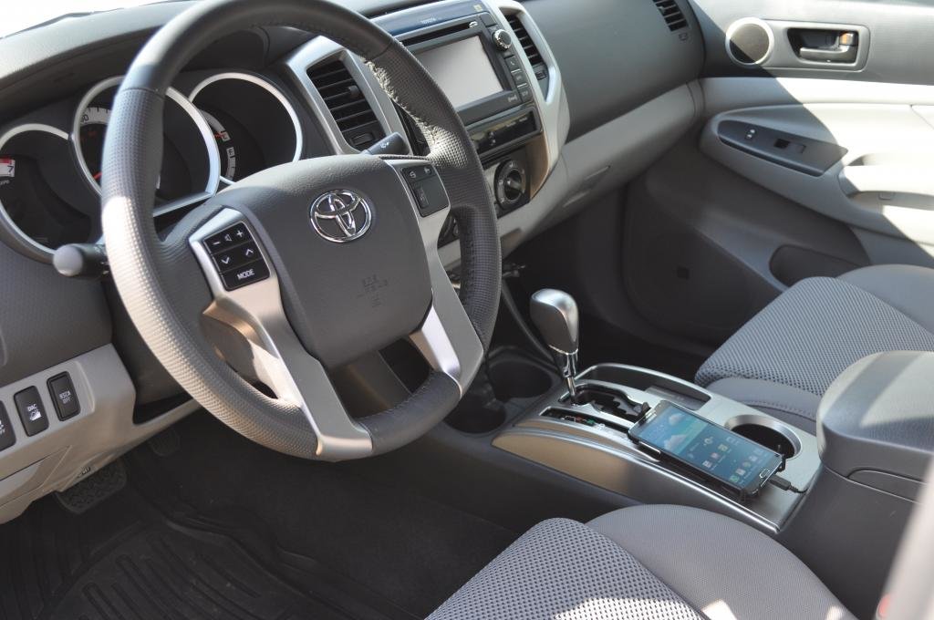

    Galaxy Note 3 Mounted in holder in finger tip reach

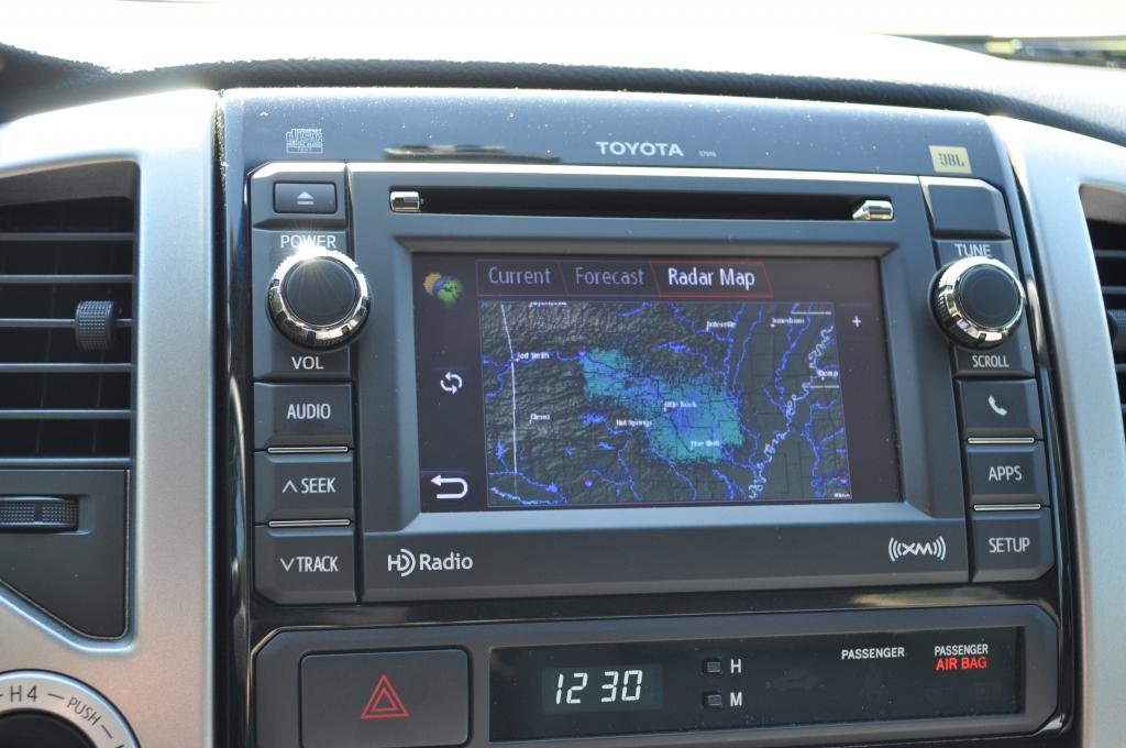

    Entune Weather

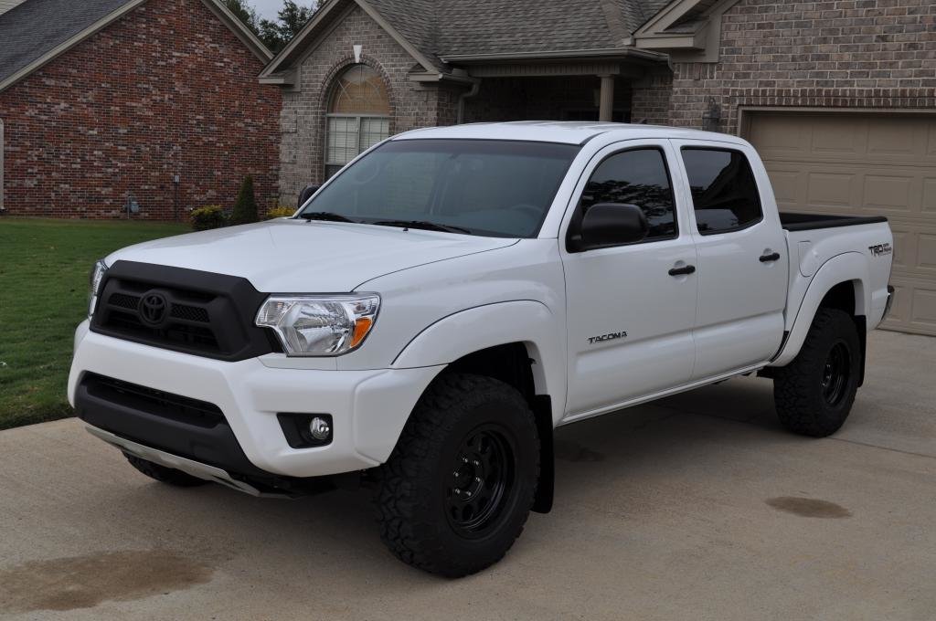

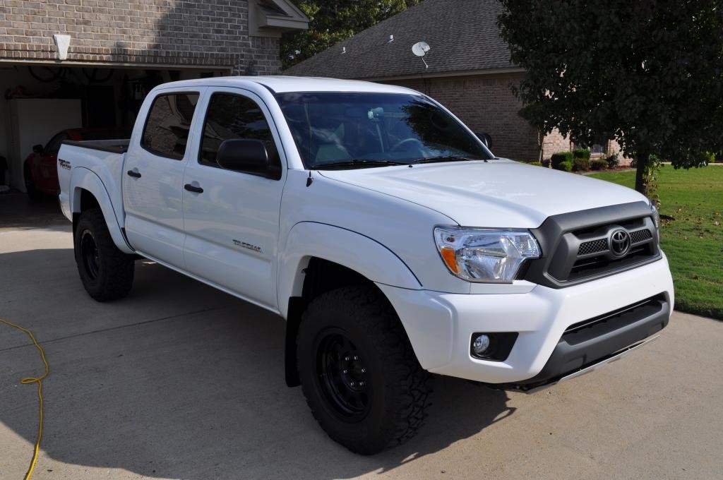

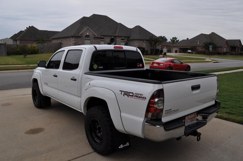

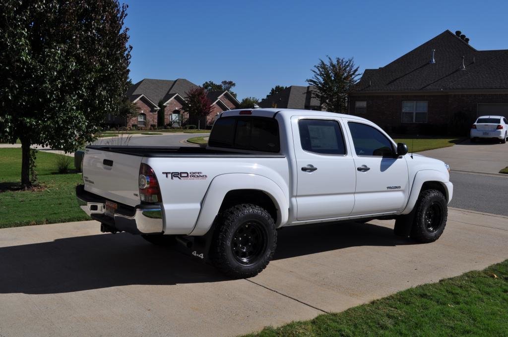

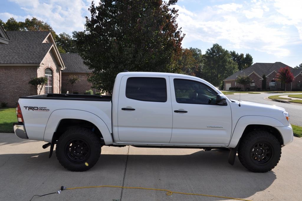

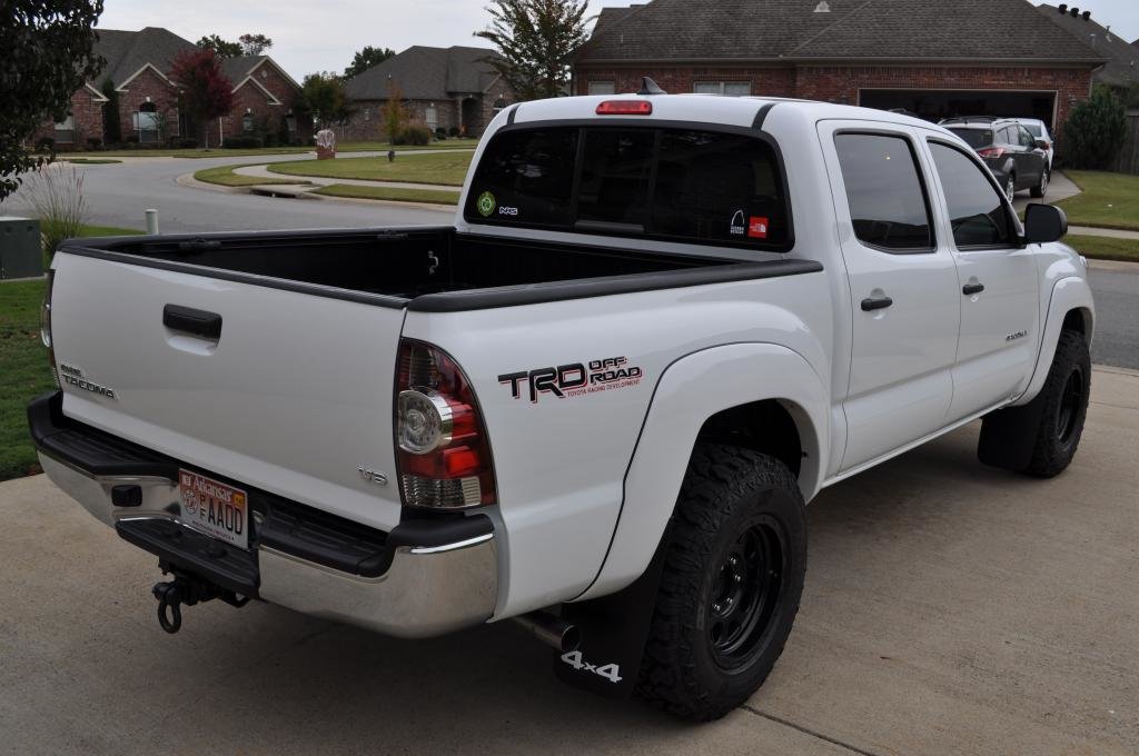

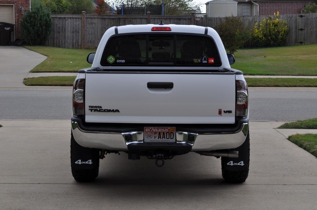

    Few more pictures after a wash and wax right before the rain came.
    Stickers on the back window

    Looks sweet already. You gonna keep the 13 as clean as the 11?

    You know me... yeah it will probably be spotless at 30k miles too although I will probably actually take this one off road to play with the 4x4.

    Where did you get your Ultra Gauge and Escort 3 Radar Detector with a BlendMount Rearview Mirror mount? and what did the set up cost?

    Bought the ultra gauge from ultra gauge.com. if you want it mounted like mine then get the swivel mount. They make a windshield suction mount but I didn't like how it looked. If you mount it where mine is there is just the right amount of cable to run in the headliner and down the a pillar. Ultra gauge cost about $70 iirc.
    I bought the blend mount off Amazon for $80. It is pricey but worth it imo. It is well made and infinitely adjustable.

    In case you wanted your stock picture without Grumpess McCatlady...

    What kind of paint did you use to color match the grille? I have a chrome grille and am looking to do the same thing.

    I actually got it at auto zone. I first sanded the chrome (and then the rest of the grill after I decided to paint the entire thing) and then used self etching primer and sanded that smooth. I used dupli-color flat black stripe paint (like you would use to paint a matte black finish stripe on the hood of a car) and it matched the lower valance perfectly. Used 5 lite coats for the grill.
    If I get a chance I'm going to Derp my emblems tomorrow (I know.. I know..) but I hate chrome.

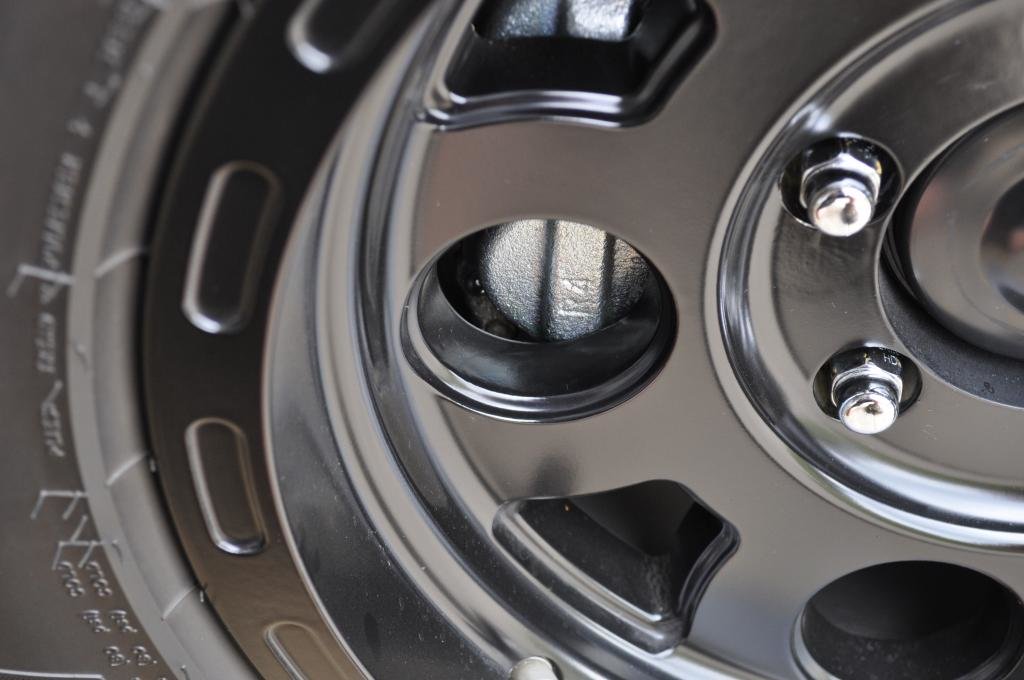

    I didn't realize the KMC Enduros are 16x9. Do you have any rubbing issues? Also, when you have time, could you post a pic of how much the tires stick outside the fenders? I assume your tires are 265/75/16, are you on stock suspension?

    No rubbing issues though they are very close to the caliper. But no issues with them and I've had them for about 12,000 miles. Tires stick out about a inch from the fenders with the offset. Sorry the pictures aren't any better. I'm in the middle of derping my emblems.
