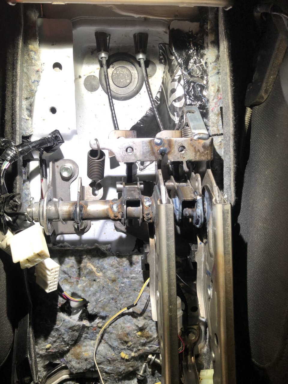

    I don’t have write up, but it’s self explanatory on my picture, get another e-brake, weld them together, split the cables - profit?!?:confused:

    Full disclosure, they barely work as e-brakes, only for trail use. Shoe wear is crazy and they never adjust properly since then.
