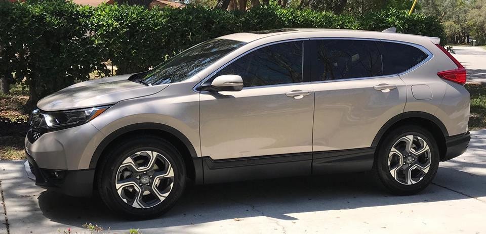

    This did not work for me. After 2 summers I could not take the cow manure stank any longer. Traded mine off in February.
    And Tony from Texas, this was the 1st vehicle I owned that stank. Full blown fresh cow manure stank blowing right in your face. This Honda CR-V the A/C does not go back to recirculate everytime you shut it off like the Tacoma did. Miss driving a truck because I drove one my entire life but now I don't worry about what that bacteria I was breathing was doing to my health. May try another Tacoma in 5 years if I'm not dead yet.

    What'd you trade it for?
  14. Jun 18, 2018 at 7:55 AM
    #74
    CusterFan
    CusterFan Well-Known Member
    Sep 18, 2015
    #164581
    8,936
    Southeastern Illinois
    Silver Sky 2019 Tacoma SR, AC, 4X2, 2.7
    2018 Honda CR-V.

    My wife drives a '16 and she loves it - I feel like I'm driving a golf cart when I drive it but it's reliable, doesn't smell and zips around town like a crossover should! If you don't need a bed and don't go offroad those are good!

    Yeah I really like the 1.5 turbo in this thing, like you said you can zip around town in it. Kind of wished I would of at least test drove a Toyota CHR, I could of got around just fine in one of those also. Would of taken some time to get use to the fugly rear end on them though. I think I could of grown to love it though. I figure if I need a truck I can rent a pick up from U-Haul so the V suits me fine. It is just me that rides in it so I have the back seat folded flat.
